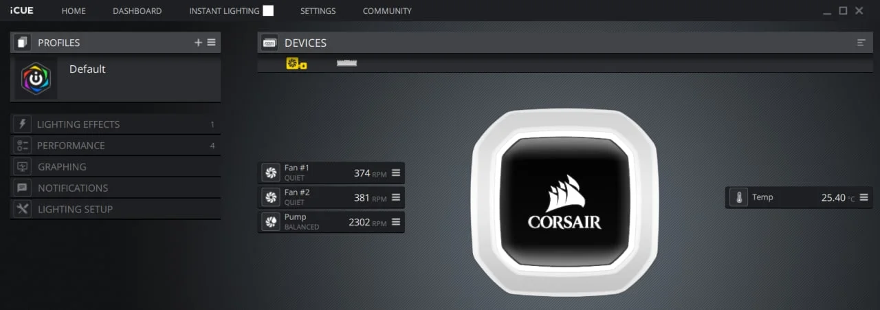

I'm using a new tube of Arctic Silver 5 thermal paste. The radiator is in good condition. I haven't tried giving the pump a shake, but it does seem to operate silently. The monitoring in the Corsair iCUE software reports the pump and fans operating OK.
Even the internal pump temperature seems indicate the fluid is not too high in temp either.

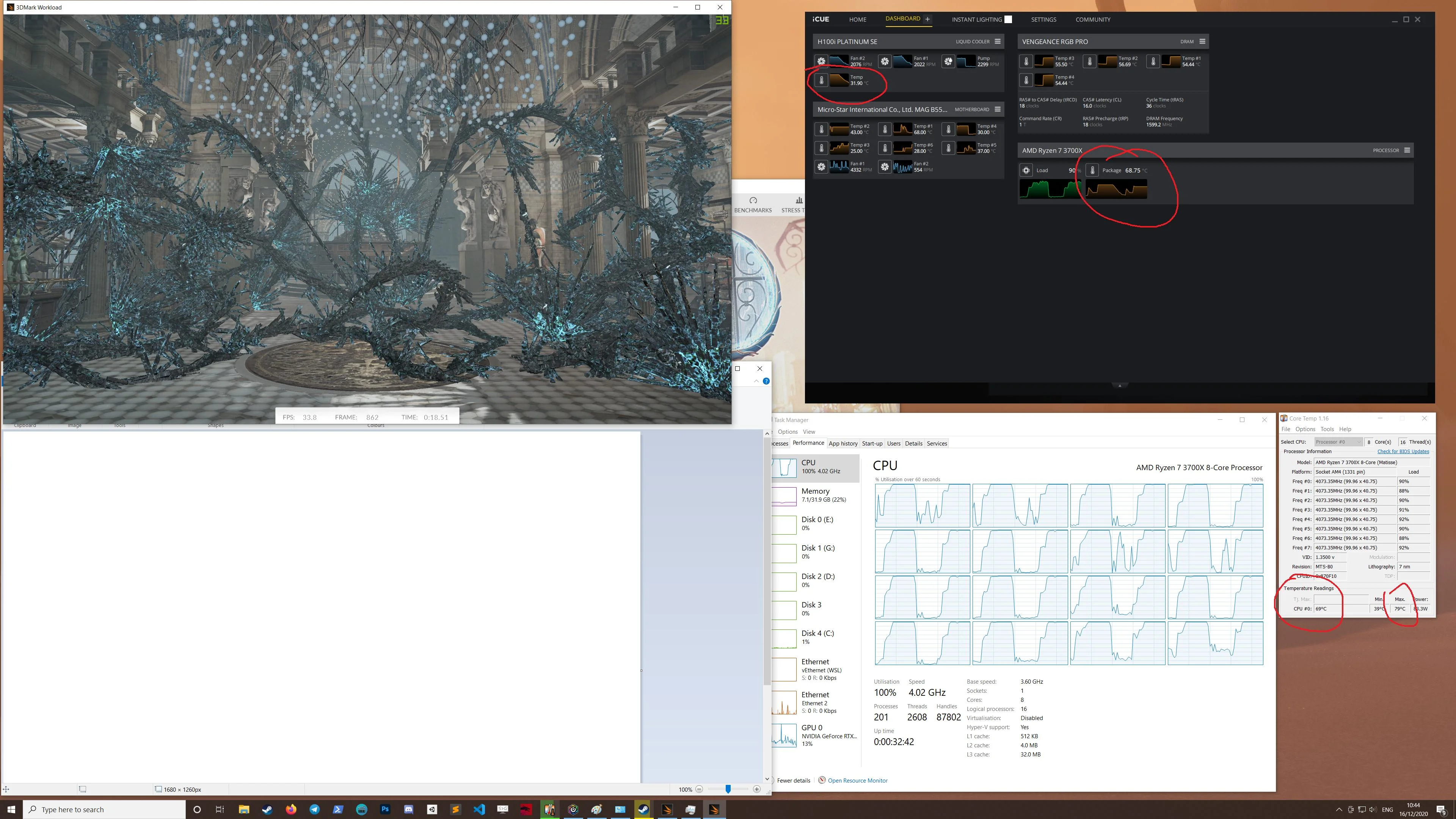

Here is a run I setup this morning with timespy CPU on loop, and various monitoring tools running.
You can see the pump RPM and pump fan RPM is good, and the CPU-Z temps reported at around 70 degrees under load. This is of course the 3700X now which is running stable like this.
With the 5800X the temps reported were around 5-10 degrees higher for the CPU package and it would crash constantly.
So to clarify, below screenshot is 3700X stable. 5800X was in the same system, but reported 10 degrees higher temps.
