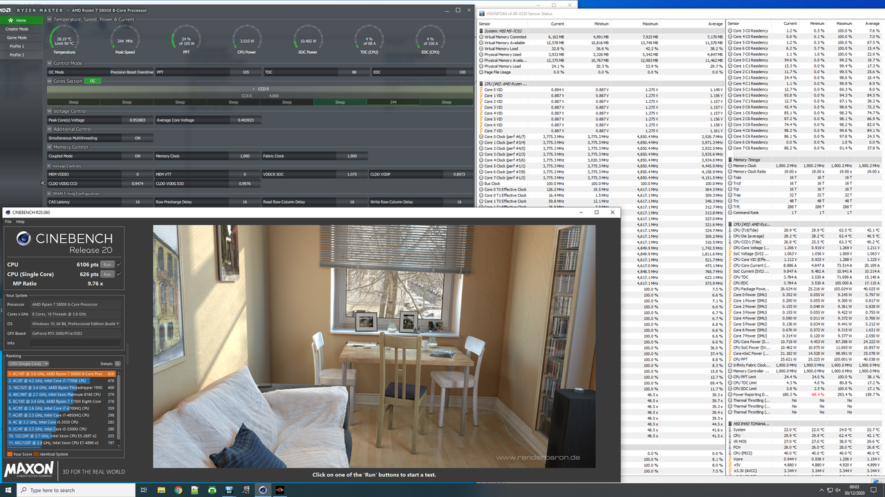

The prism is fine if your prepared to play with the settings, the issue with the 5800X is at stock it pulls the same power as a 5950X which has double the cores, clearly it don't need to use this much power so lowering the PPT TDC and EDC while undervolting with curve optimiser fixes that.
I managed to get max temps down to 62.5c while matching stock performance in cinebench R20 using the wraith prism.
