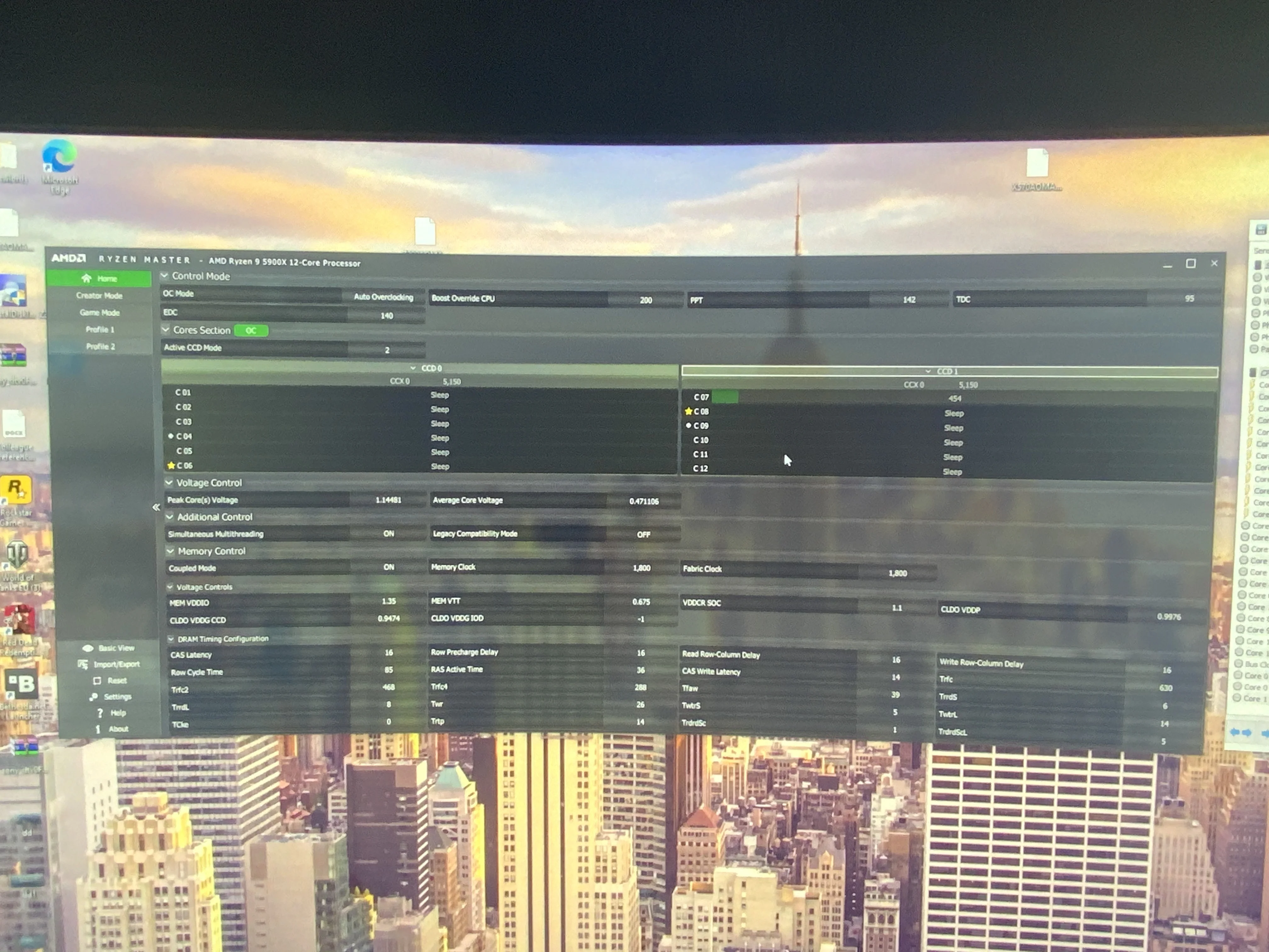

So is the star and the dot the 2 best cores?
Yes, the Stars are your best cores per CCD and the White Dots are the Second best core per CCD, so in your case you want cores 6 and 4... but be aware, that Ryzen Master, it starts counting cores from 1, your Bios may start at 0 like my Aorus Elite in which case you want to start with core 5 and 3 in the bios.
Thanks for that, I did have the wrong cores set, so it’s just a case now of reducing the number until I get some instability, then back off a little and then matchup the rest of the cores until instability is found again ?

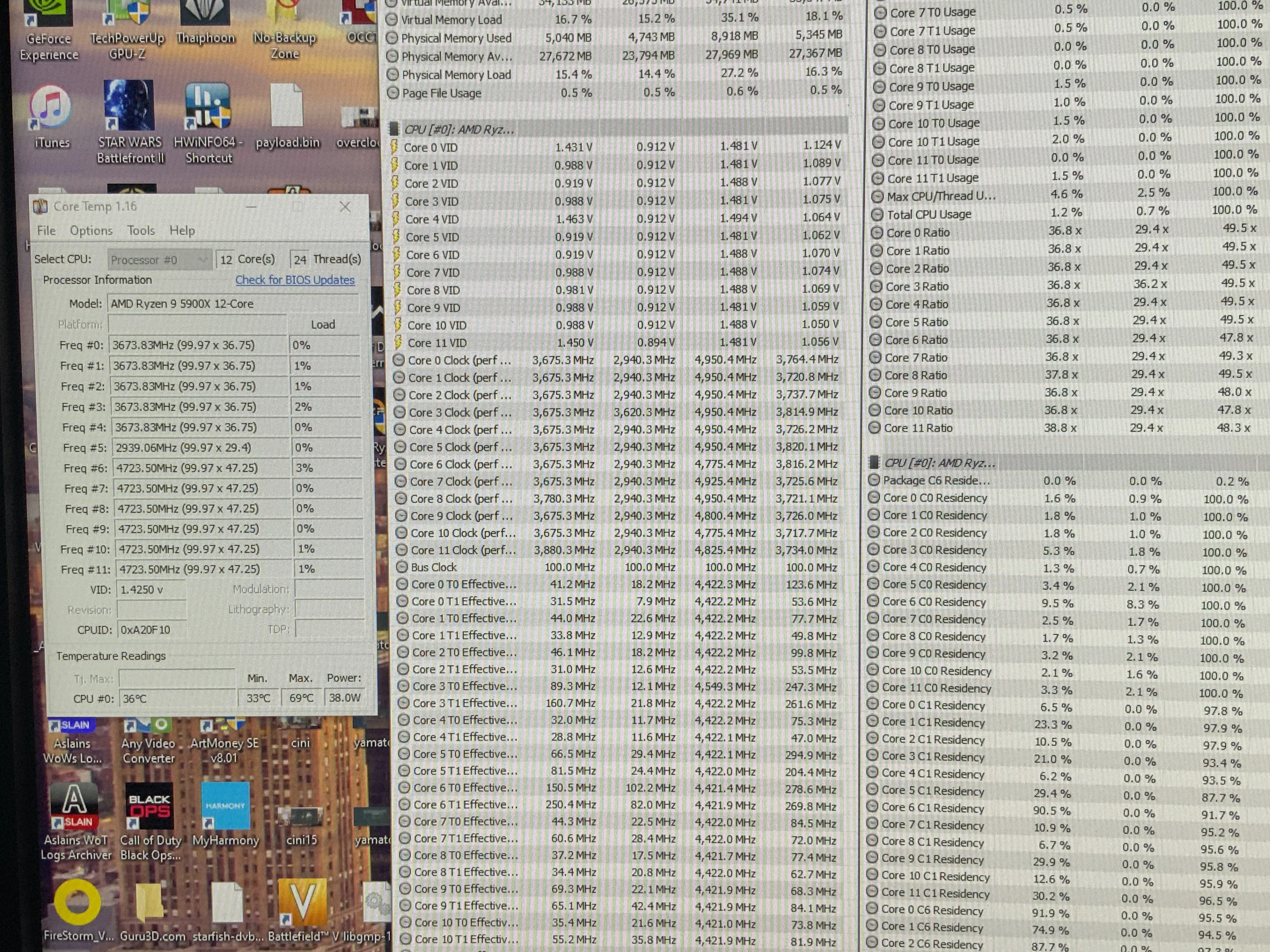

Is using the negative figure correct, I found a new bios so am having a play, core 3 has boosted to 5ghz core 5 is sitting @4.950 but none of the cores on the other die are boosting past 4.6ghz

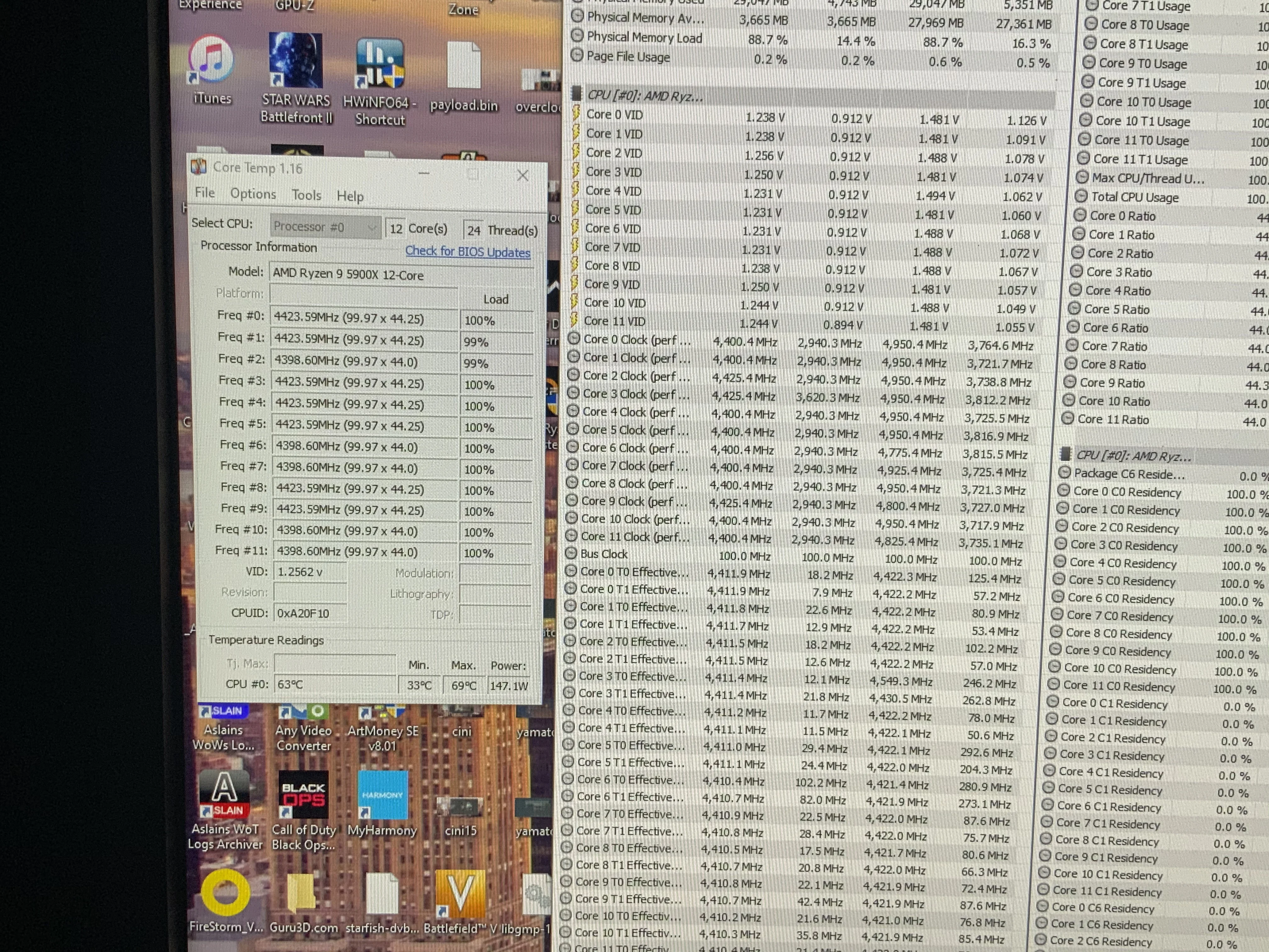

Pretty much thats it yes, set those two and find their sweet spot then you can work on the rest, i think the Gigabyte Bios's are a bit naff at the moment as they are Beta for 5000 series, i cant get anything near what others get on other boards, if i just use the PC and check HWINFO every now and then, i can see 4 cores have hit 5041, but in benchmarks and games the best is typically 4991 or 4941 in single threaded loads. my All core is throttling so cant tell what it would really max at, with the curve settings i get 4461 All core, without the curve settings and just using PBO/Motherboard i can get 4515 All core but .1c lower temps.
As i said earlier, using the Scaler x10 and Auto OC @ 200mhz options dont work on my board with the current F31j bios, so my best 2 cores are at -25 and all the rest are at -22, this gave me the best mix of single and multi core speeds, Ryzen is a balancing act, its hard to get to high single core without impacting multi core and vice versa.

Finally got my cores boosting a bit better, still can’t break the 5ghz mark constantly though, but with all cores loaded with real bench I get 4.4ghz over all cores, also got my 3200c14 memory running at 3800 c16
