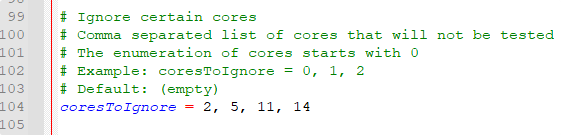

Whatever core the error is on in CoreCycler is the name of the core in the BIOS. So if CoreCycler says, for example, Core 5 has an error, whatever Core 5 is listed at in your BIOS needs to be less of a negative value. You can even drop/add by 1. People just tend to go in increments of 5 to try and speed up the wide-testing net, then if you want you can get down to every last drop.
Say it's not stable at -10, you drop to -5, it seems to be stable, then you try, -6, -7, -8, etc.
Also CoreCyler does each core in 6 minute bursts. It's best to leave running overnight once you find your cores aren't erroring out first or second cycle. Then whatever cores error out, if you open config.ini in the folder of CoreCyler, you can change this part
Notice how I am ignoring 2, 5, 11 and 14? Those are my four best cores. I know they are stable where they are. I was testing -30 on the other cores to see if it would be stable. Speeds things up having CoreCyler not spend 6 minutes each cycle testing the cores I am not tweaking.
You can even ignore every core but the core you have an error on and just hit it non-stop for an hour or so. So for you ignore everything but Core 0 and Core 2 if you want to focus on finding what they will be stable at quicker.

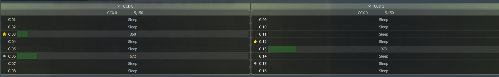

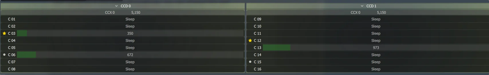

As I said above just make sure whatever your best cores are in Ryzen Master you deduct 1 off the value
See how it says 3, 6, 12 and 15 are my best cores? Well in the BIOS/CoreCyler those are depicted by 2, 5, 11 and 14.
A bit confusing to grasp at first, but it just seems to be the way it is with the BIOS/most apps starting from Core 0 and going to Core 15, whereas Ryzen Master, logically, wants to name them Core 1 to Core 16.
