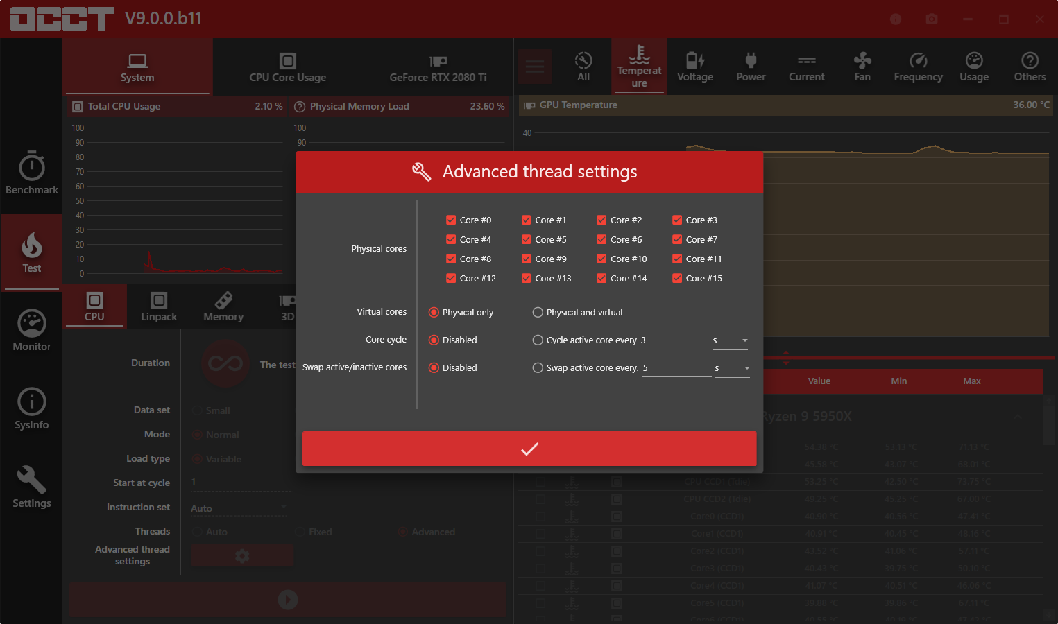

Ok, before you do that, download OCCT (get the latest beta) and do this
Change threads to advanced and on the window that pops up deselect all the physical cores apart from 0 and 2. Then run the stability test.
CoreCyler is basically just a "fancy script" that sets up Prime95 in a way which tests things per core. But it still shouldn't be erroring on cores like that with default settings.
Still, to rule out there being some sort of issue with it, you should run another stability testing app which can do per-core testing.
I have OCCT running currently on all cores just for completness and as its the demo it will only last for an hour, but if it does come across an error i presume it will tell me there and then or does it wait until the test is complete to report any errors?
Will tell you if there is an error. 1 hour should be enough to hit either both cores at once, or 1 each for an hour at a time.

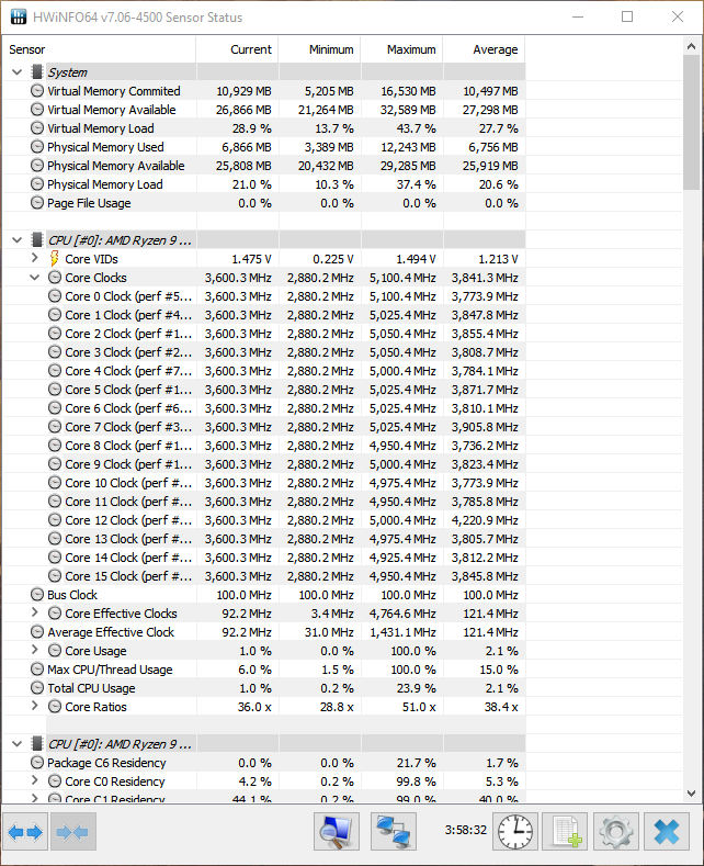

Let us know how you get on. I ran CoreCyler again last night as I was wanting to get as many cores on -30 as possible to see if it could work. I had a drop on one but managed to sort it. So Prime95/the script at least seems to be working for me.
This is my HWINFO after a few hours now
One core managed to touch 5.1, but more importantly most around 5~5.05, or at least over the 4.9 AMD wants to claim the 5950x should be hitting.
Thats with PPT 270, TDC 160 and EDC 190.
Temps are still low 70s during gaming (intensive 3D games), but I'm just going to accept the 5950x runs hot and not stress over anything in the 70s during summer. Some stability testing can go into 80s.
