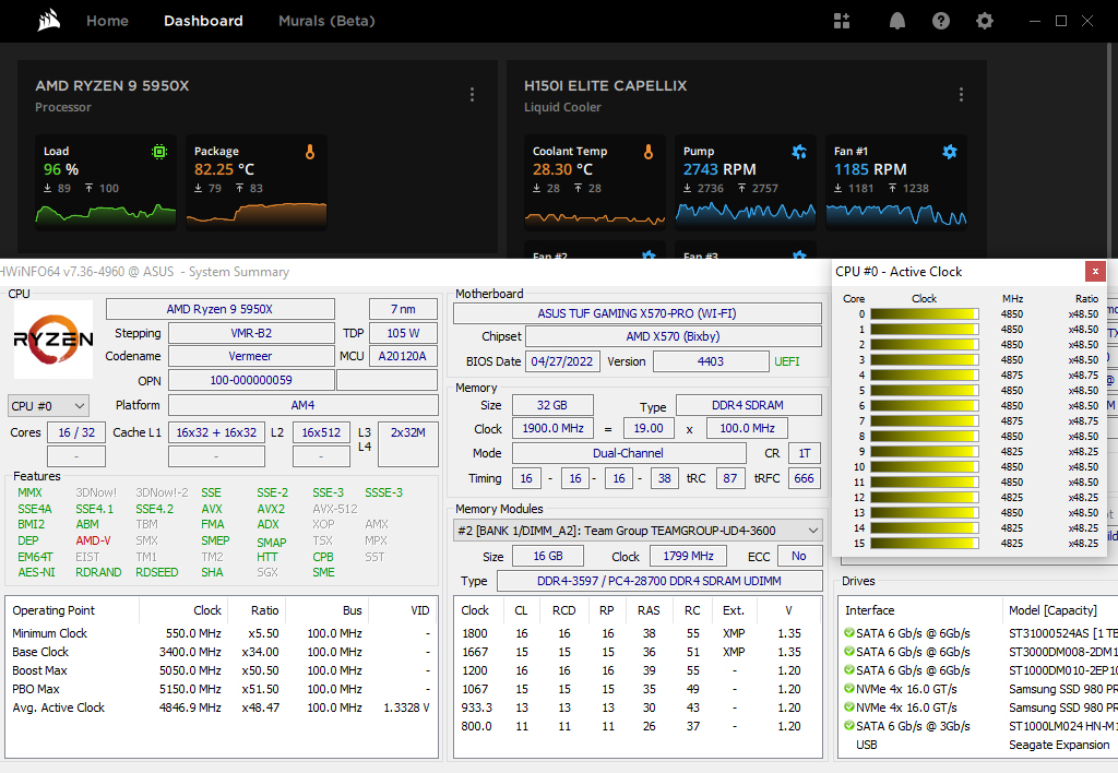

I'm still happy with my 5950X.
I left my tweaking at what I have below running prime 95 on all cores.
