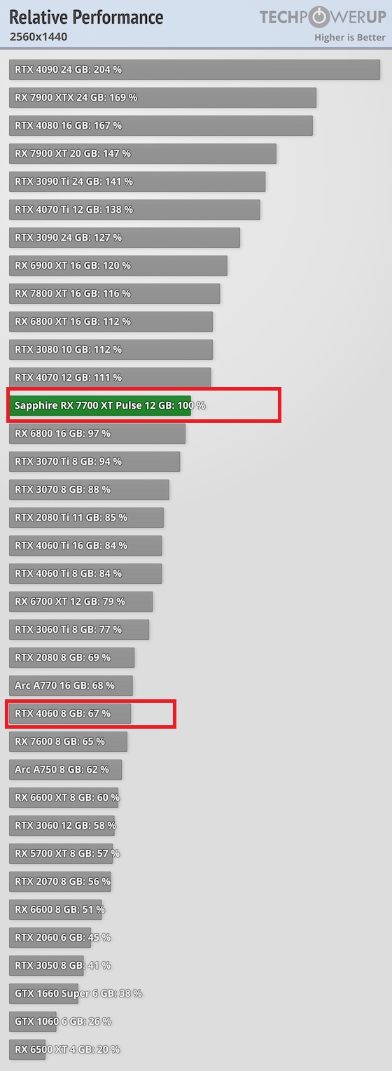

Having said that you should really be considering this, its a much better GPU....
This is a 50% improvement in performance. its 90% a 4070 and £100 cheaper.
I do keep getting tempted by it, but it is nearly £400 and the recommended PSU is 700W. Having to buy a new SFX PSU would just make it super expensive for what it is. Pity that chart doesn't have the 7600 XT on there.
Theres a few B grade 7700xts for sale if you wanted to go that way (and they fit), considering new is £380 I'd hope you could get one for a decent offer price.
I don't see how a 7700XT would require a 700 watt power supply. I'm running a 6950 xt and power draw for the entire system is less than 450 on a bad day. Granted I have reined in the 6950 slightly but is only done due to AMD's excessive clock speed bumps that yield next to no performance for massive power draw (lowered max clockspeed by around 18% for a 4-8% performance penalty and around a 30% reduction in power draw).
They have to assume you have a junk level PSU when recommending them, one of those that gets to its advertised power by including the 3.3v and 5v rails with the 12v only making up 2/3 of that advertised power.
The GPU is 230 watts, its not going to be any more than that, my 7800 XT pulls 250, paired with a 65 watt CPU, like the Ryzen 5600 i think it'll be fine on a 450 watt PSU, obviously just be sure it fits in your case, the Sapphire one i linked is not large but its not like tiny either, i have the 7800 XT version of it, its a good GPU.
It is a bit slower than a 6700 XT, but it pulls similar power numbers too.
