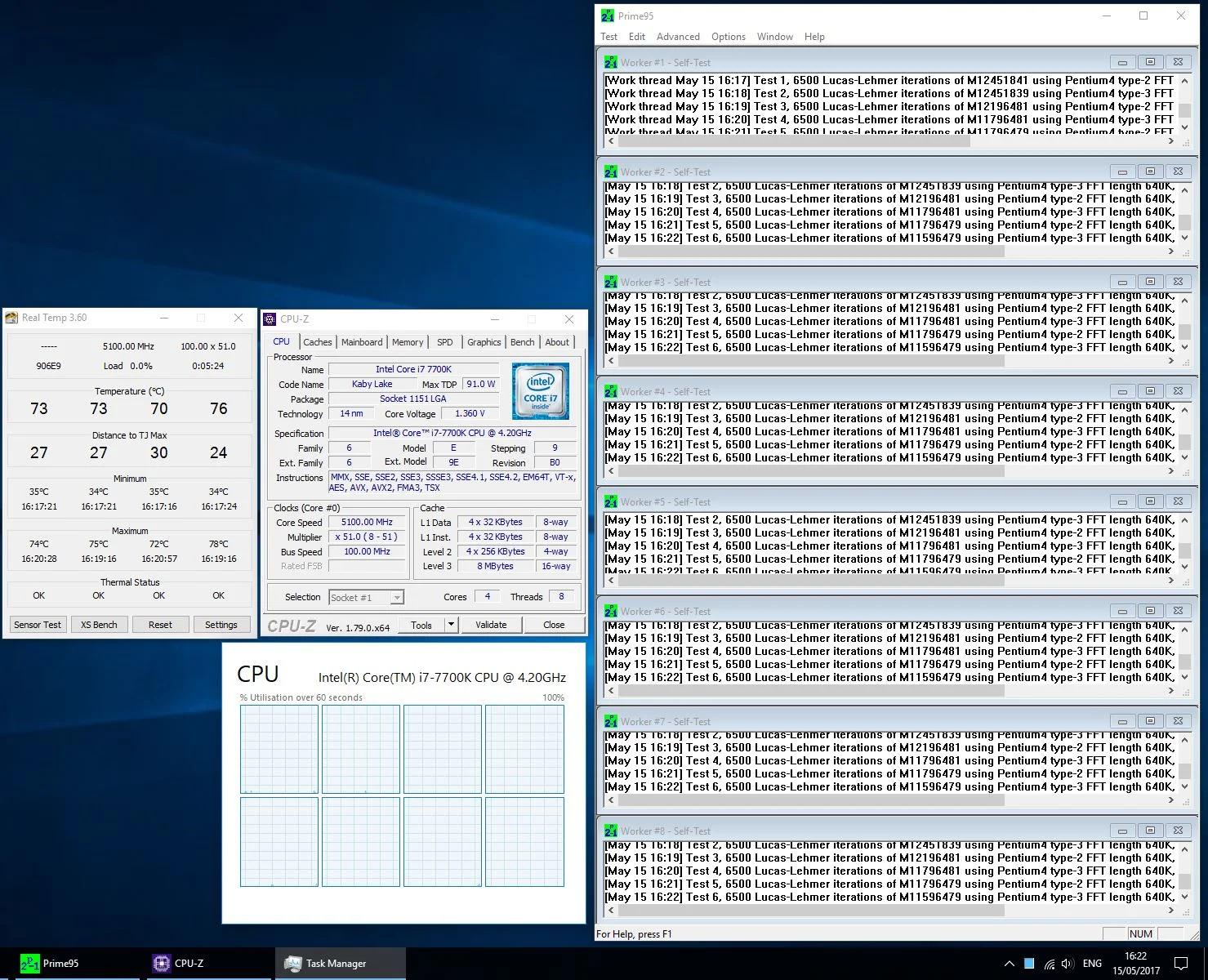

I am just running the 7700k through its paces now.
The first pass of testing shows a huge voltage increase needed for 5.2GHZ with 3600MHZ RAM XTU/CB15 bench stable - 1.41v
5.1GHZ with 3600MHZ needs just 1.32v vcore with no other voltage tweaks. At 5.1GHZ max coretemp temp is 69C (XTU bench) with fans on quiet. This is on the smaller AIO - the Corsair V100i v2.

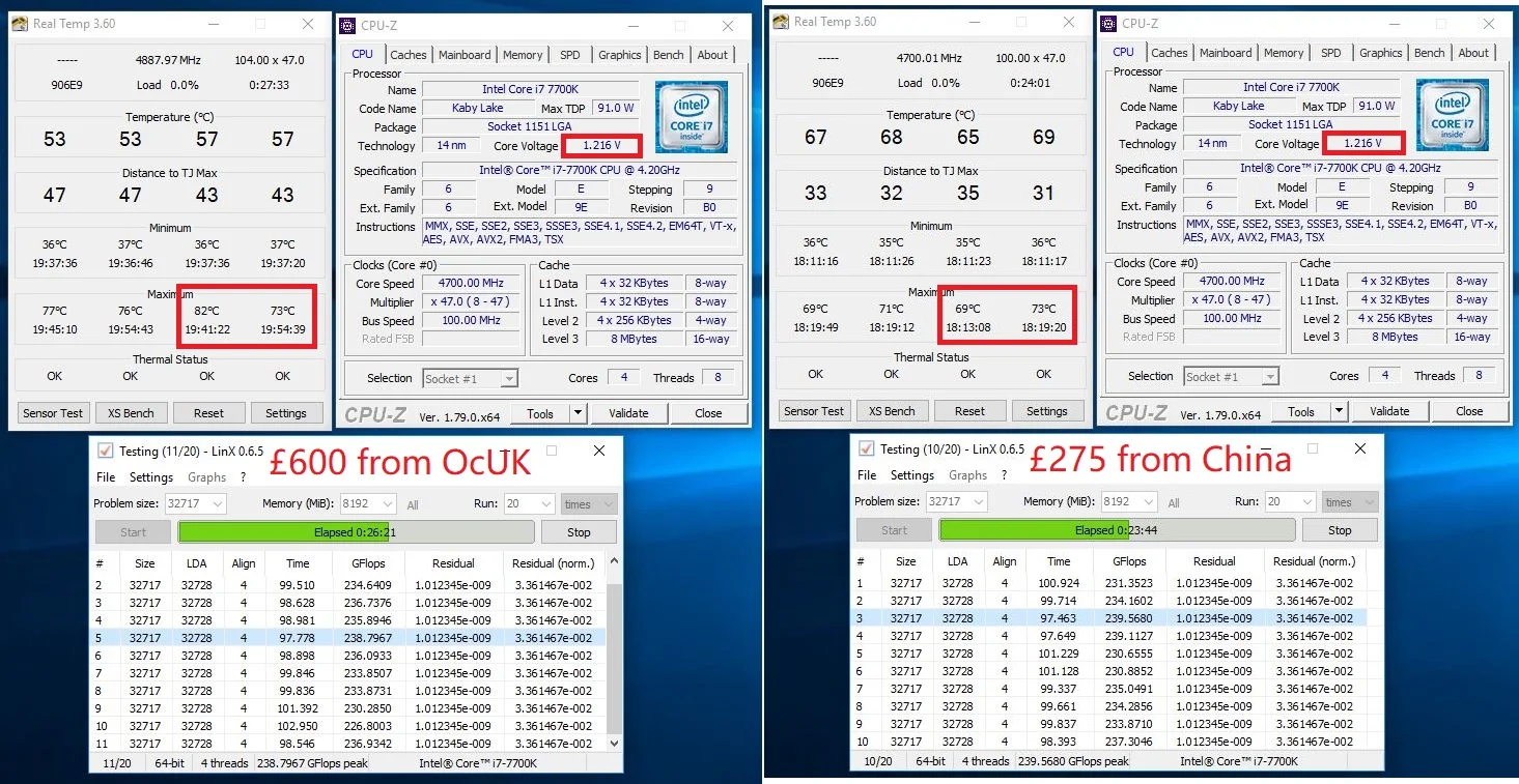

Nope. I just got another 5.1GHz binned 7700k from China. With exactly the same cooler, MB and settings, I get significantly better temperatures. This is hard evidence that the sample previously returned twice by others is definitely poorly lidded. I don't blame 8 Pack here, but I believe the one who applied the liquid metal and re-lidded the CPU had no care about the customers.

Waste money? not everyone needs to OC it to the specified bin. I get binned CPUs because I want to run them cooler at lower clocks. I just prove that the sample I purchased from OcUK needed further quality control. There's nothing wrong with my cooler or my motherboard (and my motherboard is £40 more expensive than yours).
Screenshot of the new CPU:
