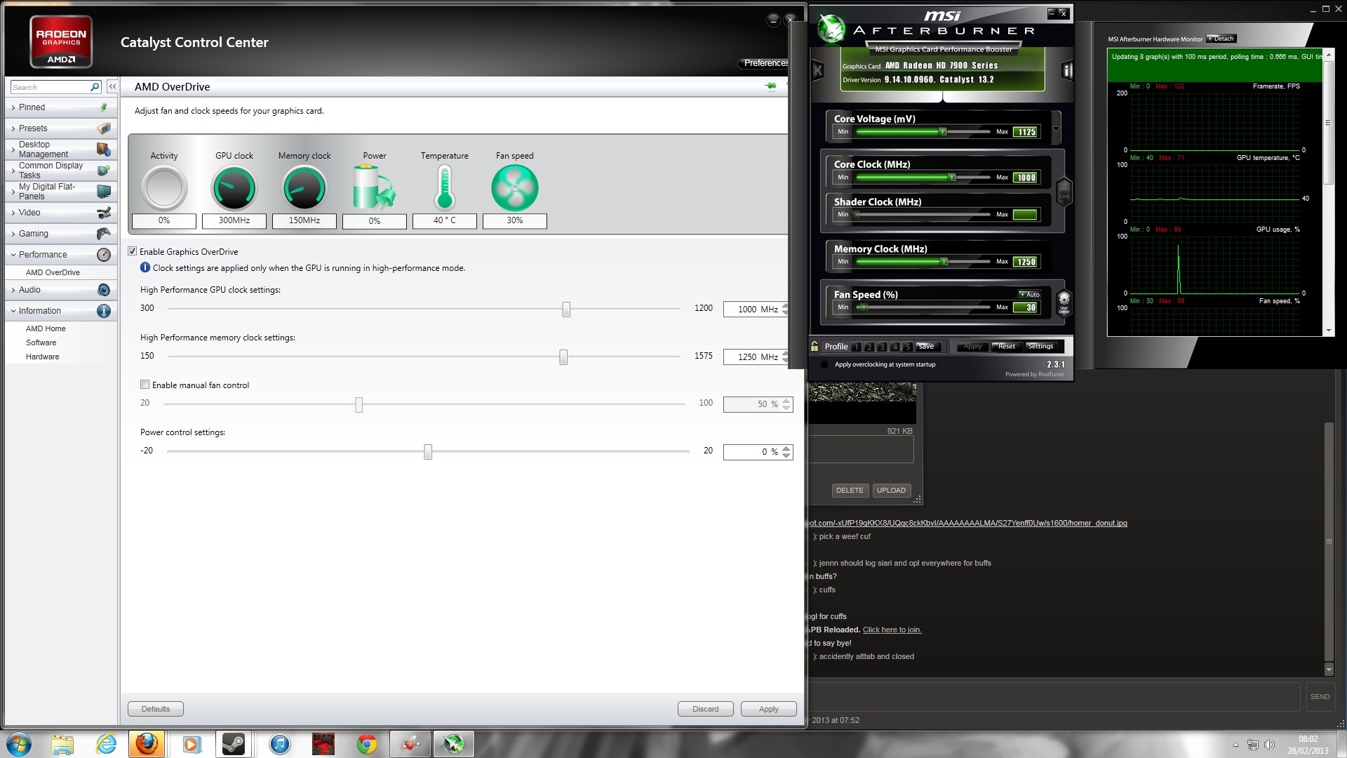

Core Voltage (mV) 1125
Core Clock (MHz) 1000
Memory Clock (MHz) 1250
Launched Skyrim with Hi res mod got me 2300mb usage and fan 99% but problem is on desktop i had some twitching several times with a 1cm height across the screen. Is it faulty?
I don't know since I don't know much about graphic card :( I posted screenshot if that helps
