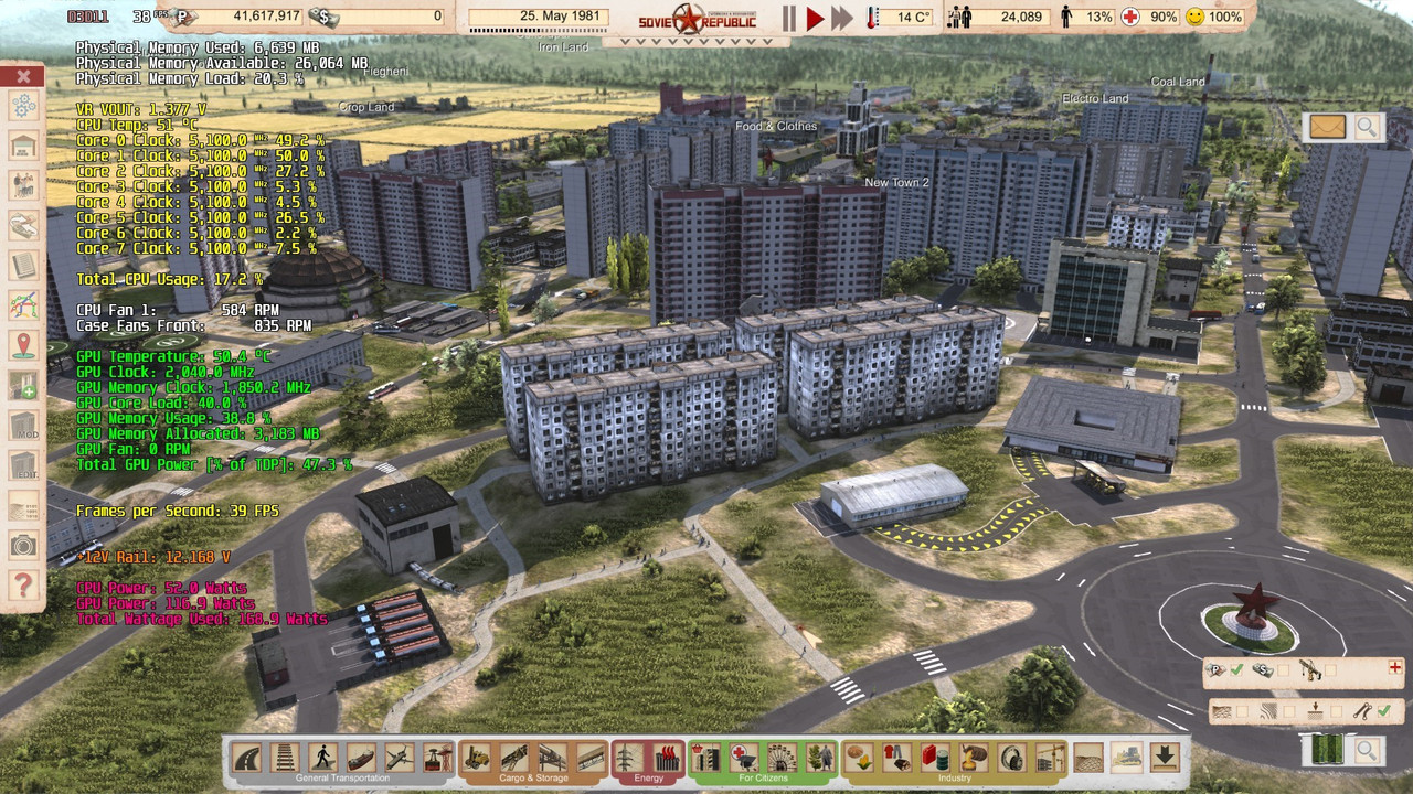

As a rough guide I saw.........
This is with my 9900k running at 5.1 Ghz..........
38 FPS.
If I dropped from 1440p to 1080p the performance would be exactly the same. The game is more orientated around IPS and does not use multi cores very well.

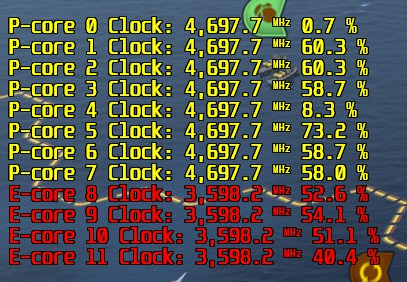

This is directly after my build and with zero overclock.....................
so from 38 to 52 FPS and around a 33% increase, not good at Maths tho.
The game is Workers and Resources Soviet Republic. Whilst that is only one, not very exact, measurement I am hoping that Cities Skylines, Civ type games and the campaign maps of Total War games, turn based, will improve.
I just would not have thought that I would have seen such an improvement from a 9900k overclocked to 5.1Ghz to a stock 12700k.
The E cores do get used in other games..................Civ VI......

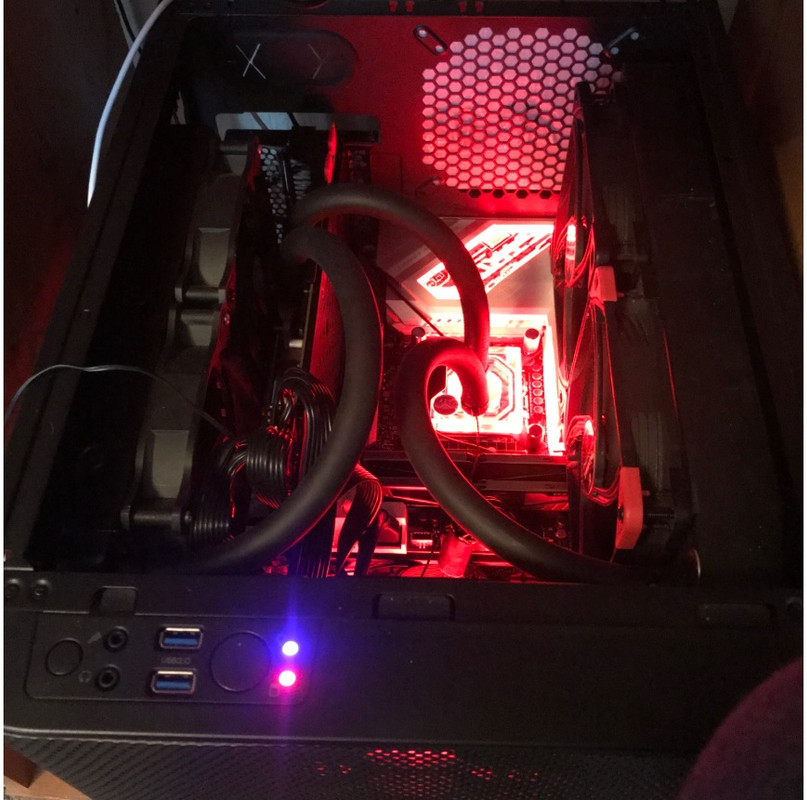

I have a custom loop cooling chip and GPU
The board looks great, I thought it was white but it appears silver?
