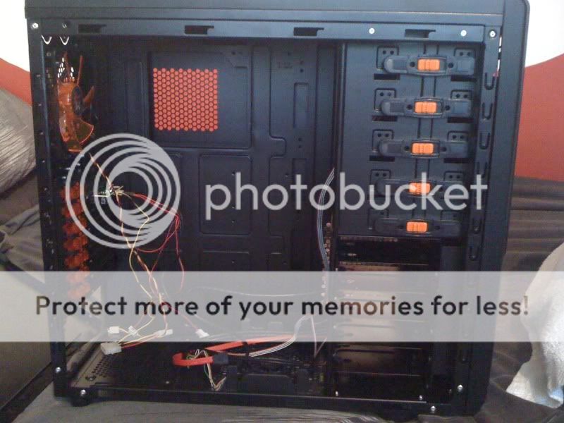

Oh you're also one of only a few people I've seen with a Xigmatek case (I have the Utgard) what did you think of yours? Did your HDD cage come with screws as with mine all I could do was push the HDD in and assume the (very) snug fit would hold it in place?
Yeah, the HDD cage had came with screws that just screwed into the bottom of each hard drive.
