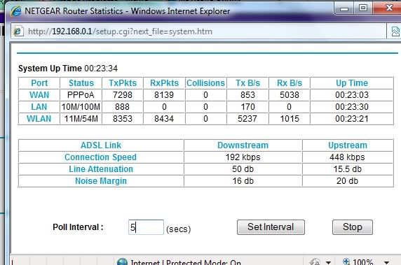

Hi, today my Orange Broadband has been playing up. Tried 3 times to phone them and I get no joy from them. They say there has been a problem and it is sorted now.
My connection is so slow now. Just look at this photo, christ 56k was quicker.

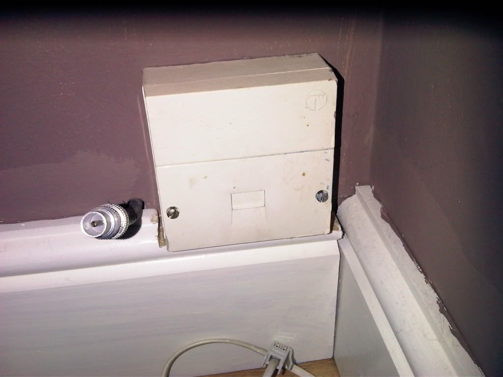

Bingo. Start using the master socket and get rid of your crappy extension(s)!
Try using the test socket behind the master socket as you might be able to squeeze even more speed out of your line by isolating the extension(s).

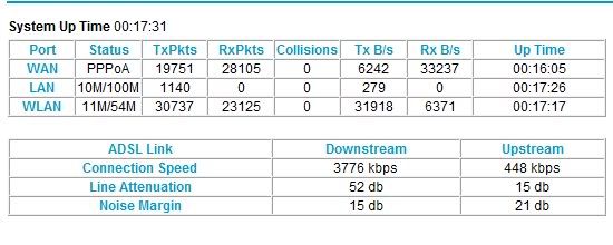

:confused: You get a higher line attenuation for downstream using the master socket yet get a faster/higher synch and the noise margin on DS drops too
Looks a bit weird to me test socket should give a `lower` attenuation surely ?

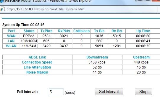

Okay took face plate off of master BT socket and just plugged router (and filter) into test socket and this is my results.
This seem any beter?
Your line stats seem a smidge better when being plugged in to the main socket (IE not the test socket) but only by a fraction!! however your actual sync speed is much better in the test socket for some reason :\ (Your downstream attenuation is 50db in the main socket, and 52db in the test socket, this is quite a high attenuation rate, but should be giving you more than the 192kbps you are seeing in the first screenshot)
Try plugging in to the master socket main socket again? and check the line stats? you tried a new filter? You can also plug a phone directly in to the test socket (no filter) and dialling 17070 to do a quiet line test, the line should be quiet and no noise.
Make sure you change the filters, might be worth getting your profile reset, or your line re-trained
