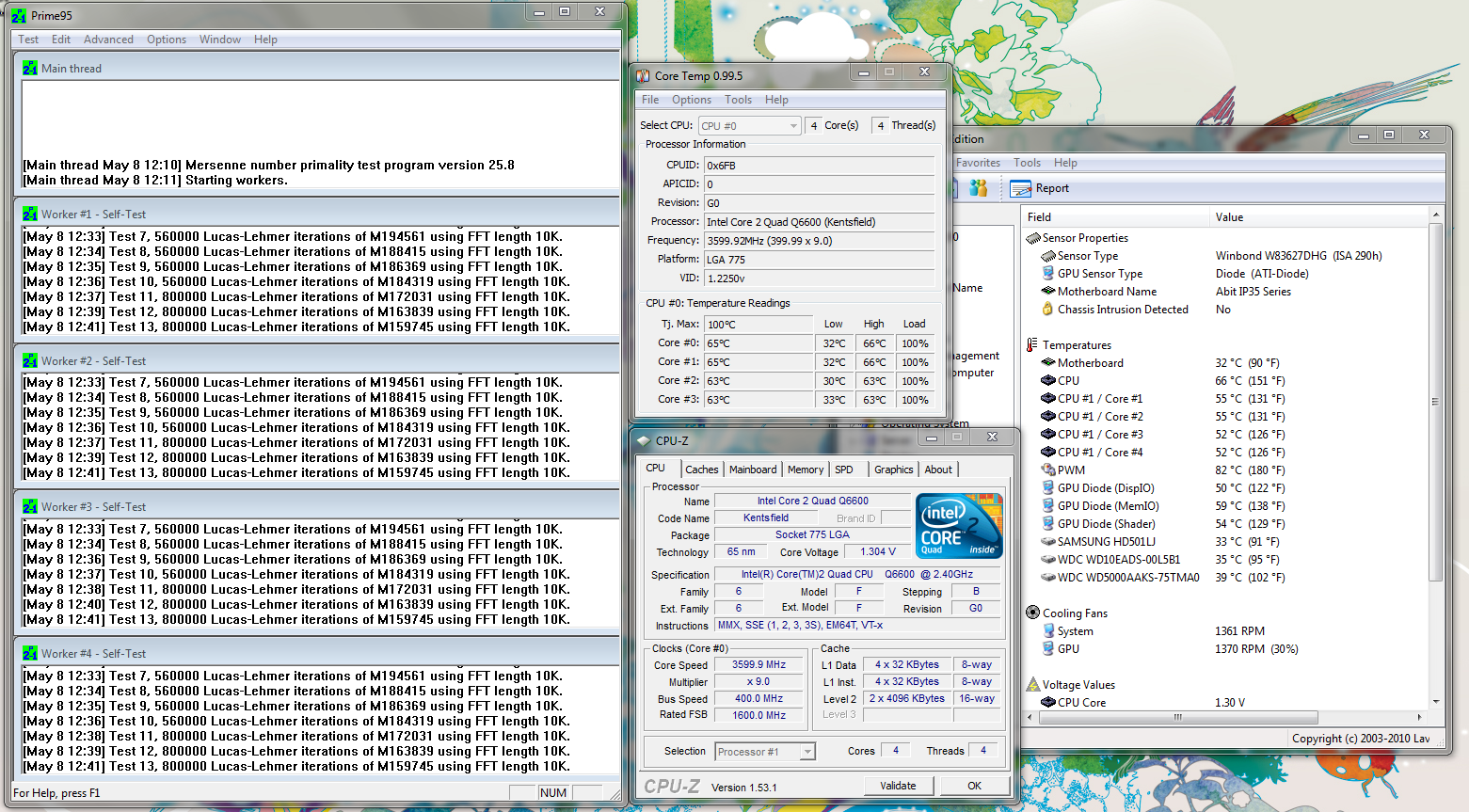

How does this look after about 45 mins?
The volts seem pretty low for 3.4ghz is that right? In BIOS I'm sure I set it higher?
Also is Coretemp or Everest got the right Core temps? They are exactly 10C apart so is it something to do with tjmax?
That all looks fine.
CoreTemp is likely reading higher as TjMax is set to 100c. If you look in Everest preferences you will likely see it has it set to 90c.
Apparently Intel state it should be 90c, but I have read plenty of conflicting articles regarding this.
If you want to have CoreTemp use 90c, then go to Options>Adjust Offsets, and set to -10.
With regards to your volts, looking at that I would bet you set around 1.33 or 1.34v in the bios? If so thats pretty normal, these boards can have around 0.1v vdroop. I set mine to 1.52v bios, and under load it actually runs at 1.42 - 1.43v.
