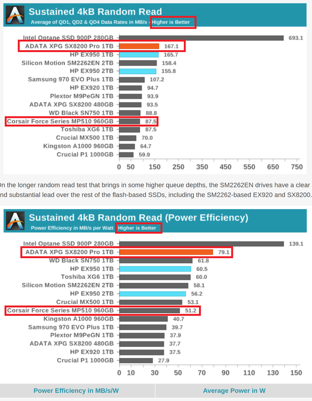

So what about the bench marks posted above showing that it is better?

just scrolled through and noticed you got incorrect info again.
those tests that 4k8kw10 posted are correct, but twisted out of context.
what's more important are the simulated real life tests that anandtech does. ie their "destroyer", "heavy" and "light" workloads.
light tests are most indicative of the usual desktop loads that 99.9% people will run.
you can see the graphs from their website so i won't bother posting here again. except this quote:
When the Light test is run on an empty drive, the SM2262EN SSDs offer excellent performance, but it's not meaningfully better than what last year's models did with the original SM2262 controller.
What's changed is that full-drive performance is much worse, and the gap between empty and full drive performance is much larger for the Light test than for the Heavy test.
basically with the adata sx8200, with a full (or full-ish) drive...it becomes as slow as (or even slower than) a sata3 ssd...lol
good way to spend money. not.
