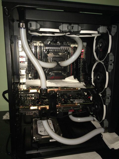

Hi Guys ,
So after 3 days i finish my water cooling and nightmare is here , PC wont start .

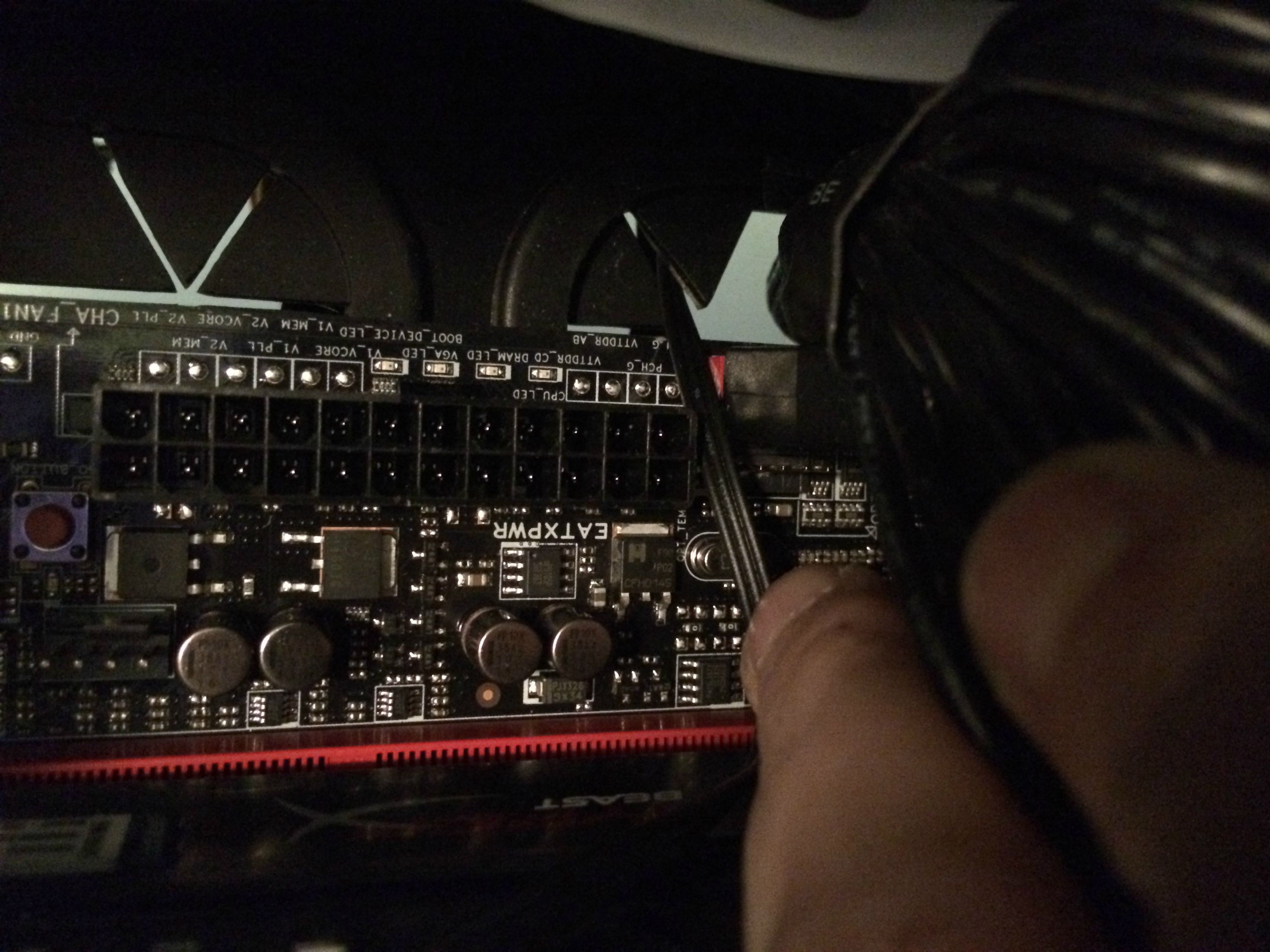

I connect all cables and everything and nothing happens , but when i try push on 24 pin cable - psu make some strange noise please check video (also max your volume to hear)
i'm not sure if i not broke 24pin adapter on motherboard when i first time try take of 24pin connector (hope not),
motherboard lights up
but when i try switch on or press START button on motherboard nothing happens
Any advice ??

here are LARGE pic of what is above if anyone want check them and find something

And no i dont broke any pins on 24pin connector but asyou can hear in video when i push connector psu make some click/noise

but how do i should investigate that ??? i dont have spare 24pin cable on table and as you can see on pic they looks ok , only when i pust then then psu make some small noise , so i really dont no how can i fixt that
