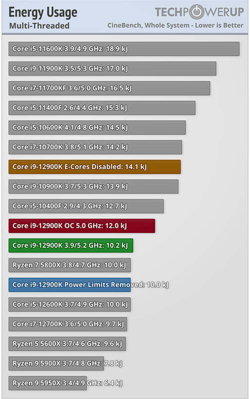

The performance per watt is really bad compared to AMD's Zen 3 Vermeer.
It may be because of the broken and not fixed Intel 10nm manufacturing node.
TPU has some stupid graphs for energy usage measured in kJ for the whole system.
While it should be a normalised performance at 95-watt power consumption and then measured the relative performance of each CPU.
Maybe because they got paid by Intel not to reveal the real picture of the things:
Intel Core i9-12900K Review - Fighting for the Performance Crown - Power Consumption & Efficiency | TechPowerUp

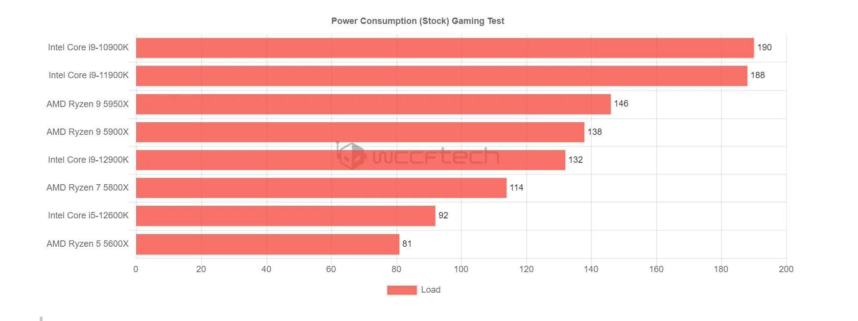

Even more impressive when you consider this performance is delivered while using less power than the 5950x, while being a cheaper CPU!
