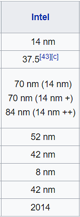

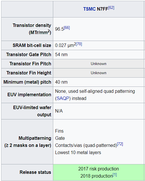

Hi,
TSMC' N7 class processes are much denser which allows AMD to make chips with much more transistors with better characteristics. You can start reading details from there:
7 nm process - Wikipedia
14 nm process - Wikipedia

Hi,
Cheers for this i shall have a read through that wiki page and watch some youtube videos
