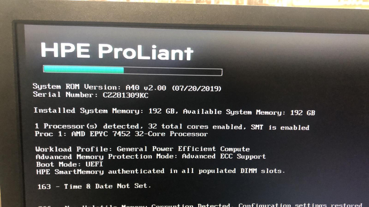

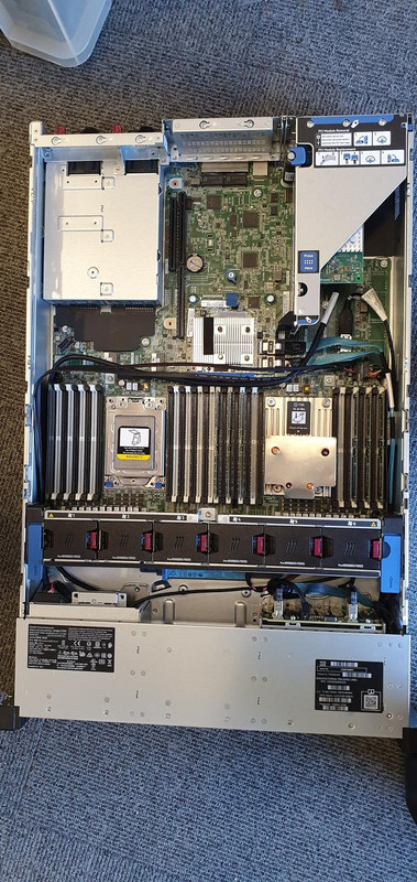

For those interested:
Rome is ready to rock. Only been back in work a few days and am working from home tomorrow but I expect to have it singing by the weekend. So much upgrade room left, 3 empty sockets and loads of space for memory and cpu upgrades. Should be a fun few months.
