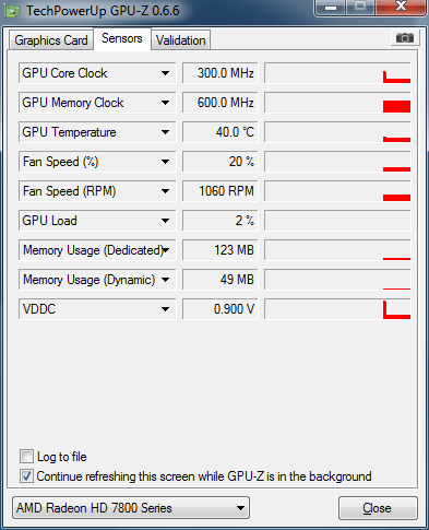

Hmm well it looks like your core is clocking down correctly, is your voltage clocking down as it should?
Try putting the memory as low as it will go and see if that kicks it in to proper idle mode.
Overdrive should be disabled for a start, you've enabled it.
If you run that together with afterburner it could conflict. You shouldn't even enable it if you plan to use afterburner for overclocking.
"Enable Graphics Overdrive" is unticked, though?
Just to make it clear - my memory wouldn't downclock even before I opened CCC. First thing after installing the drivers I checked GPU-Z and memory was stuck at 1200.

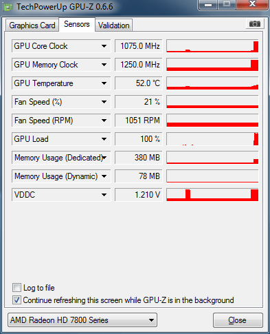

Yes, the core is clocking down correctly and I think voltage is as well.
Idle
Load

Seems as though for some reason its just the memory on your setup which is not clocking down.
Do you have Trixxx installed by any chance? I'm seeing reports that trixx is causing some powerplay issues (due to un-official overclock method rearing its ugly head)
Max voltage at idle still exists for me after 12.11 6b install.
I have a SAPPHIRE 100352-2L HD 7950 and I'm seeing 1.244 V at 0% GPU Load with any OC profile applied."
"Are you using Trixx? Trixx makes the Vcore stay at 3d mode. That's why Trixx sucks for 7XXX Cards imho.
Im on Sapphire 7850 Not Vcore issue neither."

I did try Trixxx as well at some point, but I uninstalled it again as I preferred Afterburner. Haven't installed it again after I followed the steps in your guide, though.
I also tried the unofficial overclocking method in AB, but again, I have since uninstalled both AB (and settings) as well as Catalyst drivers as per your guide.

sounds like your install is borked. uninstall drivers and overclocking software and reinstall again starting with the new drivers.
install is not borked its cause they changed the ati drivers after 12.2 :(
basically what happens is afterburner or trixx starts before ati catalyst and causes lots of issues
why they havent fixed it i dont know
i just done driver sweep cleaned all ati stuff out just want ati driver no ccc installed and both trixx and ab should be fine then
Ah Dg, you need to follow my guide. However before you un-install afterburner untick start with windows and apply overclocks at startup, also delete your user settings to start from fresh. Do not keep them when un-installing. That's what is causing your problem.
Once you've done that follow the guide from the start and it will work properly and you will be able to have CCC+afterburner at the same time.
