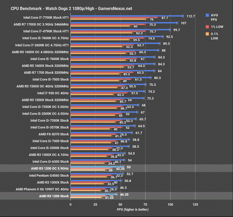

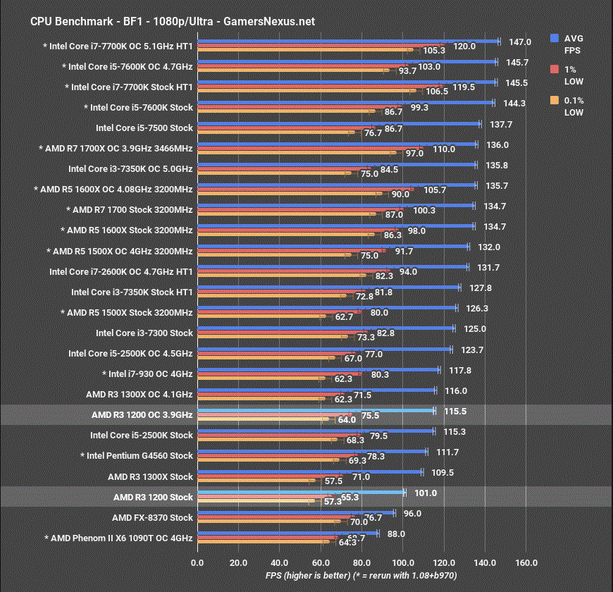

Thread resurrection: There's been a lot of water under the bridge since this got going.
You don't see much about Phenom IIs these days but I was interested in how they compare to more recent CPUs in games, given I'm still running my unlocked Phenom FX-5200.
And the short answer? Clock for clock and core for core, they beat Bulldozer and Piledriver. A Phenom II 955 or 965 is roughly equivalent to an FX-4300. An overclocked Phenom II x6 can still, in some circumstances, trade blows with a stock 4 core Ryzen. Sure, a Sandybridge onwards quad from Intel is in the same or better territory (unless we take 0.1% minimum framerates into account), but it's impressive to see these CPUs still have a little life in them (as long as they are paired with an nVIDIA GPU (these are with a GTX 1080) - AMD GPU drivers don't like a weak CPU.
Source: https://www.gamersnexus.net/hwreviews/3002-amd-r3-1200-review-line-between-fine-and-exciting/page-4 (as long as you ignore AOTS...) - and the various benchmarks available on gamegpu.com.
I'm surprised to see the phenom X6 keeping up with the ryzen 3 tbh, although that's mostly when it's clocked at 4GHz and compared to a stock ryzen 3. I'm curious to read more about this NVIDIA doing better with lower end cpus than AMD. Do you have a link?

The graph is generated from gamegpu.com. Most of the more recent game GPU / CPU benchmarks let you select a particular CPU or GPU to compare. It's quite useful for identifying bottlenecks. - It's not shown but grey is minimum framerate. The red or green is average framerate (depending on whether it's AMD or nVIDIA). The two are on separate Y scales.
Edit: There's another article here http://www.overclock.net/t/1495236/amd-vs-nvidia-cpu-overhead - Essentially: where there is a CPU bottleneck evident, it's frequently worse with an AMD GPU than with an nVIDIA one because of their respective driver overheads.
