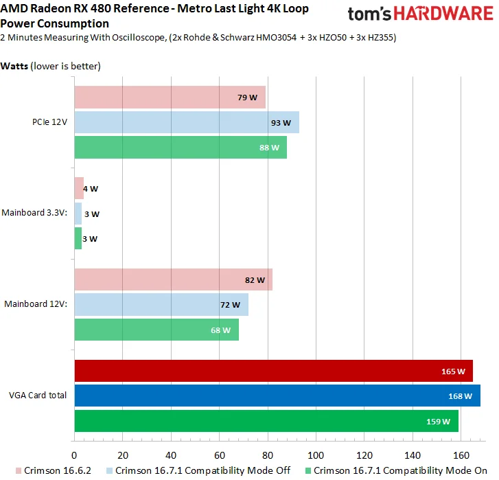

The new drivers to fix the 480 power draw are out.
http://support.amd.com/en-us/download

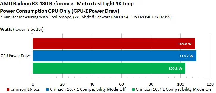

Here's Tom's tests on the new driver.
http://www.tomshardware.de/amd-radeon-rx-480-polaris-grafikkarte-treiber,testberichte-242146.html

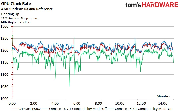

Well, the driver performance improvements are a separate thing. If the new compatibility mode has indeed lowered the clock speeds, then yes, it has technically been 'gimped'. Basically, it would mean that if you didn't have the clock drop, you'd get even more performance from the driver update. This is assuming there actually is a clock drop(which I saw somebody post an example of, but not sure if that's representative of every 480).

According to Guru3d when testing the new driver. The main issue is still throttling from that tiny little heatsink more than anything else. They noticed no performance difference at all.
They also state that the new "Compatibility Mode" is irrelevant, as the normal driver mode already reduces power load to be within spec.
Now in the driver you'll notice a new 'Compatibility mode' as well as a new 'Power Efficiency mode'. These modes are irrelevant in the sense that you do not have to change them.
I've also added a core clock recording of the card in a 3DMark FireStrike loop. Though there is less varying throttling, the card runs below 1200 MHz with that benchmark (which is normal behaviour). I verified and compared this with against Unigine Heaven (also included), which runs steady at 1240~1250 MHz in an Extreme mode. So the card does still reach its maximum boost frequency.

Thanks :)
Right so 68 Watts on the PCIe, down from 82. Panic over, don't overclock it. :rolleyes:
Thanks :)
