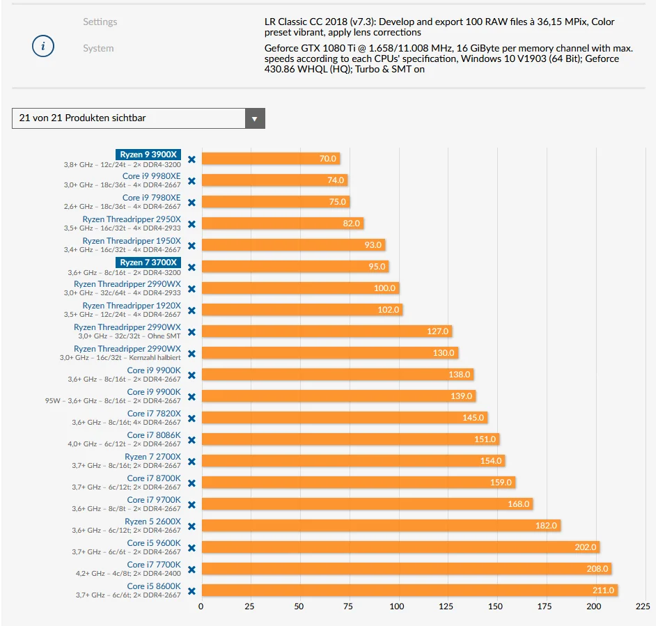

The chart you demonstrated above is a batch test. I'm not sure you've worded that correctly as ANY batch test is always FULLY MULTI-THREADED. Consequently, they have a lot to do with core count. Extra cache will aid performance though the main reason for the better performance of the 3900x is the full usage all core clock speed + IPC. The Threadripper 2950x is ~3.5ghz compared to the 3900x which is ~4.2Ghz plus it has higher IPC (~18% I believe). This alone could account for the 3900x's 12/24 better performance than the 2950x 16/32 not including the larger cache:
2950X = 16x3500 = 56,000
3900x = 12x4200 x1.18(IPC) = 59,472
Either way that graph is definitely a fully multi-threaded graph and I can pretty much guarantee you that every CPU on that list was maxing out all of its cores when doing that batch test. As such it is not really the topic of this thread, neither is power consumption or value for money etc. We're just concerned with single threaded performance or as I prefer, non-fully multi threaded performance.

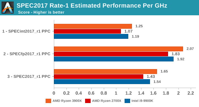

Anandtech has done IPC tests for the actual core:
https://i.imgur.com/hXbCqQG.png
Again actually look at the graph CAREFULLY:
https://i.imgur.com/IkN4Pwy.png
A Ryzen 7 2700X is 58% slower than a Ryzen 7 3700X in the test,and a Core i9 9900K is 45% slower in that test. All have the same core counts. Look at CB20,a Core i9 9900K is slightly ahead of the Ryzen 7 3700X. A Core i7 7820X is barely slower than a higher clocked Core i9 9900K,which is also interesting,so maybe memory bandwidth is also useful here.
The fact is the cache(and maybe even memory bandwidth) impacts the score massively - Lightroom exports are more determined by cache it appears,than the number of cores and the single threaded performance. The same with the latency stuff I was talking about. Performance in applications isn't just about pure single threaded performance,ie,there are other factors at work here.

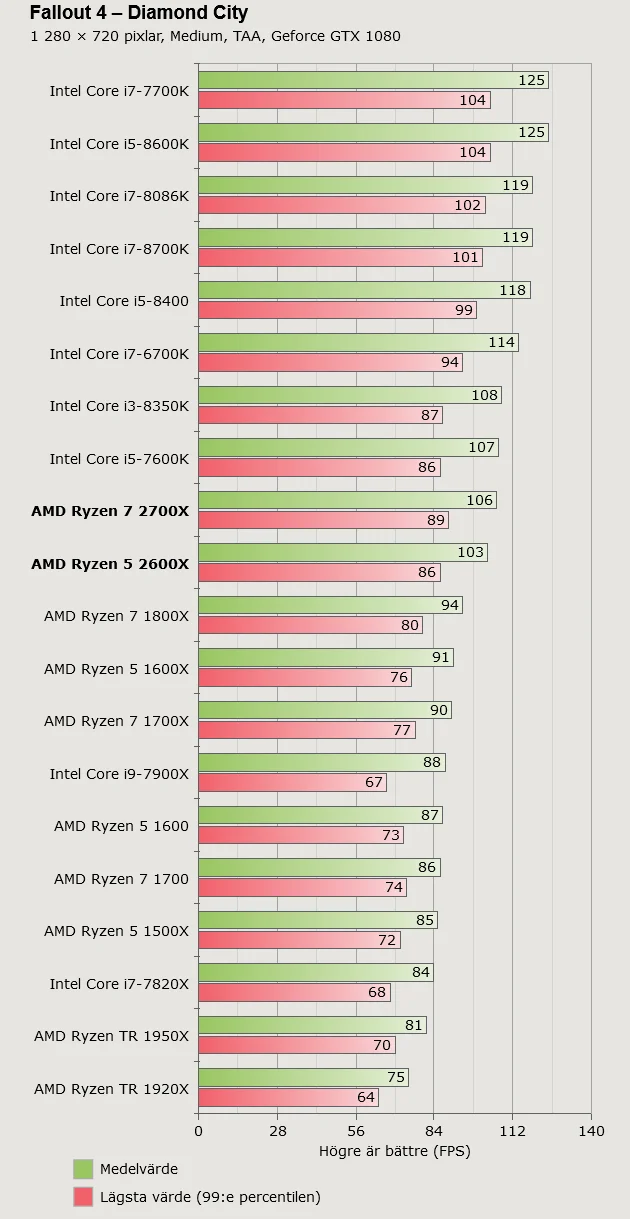

If someone were to try and gauge IPC from using Lightroom export tests,a Core i9 9900K would be considered very poor against a Ryzen 7 3700X. That is the problem,there is more to apparent single threaded performance than just IPC or clockspeed. Even software which has lack of optimisations for newer CPUs,cause problems,ie,like I tried to explain with Fallout 4.
That game is latency and memory bandwidth bound,to the extent you can have the SAME HEDT Skylake cores on a mesh bus(such as the aforementioned Core i7 7820X),and the consumer Skylake cores on a ring bus,and the former is worse. So the same IPC. This game is bound by the first two cores which become saturated,and scales less to the next four.
A Core i7 7820X at worst should be at 3.6GHZ base clock,and the Core i5 7600K at best would be at a 4.2GHZ boost clock. For a maximum 16% clockspeed difference,performance is close to 30% higher on the Core i5 7600K with the same Skylake cores,less memory bandwidth,and half the cores(and the game will use the two extra threads in a minor way). That is what going from a ring bus to a higher latency mesh bus,and a different cache topology does,in a game which is still very single thread bound.
