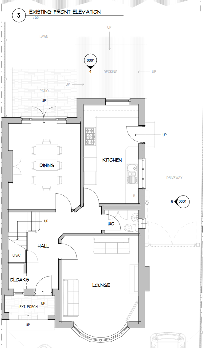

The existing house plan looks like this:

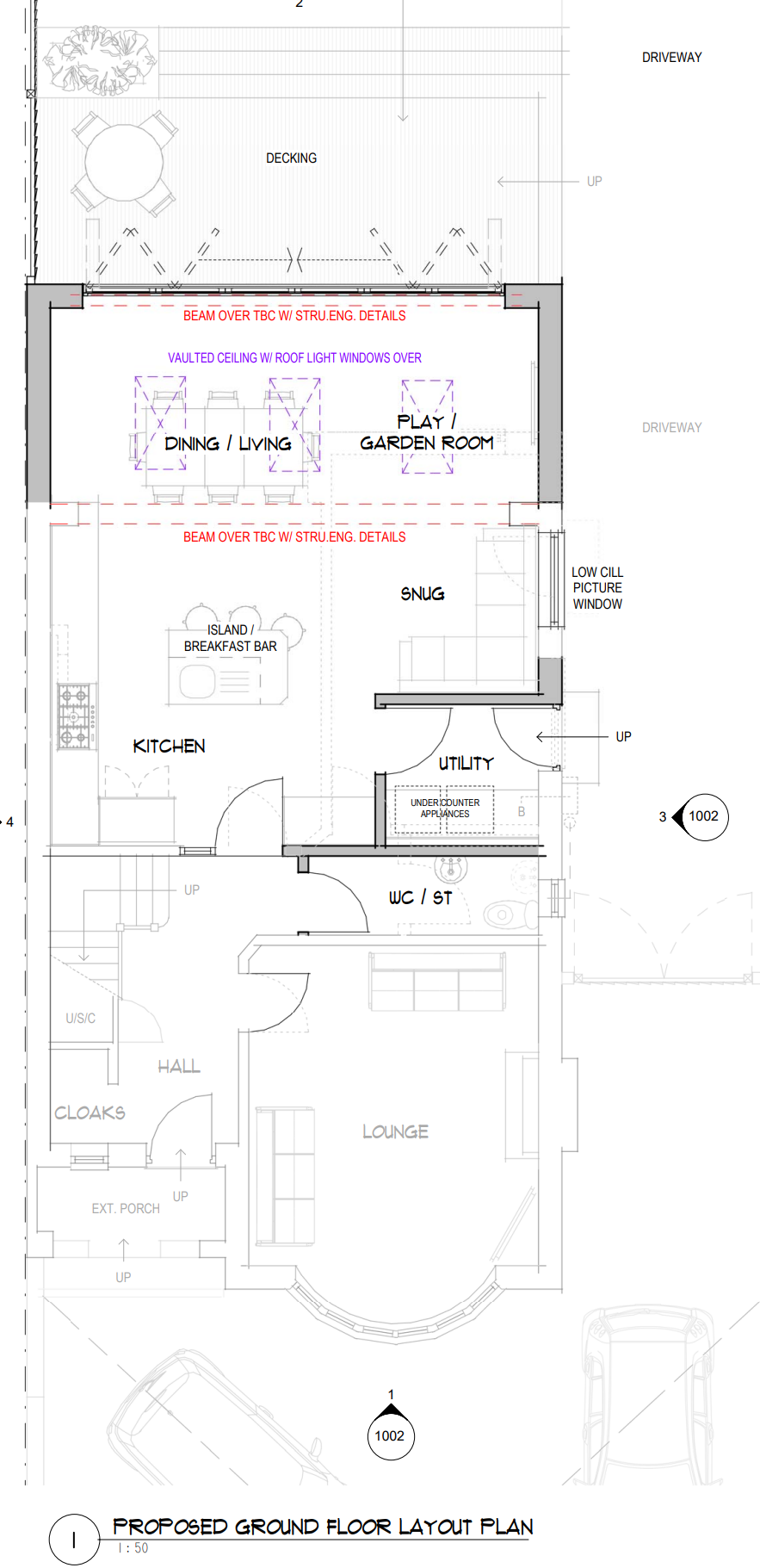

We will be altering the layout to be like this:
We'll have four large bits of steel going in to the house to replace the load bearing wall, and we've had a structural engineer do all the calculations to ensure that everything is supported as it should be.

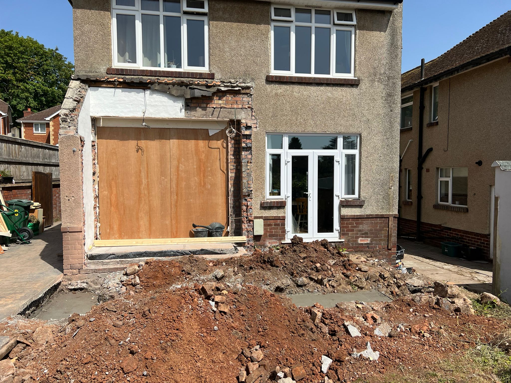

Lean-to coming down.
Lean-to is down, and the external wall is being kept in order to give us some solid foundation to build upon for the steels / extension block work. A partition has been put up so that we can continue to use the kitchen for the time being, until the steels go in and the external wall has to go!

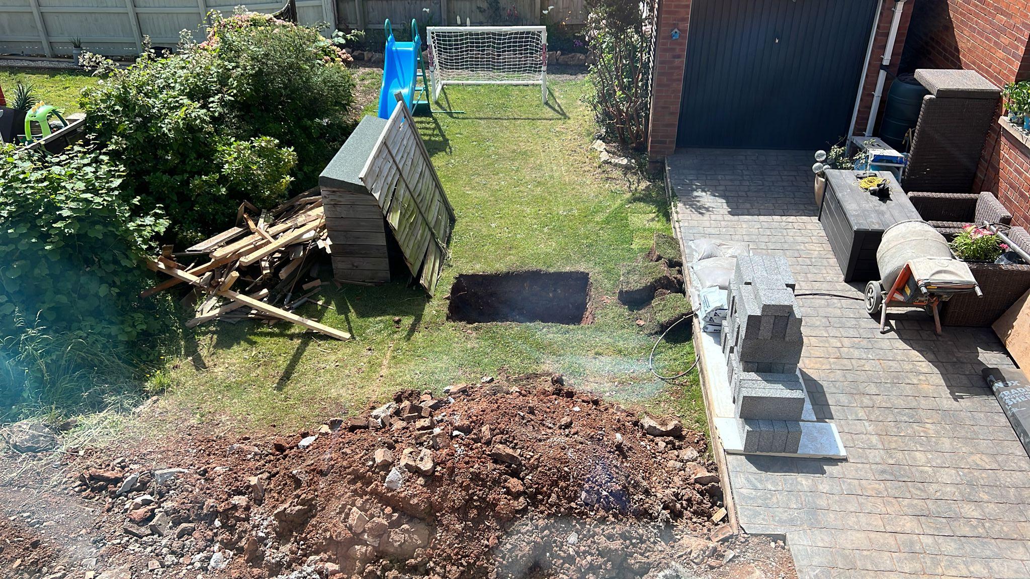

Taken from the first floor third bedroom - We realised that the guttering for the old lean-to goes literally nowhere, so needed to dig a soakaway.

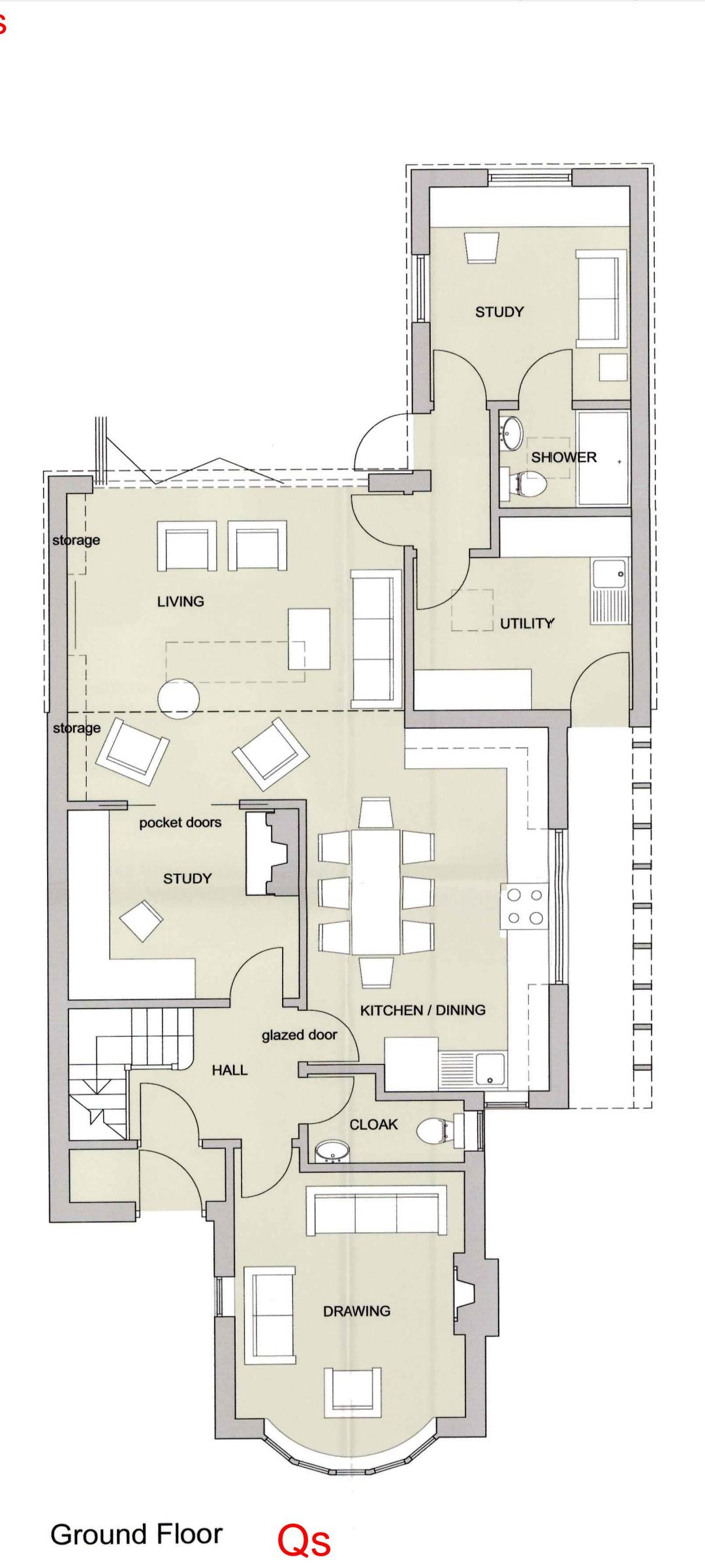

My layout
if interested (mine has also been widened at the kitchen and extended from the first study outwards)

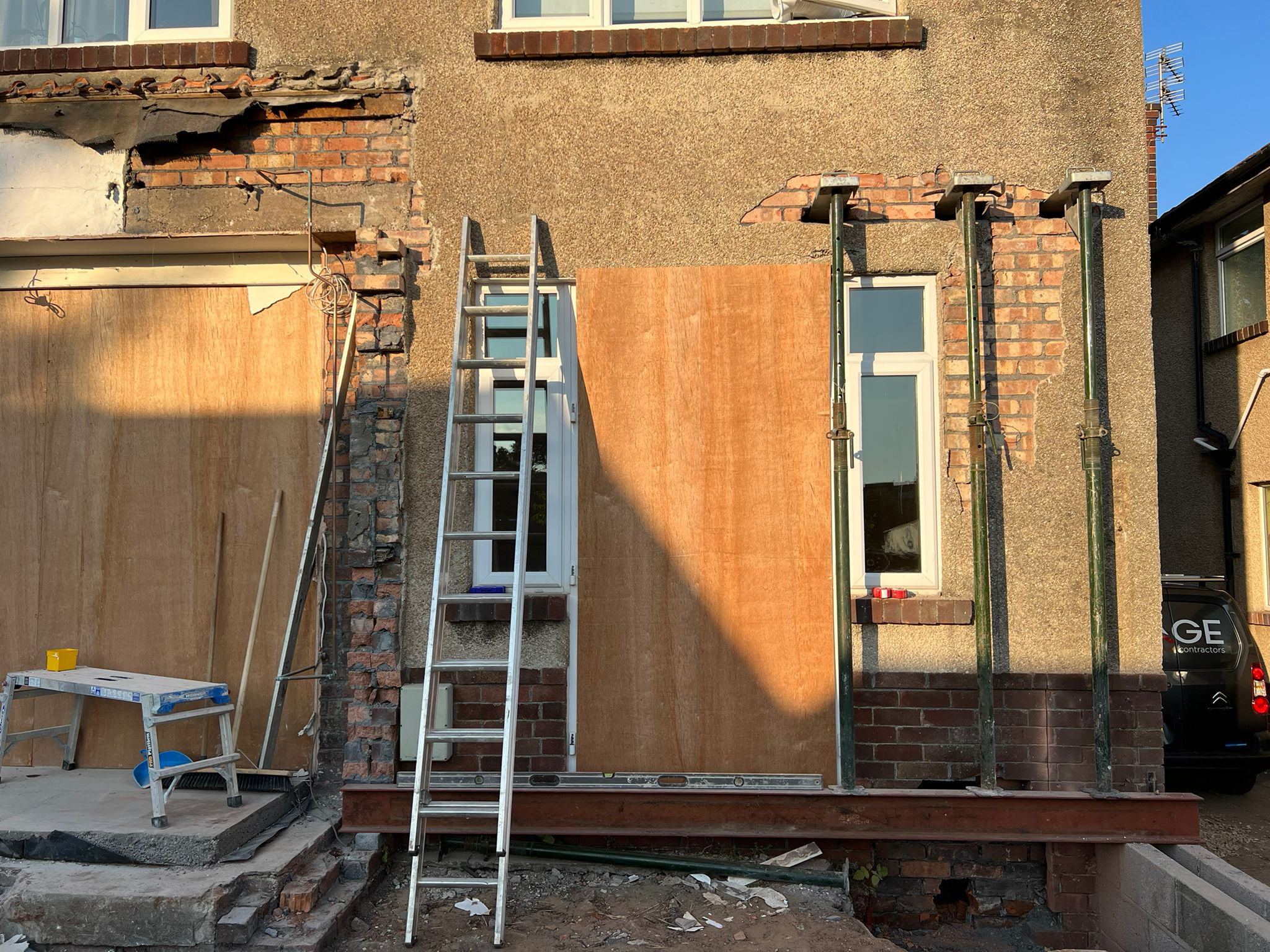

Started to insert some props to hold up the house once the lintels are removed and the steel framework is put in to place

Next week there will be more props going in, some brickwork and old lintel removal, and hopefully in the middle of the week, a half-tonne piece of steel will be going across the top opening of the house :eek:
Something I always wondered is how you get a full width steel in place in existing brickwork. I can see you've starting supporting with props, but at some point you have to have a full width of brickwork removed to get the steel in and the brickwork above it sitting on the steel. How is this achieved?
I’ll document this so you can see :D
