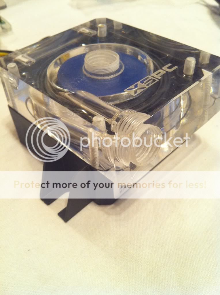

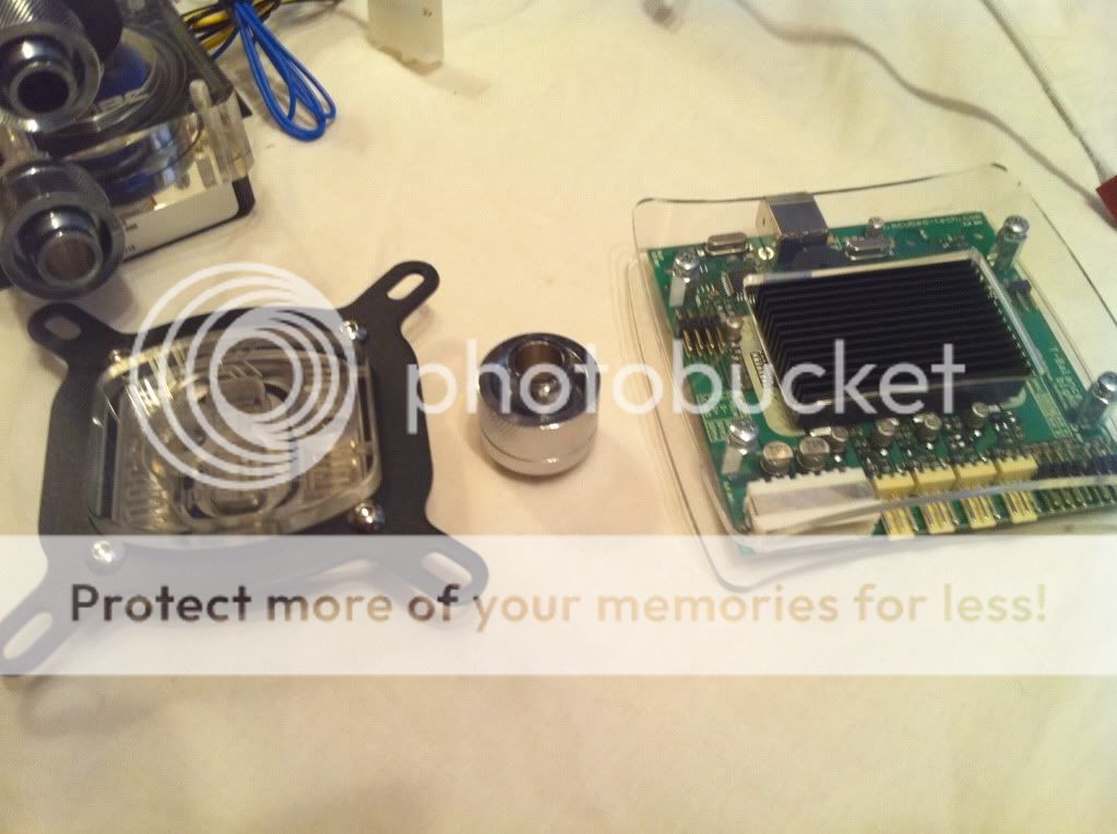

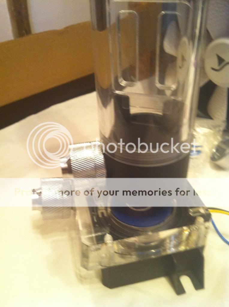

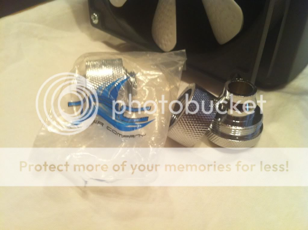

A few picks of unboxing and puttin a few bits together (hope the pics work, never posted images before)
Can you fit those compressions side by side on the plexi top supreme? Also is the compression on the bottom of the res doing up enough to make a propper seal?
Yea the compression fit next to each, the double G1/4 thread isn't very long but does make a very good fit. Guess I will find out when I leak test it tomorrow. Hopefully it will be okay
Glad to see you have done a fair amount of research and thought this one through thoroughly, it shows in your component selection.
Looking forward to your finished log, as Jeffy said this would be better in the Project Log section, can easily be moved by a mod if you contact one
Not sure if JeffyB didn't mean the visible comp fitting on the side of the res or the hidden fitting between the res and pump inlet, which is what I think you are referring to.

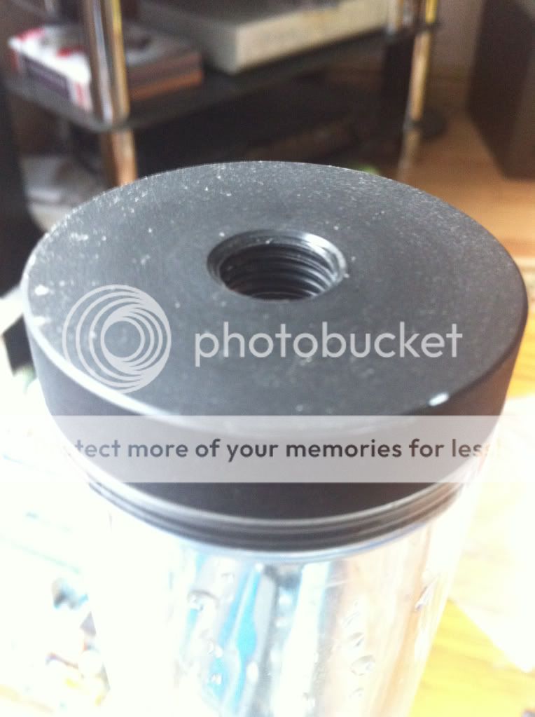

Considering the compression fitting, you have to make sure there is enough "flat" and peripheral clearance for the fitting not to bottom on a raised bit of the res before the o ring has compressed sufficiently. From the looks of the pic the fitting looks a bit big for the available flat, hard to tell really thogh.
Considering the double g/14 fitting, is it one of the rotary fittings or fixed? If fixed then you've been lucky in that it has tightened up with the res inlet inline with the pump outlet.
Thats exactly whet i ment Bubo, unless ek have change the design of the circular flat area around the inlet on the res a 3/4 compression wont screw into the res enough to make a seal. This is why i had to use a couple of rotaries on my ek multi 250 res.

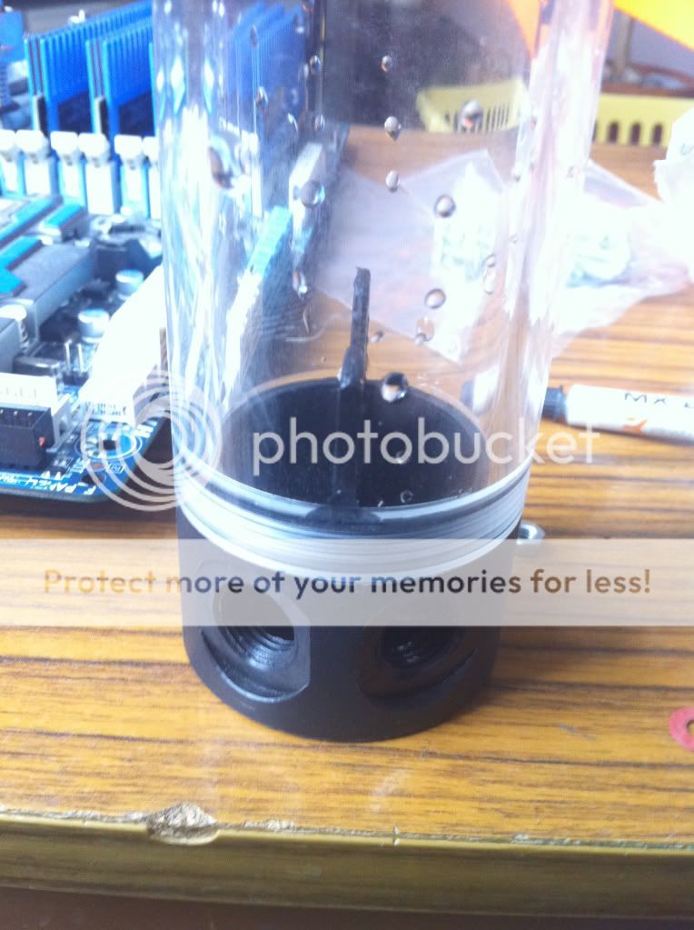

Can you do us a favour, since you have the advanced version of the EK res. Can you take some close up pics of the top and bottom showing the available ports. I have the normal version of the EK res and am thinking about changing cos of the abilty to now properly use this res as an inline vertical res due to the internal tubes and extra ports.
Will upload photos when I go back home budo, doing this at my dads workshop at the moment.

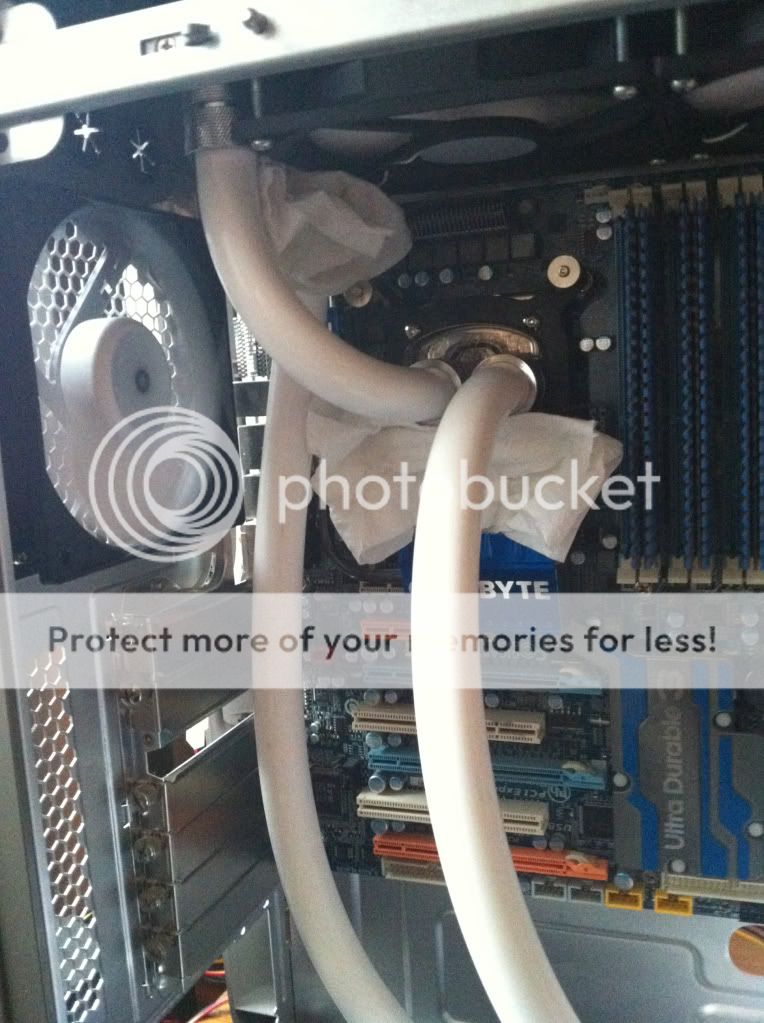

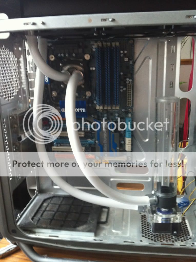

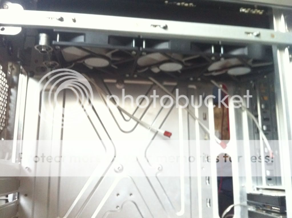

And here is my progress so far. Haven't got
Any further than leak testing it so far due to one thing or another

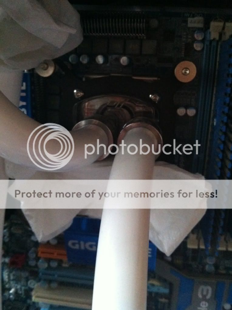

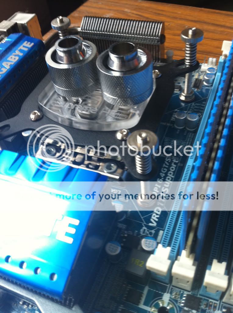

The block mounted up (the instuctions were rubbish so if I got this wrong please tell me)

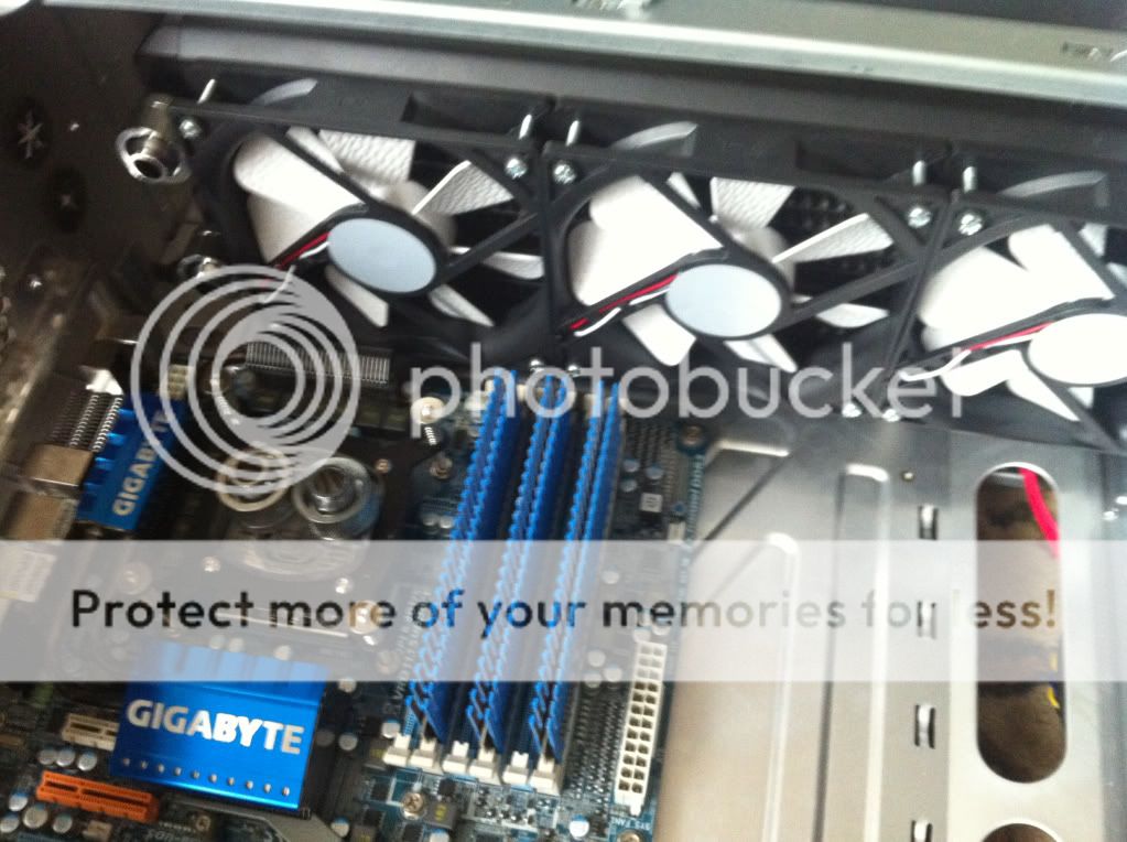

The fans on top of the roof
The motherboard installed

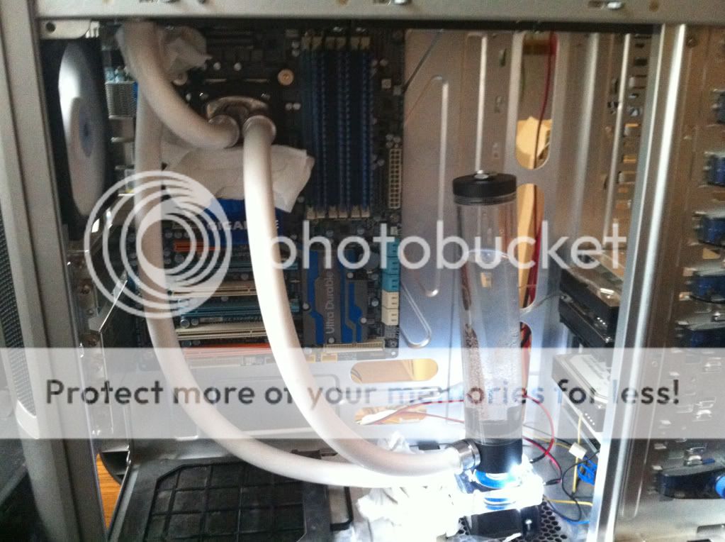

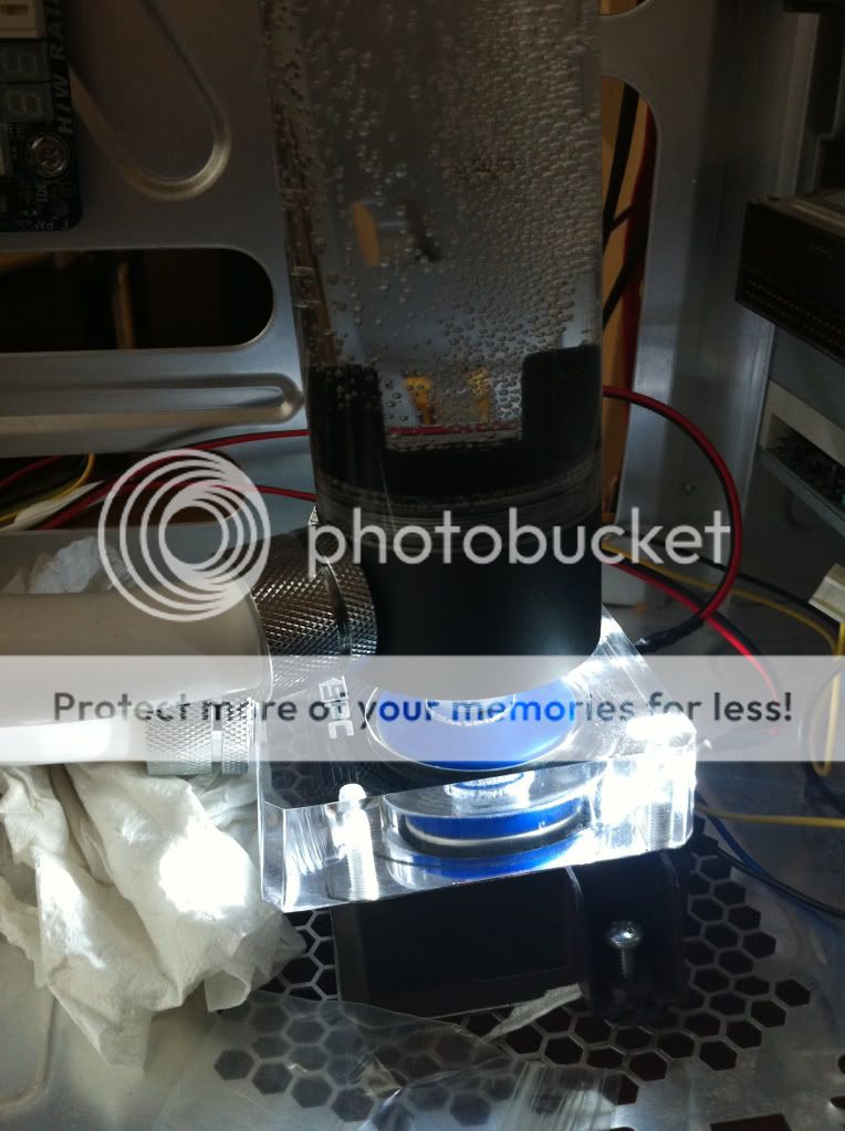

With the pump and res mounted
And leak testing
So far so good, will install the rest in the morning although I have had a few drinks (and will have a few more) as I got a new job today so it won't be to early
Any thoughts let me know

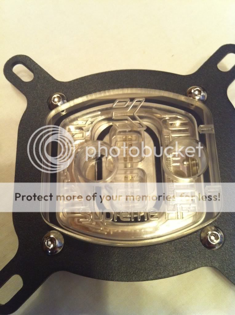

Shouldn't the springs be at the bottom and you tension onto them? Never done WC but it looks wrong in that photo.
Thanks for the res pics, however that is a normal EK multioption res not the advanced as per you spec list, hope you didn't order the advanced and get the normal by mistake.
Bit late now but it looks like you would have been better off with a restop instead of the xspc top and ek res combo, but once you sort out the leaning tower of Piza thing it will be ok. Also if you are still having problems bleeding that then there is no problem with temporarily unscrewing the pump feet and lifting the pump out of the case while you rotate the case around, if you haven't already sussed that. With the way you have your rad barbs pointing downwards you pretty much have top do that to ensure all air in the rad can get out.
In theory it shouldn't matter which side they go, however there is usually too much clearance between the plate and the bottom nut for the spring to be able to compress.
