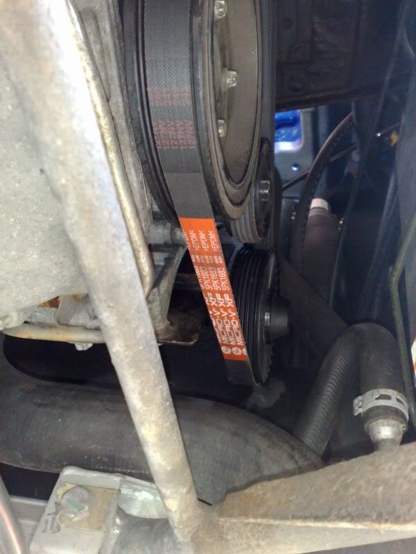

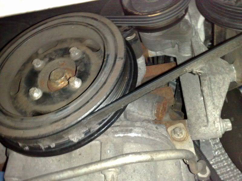

Noticed the Aux belt was looking a little like a shoe string so changed that on Friday night. Struggled with it because of space but changed it eventually.

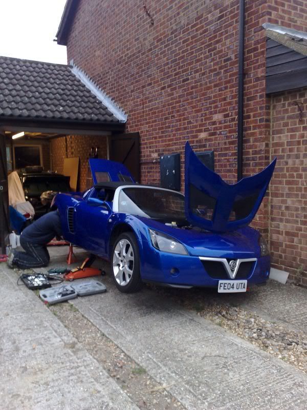

Some pics :)
Lets get to work
Old belt - looking a bit tired
New belt - Took a fair few hours but im pretty slow with a spanner :p + it took me a few hours to relise how the tensioner worked .....

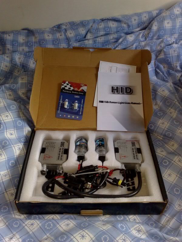

HIDS 6000K

[TW]Fox;12428191 said:
Do those ballasts really have OMG written on them? :p
Yep , the seller is called OMG SO COOL CAR !!! Did quite a lot of research before i bought these and some people have been running the same units for over 6 months without problem. They cost nothing these days £34 all in :cool:

Been like that for a while now, when i had my astra i paid £28 delivered for a 6000k set with 12 month warranty :)
diane-shop on ebay is the seller who used to be cheapest, but theres loads on there now that can easily match/beat their prices!
