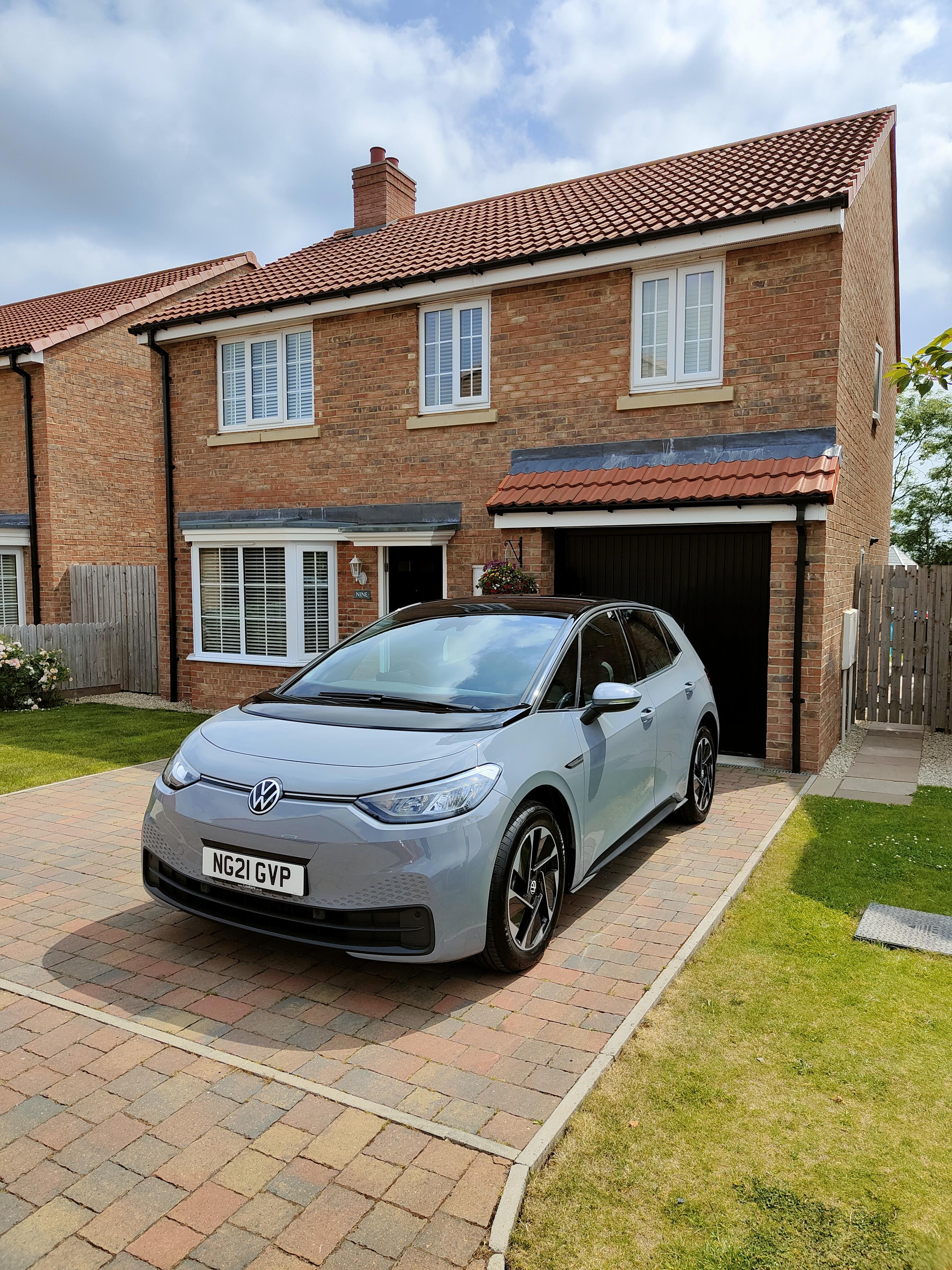

Hi all,
We are currently in the process of getting quotes for a garage conversion...well if people actually turn up!
We live in a 4 bed detached with a integral single garage, the usual 7 year old new builds.
I'm wondering if anyone has done similar and could tell me rough costs.
Basically it's a window to be fitted at the front approx 1800x700mm bricked up the rest.
Floor is already concrete and level, just a bit if insulation needed at the front and then made to a finished room excluding decoration and carpets.
4x spot lights needed and 1x radiator to be plumbed in.
I would imagine a pretty straightforward job.
Should I be looking at £4,£5,£10k??
I know it can be a bit of, how long is a piece of string but need some ideas in my head so I'm not underestimating the costs.

I should have maybe put a photo in to make it easier for people to picture as going by some prices being thrown about.
Had another estimate of £4k.
£1k for the window and bricking up of the door then £3k for the internal works to get it to a level ready for paint.
This quote is an estimate as the fella is booked up most of the year and as I'm not in a position to book right away didn't want to fix in which is fair enough.
With this in mind I hope I can get my preferred builder down to atleast meeting in the middle at £4.5k.
