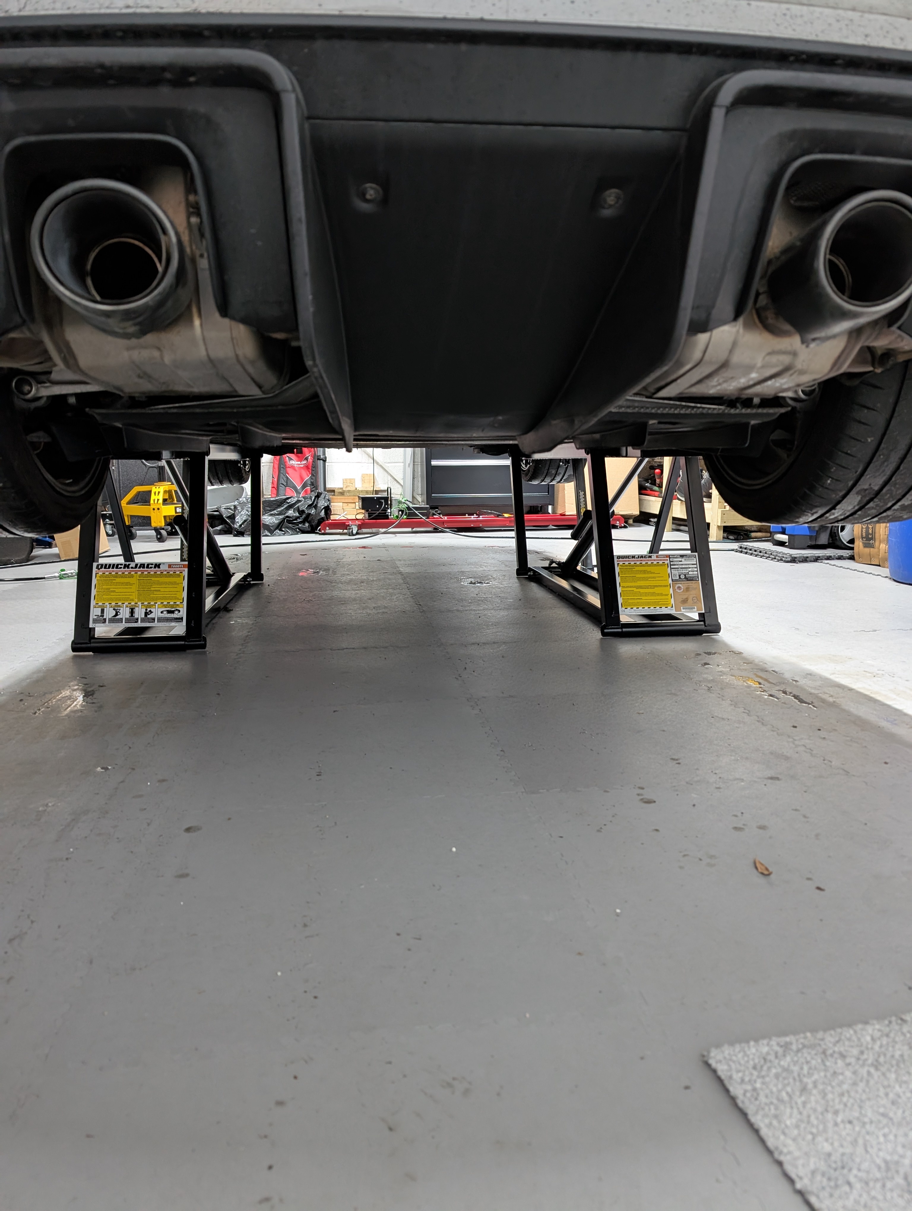

I decided to punt for one of these recently as I've always wanted one but never bit the bullet until now.
Costco are currently selling the 7000TL for £1150 versus £1450 and I couldn't say no at that price!
Mine was arriving today so I watched the videos, read the manuals, etc. and expected a fairly involved setup process. I got them out the boxes and nada. The lines and fittings were joined together and installed already; all I needed to do was add hydraulic fluid and bleed the system. Easy! The quick disconnect fittings are excellent and don't spill a drop of fluid.
The jacking height is about the same as you could achieve with a trolley jack but this would mean multiple times lifting each side until reaching maximum height. On cars like mine, where there are only 4 jacking points without taking off an army of covers, it's a godsend. Up and down times are super acceptable for what it is.
My biggest gripe is that they are pretty heavy to cart around, but they do slide pretty easily on my PVC floor. I don't think it would be a pleasant experience on concrete...
After faffing around with the rubbers that sit between the jack point and rail, I have marked out where they should be placed for my car and hoping that will cut that alignment time down significantly.
Without further ado, here are some pics. Yes, my car is dirty. No, I don't care.

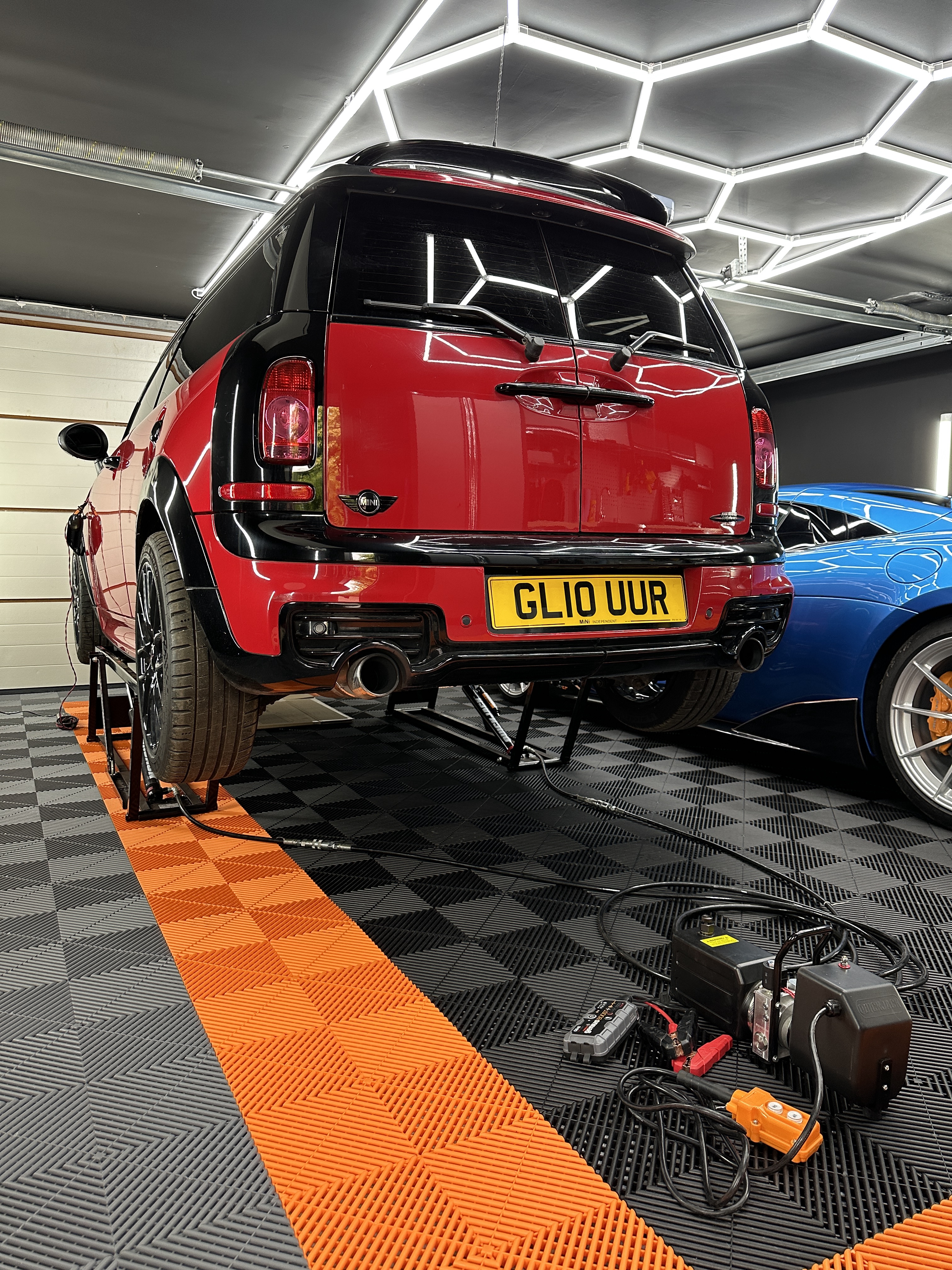

I'm seriously considering a set of these myself. I do a lot of work on the S2000 myself and having the ability to get it up in the air quickly would really help.
Id looked into them but decided if i was getting one i'd just get a mid lift scissor lift instead, seemed a better option as it goes higher and is all 1 unit so less faff, you just drive over it and up you go. can also just be left on the floor all the time and park on top of it when its down.
Had mine a few years, very handy but it still takes a bit of faff to get a car up in the air.
I’d love a scissor lift so I could drive in and out without moving the ramps. But I wouldn’t want one with a join between as it would be a paid for removing exhausts.
I had to buy extenders for mine as my latest car has too long a wheelbase. But this meant the lowest height is now too tall so I have to drive the car on to rubber ramps first ‍♂️

I got my Quickjacks for Costco also. Had them a few years now. I have to drag mine on the driveway which is a bit of a ball ache.

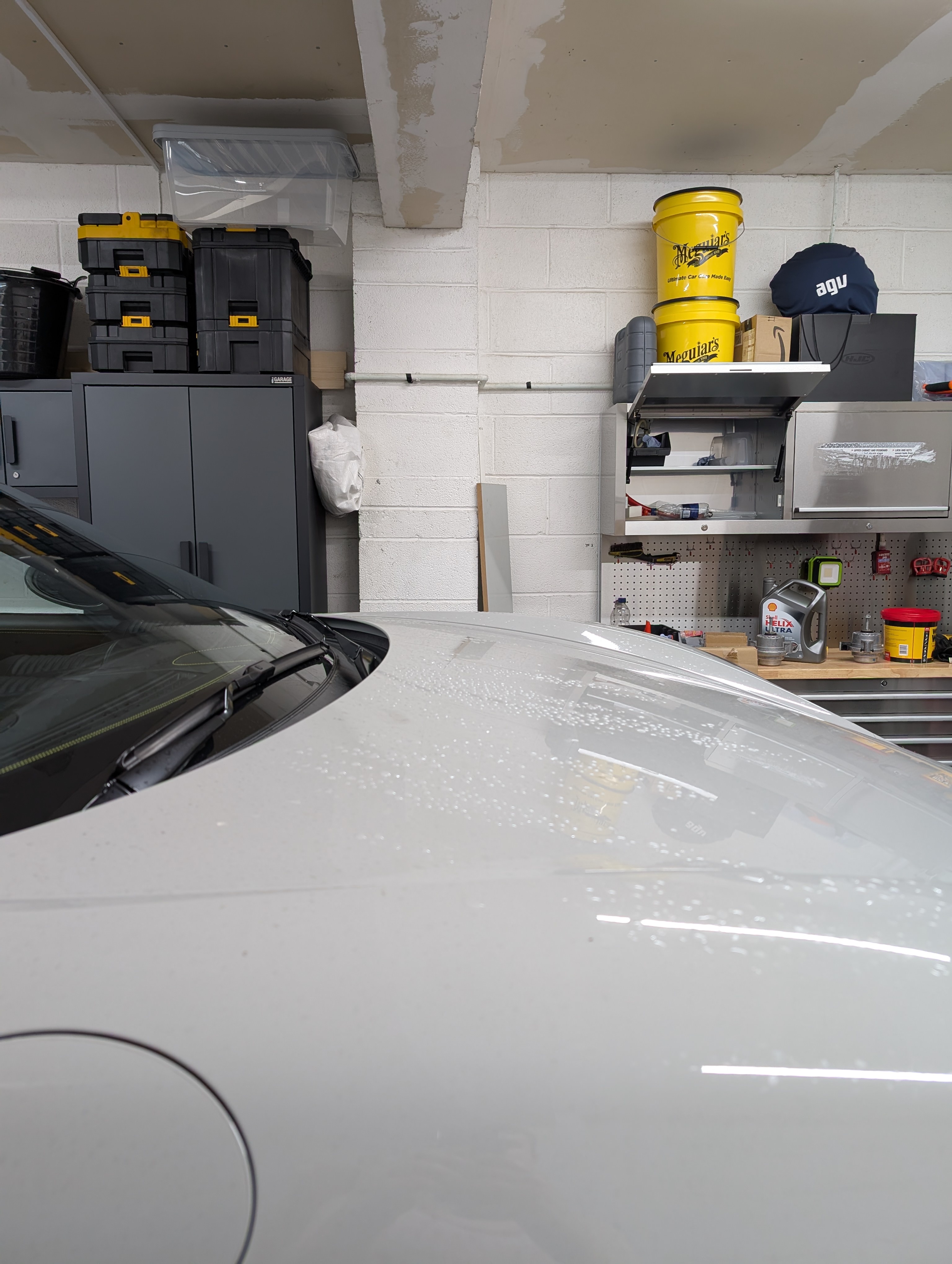

Only thing that will be awkward when working on the Cayman will be removing the undertrays to get to the oil drain plug. The jacks cover the fixings so will have to jack a side, remove the fixings along each side, lift the car then remove the rest and hopefully the tray won't get stuck trying to get it off.
