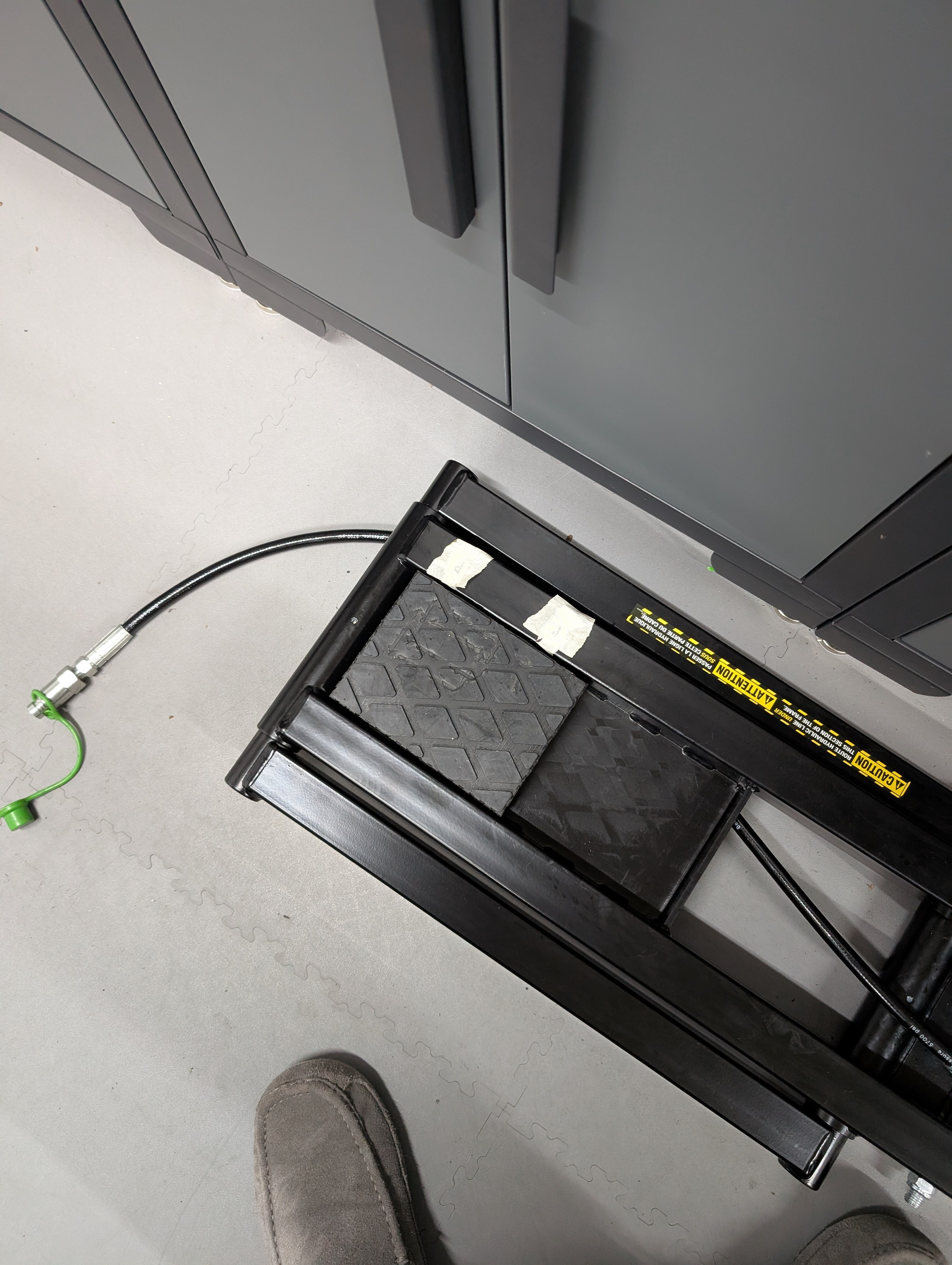

After not enjoying the frame alignment at all my first two uses, I bought some significantly bigger rubber blocks. I recently put those to use and it was definitely worth it. No faffing around with getting the frames and blocks in just the right position. These are 120x160mm blocks and they fit in the QJ frames perfectly as you can see. The shortest block that I could get in and still clear the frame was was 50mm. The shortest blocks that come with it are 54mm. I definitely wouldn't go any lower than 50mm on the 7000TL.
With the new, larger blocks, aligning each frame with the jacking points is a doddle. I highly rate the QJ, they just need some casters to make manoeuvring them around less arduous. That's next on my list.

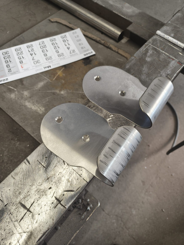

I moved house and am finally getting the garage organised. I wanted to wall mount the QJ but couldn't stomach the cost of the hangers. The cheapest I found them was from the UK supplier (Liftmaster) for £61 posted and it felt like too much.
The boss lady's father is a metal worker. He knocked these together in 30 minutes! I just need some rubber to cover the bottom and they have been bettered for much less. I'll post some pics once they are on the wall.
