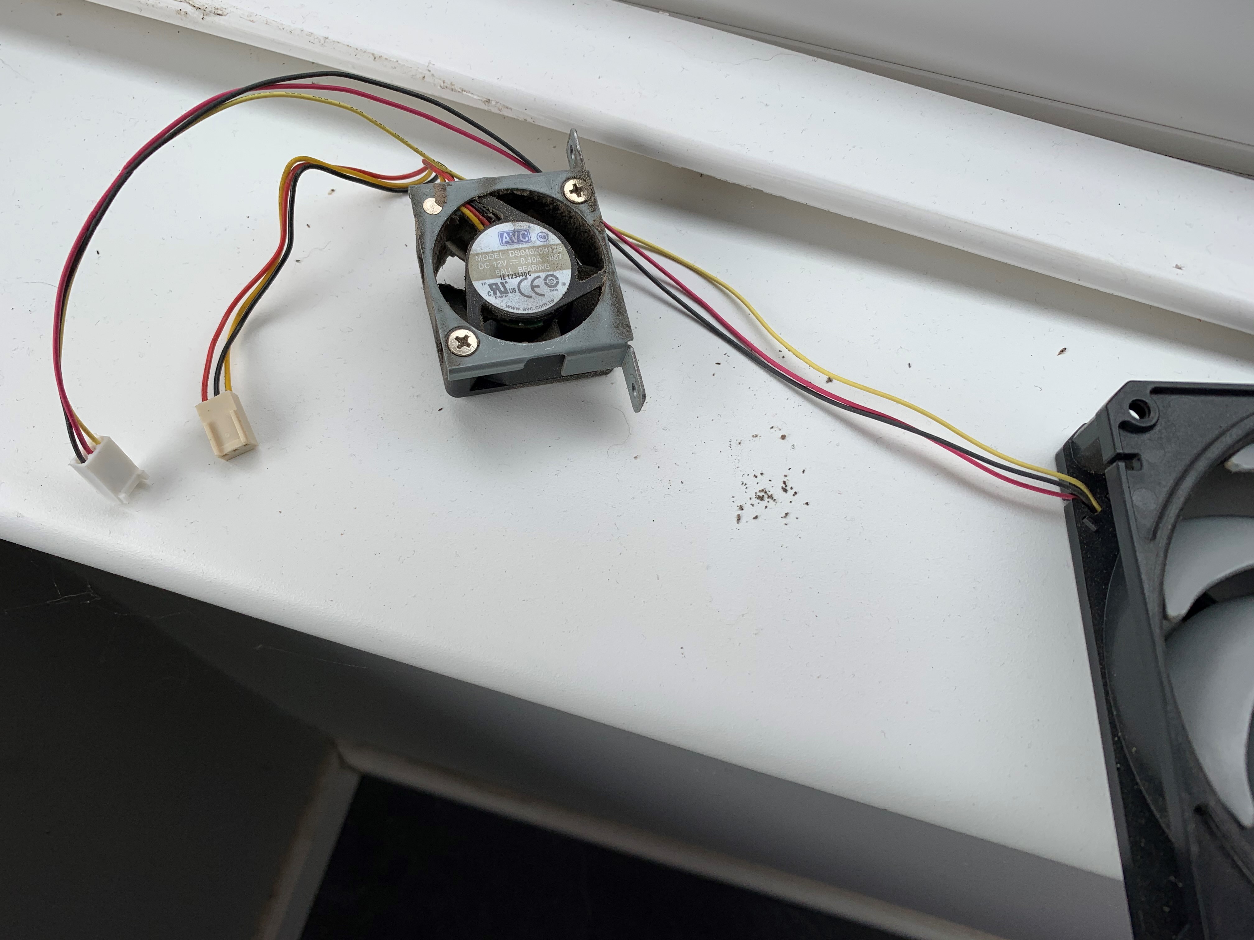

Here is a pic...I have bought a silent switch and its in situ...I took the old one out the cab and took the top off..Looks to me to be an easy swap out of the fans....?

Seems i have used a `fanmate` and cut/spliced the wires to be able to adjust noise/speed of fan
What voltage is the existing fans?
I’ll check in a bit...just got a few things to finish up for work....working from home right now...:)
You should be able to pop the fan's pins out and swap them round as needed
Im going to see if it boots without the fans connected...and then monitor temps....if I can run it passively then bonus...
If not I’m tempted to drill 2 x 120mm holes in the top of the chassis and have two 120mm fans on top, one over the PSU and the other over the heat sinks drawing air out....
I have a 120mm Gentle Typhoon knocking about...
Update Thanks for the input everyone :)
I have swapped the pins over and tested both 120mm...They spin fine and move a far bit of air completely silent.
