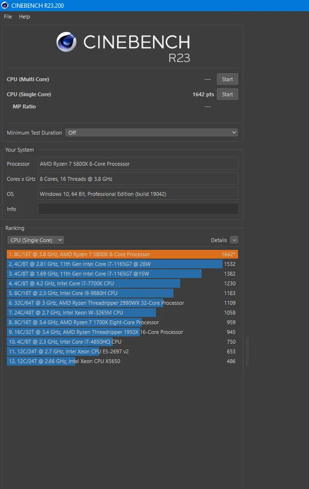

That's easy.
The M1 chips are faster per core than Intel but Zen 3 is faster than the M1.
Not to take anything away from Apple, its impressive, but its says more about Intel than it does about Apple, Intel are falling behind.
I'm running at 4.85Ghz here, the 1165G7 4.7Ghz
At 5Ghz Zen 3 scores over 1700.
Add 15% to this when Zen3D hits, so around ~1900.
