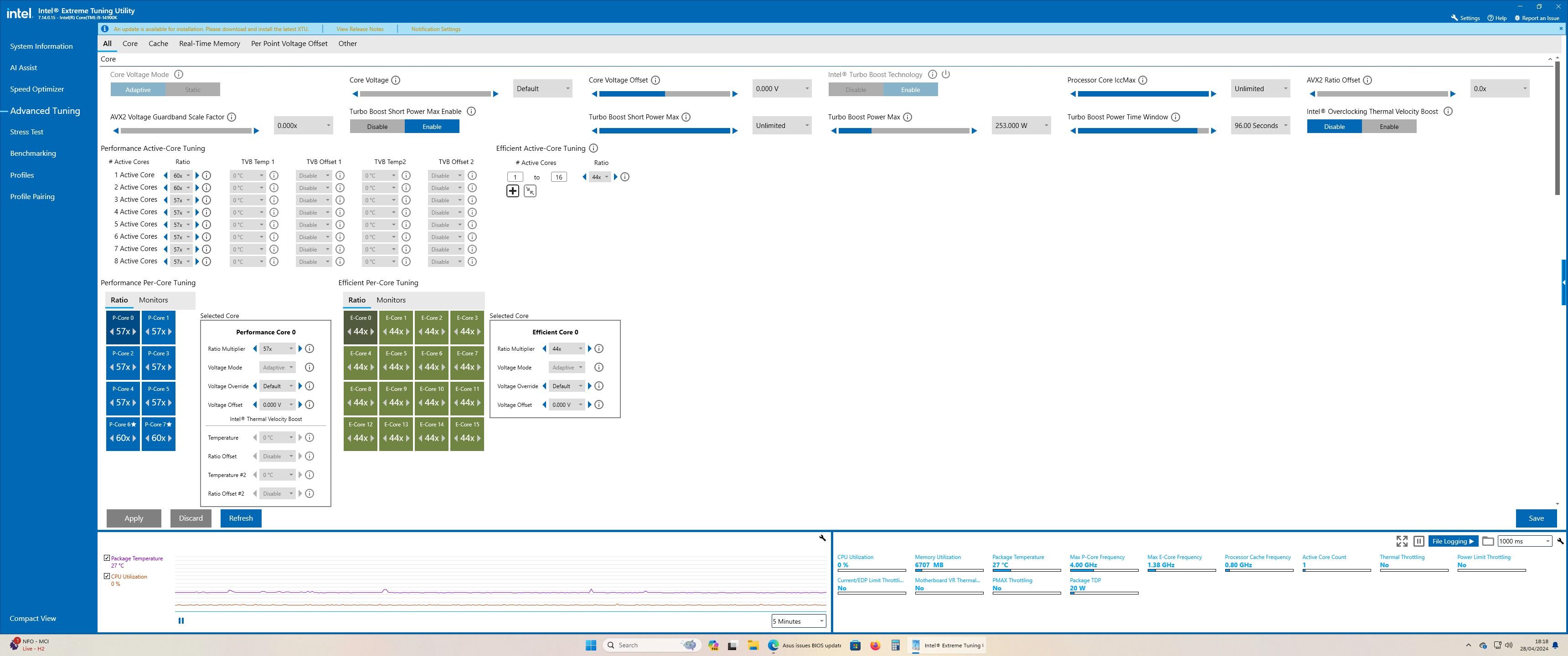

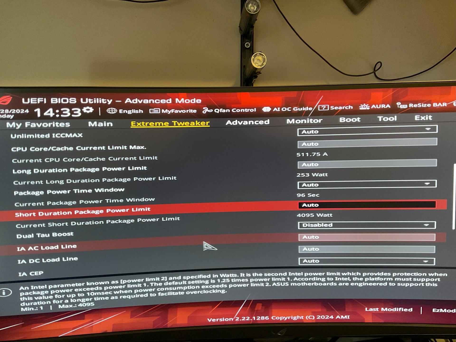

My Asus default powers levels look to be this
PL1 Turbo Boost power Max ( This one is default set to 253watts )
PL2 Turbo Boost Short Power Max (This is the 96 second one which is default set to unlimited power 4000watts)
I taken a screen shot of XTU and have not changed anything
Have you tested it in a multithreaded application? I suspect you'll find it boosts forever if you haven't changed anything since you got the board, but happy to be proved wrong.
I ran some benchmarks when i first built the system but can't remember if it kept the boost up
Am just installing cinebench 2024 again now to see

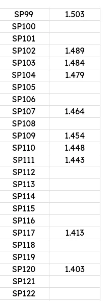

Here's a variation of stock VID tables for P-cores tracked over several 14900K's by a user. Please note the stock VID is factory-fused by Intel.
I just checked and the boost does drop to 5400mhz when the wattage drops to 253watts after the 96 seconds
Hmm, from what I can gather, your CPU is both, it is limited and not limited.
In the manual, Asus say:
- The long duration limit is treated as equivalent to PL1.
- The short duration limit is treated as equivalent to PL2.
Your BIOS has set no power cap set for PL2 (4096 watts), but after 96 seconds it will revert to PL1 (253 watts).
The Intel spec says that:
- PL1 is 125 watts (K) or 150 watts (KS).
- PL2 is 253 watts.
- The recommended duration of PL2 is 56 seconds.
So, you are exceeding PL1 by 128 watts and PL2 by an unlimited amount, depending on the application.
A closer to stock configuration (since Intel consider an infinite PL2 boost as stock) would be to set:
- PL1 to 125 watts.
- PL2 to 253 watts.
- Package power time window to infinite.
That said, if you aren't having any stability issues then there's no need to change anything unless you want to.
