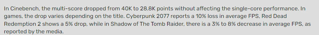

Every reviewer Including Steve Burke who accuses AMD of lying about TDP for going 5 watts over has these things scoring around 40K points.
Not only are they becoming unstable as games are increasingly hard on the CPU but they are probably also slowly cocking themselves and Intel offer a 3 year no quibble return and replace warranty service.

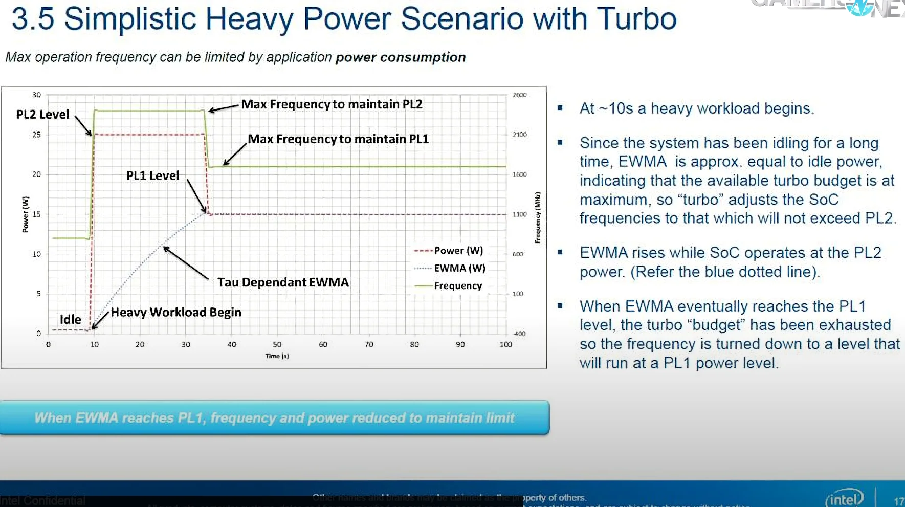

for a few seconds
The duration is what I was referring to in my earlier posts: TAU.
TAU is not limited for K CPUs since 12th gen, so that's not an overclock according to Intel (they recommend, but do not require: 56 seconds), but there are multiple other settings that are being applied that are overclocks.

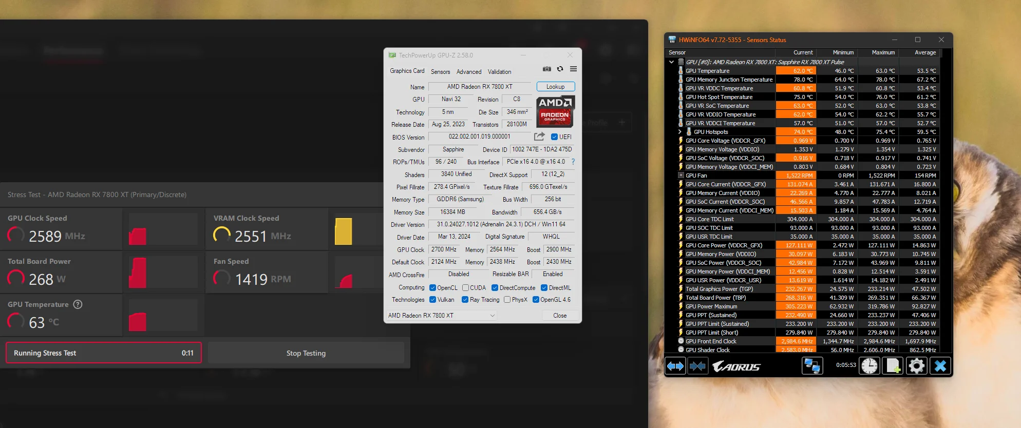

Take my GPU as an example.
Its an MCM GPU so i'll explain what on the GPU die and what isn't.
In MSI OSD AMD report the total board power, that's the core, the MCM chips, the power stages, the Memory IC's, the fans.... everything , it has a TDP rating of 260 Watts, i've never seen it pull more than 250, usually around >240, stock.
GPU Core Power: 127 watts
GPU SoC power: 43 watts
GPU USR Power: i don't know what that is so i'll add it here: 14 watts
That's it, 184 watts total. that die is 200mm
The rest.
GPU Memory Power VDDIO: those are the IMC's: 30 watts
GPU Memory Power VDDCI_Mem: memory IC's: 12 watts
The rest to make up the 268 watt board power draw (its overclocked) will be board components not listed, which includes the fans.
So 184 watts for a 200mm die (This is overclocked) here the GPU is running at 63c, its a good cooler.
The 14900K is 250mm, its pulling 287 Watts in Blender, 200 watts in Cyberpunk, holy ____!

Intel's 13th/14th gen datasheet (* see below, page 98) states a recommended TAU of 56 seconds for 125 watt (i9 K) and 150 watt (i9 KS) CPUs.
But like I said earlier, that's just a recommendation and an extended turbo is not considered an overclock/out of spec:
(Turbo Time Parameter - TAU, p78)
"During a maximum power turbo event, the processor could sustain PL2 for a duration longer than the turbo time parameter."
I didn't watch the video you linked, but it is from 10th gen and the PL1/PL2/TAU rules are not the same for 12th-14th gen. Anandtech's platform articles are usually the most thorough and they include an Intel slide that shows in the graph that it can have infinite TAU:
Intel is now so confident in its turbo performance, that the new K processors have a default guideline of an unlimited turbo.
