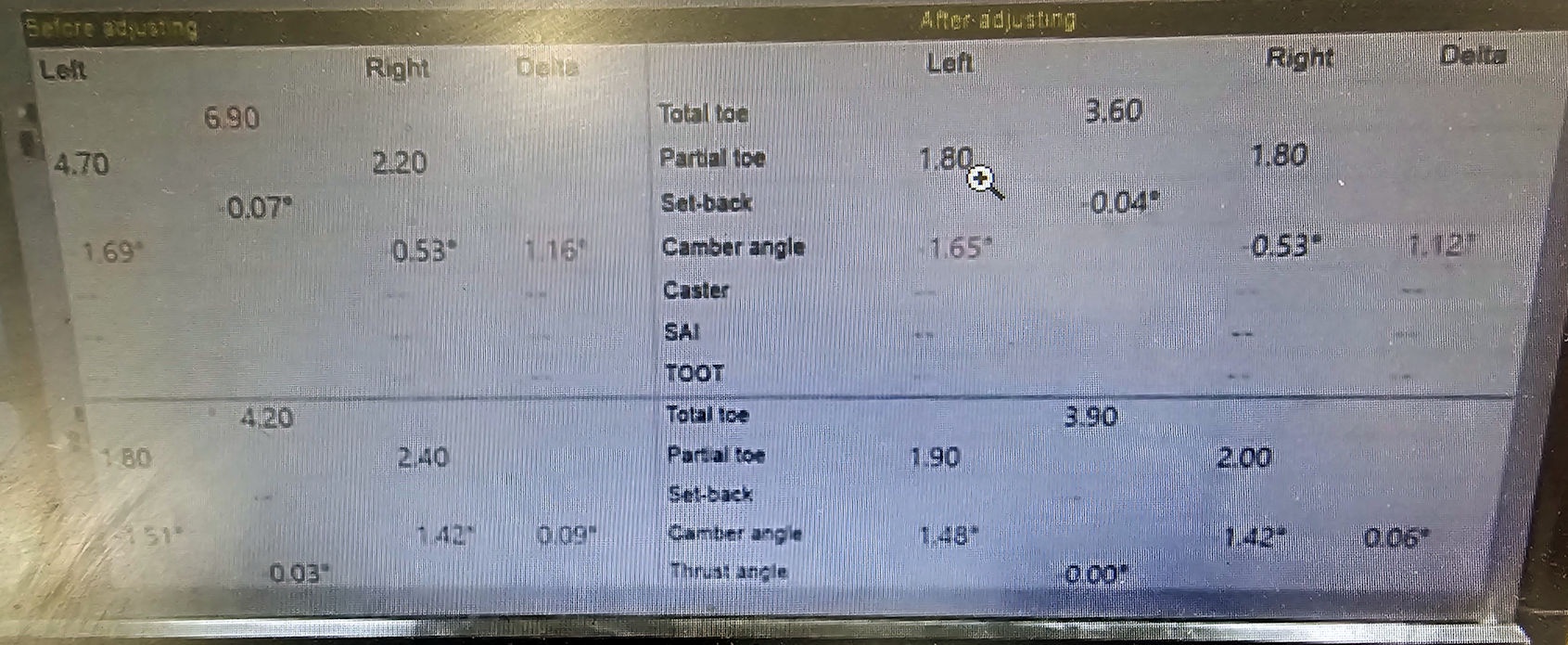

Get a free alignment check at kwik fit or similar, as this is not normalMy 2015 A7 BiTDI seems to be chewing through the inner side of the front tyres - more so on the left than the right. A couple of garages have said that it is normal due to the camber but if that was the case then would the wear not be roughly even? The front tyres are just over a year old and have done around 11k miles - I can see threads all the way around on inside edge of the nearside front, whereas the offside front looks absolutely fine.
I wondered if alignment/tracking should be checked, but surely garages would have suggested that?
What do you guys think?
Thanks for the suggestion. Just managed to book one for 12:30. Will report back shortlyGet a free alignment check at kwik fit or similar, as this is not normal
They confirmed that tracking needs to be done for the front wheels. Thanks againGet a free alignment check at kwik fit or similar, as this is not normal
They confirmed that tracking needs to be done for the front wheels. Thanks again![]()
Make sure the lower rear suspension bushes are in good order. The original ones are oil filled, they split and give lots of movement knocking the geometry out.

I did ask them to check for other potential issues and was told that there was nothing obvious, but have no idea what was actually checked. Is this something I should get checked sooner rather than later, or can I just see how it goes?

The Left Front Camber would ideally need looking at if you want to get picky, being 3x higher than the right side, so the top of the FL tyre is pushed "in" more than the top of the FR tyre, which will increase the inner edge wear on that FL tyre slightly faster than the FR one.
On the A7 the camber is a set/static figure but it is adjusted via the whole subframe being moved (not by individual arms) so in this case both sides should read close to -1.1° but the subframe is probably shifted slightly to the right so the right side has lost about 0.6° (dropped to -0.53°) and the left side gained about 0.6° (-1.65°).
Shifting the subframe is a bit of a bugger of a job for an "normal" garage to faff about with compared to the extremely simple "adjustable arms" version, so its mostly likely the garage who did your alignment didn't try to fix this. If you really wanted it sorted I'd estimate it'd be about £100-150 which is a lot for something something that, whilst it IS out, isn't so far out that it "needs" doing immediately. I'd leave it a few thousand miles and check the tyres again to see if there's any noticeable difference in wear on the inner edges again.
