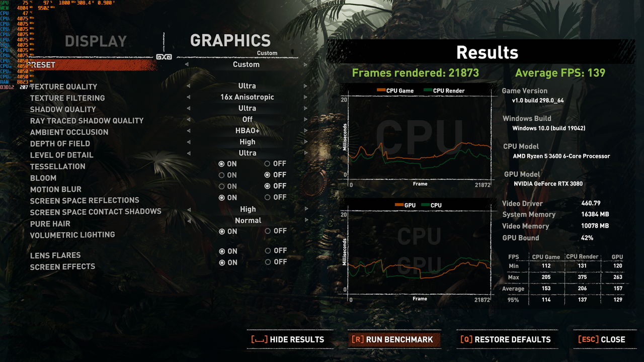

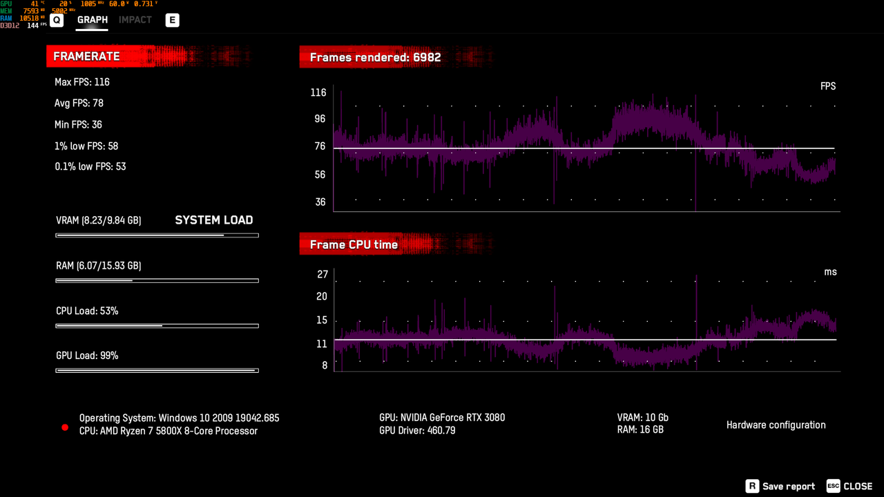

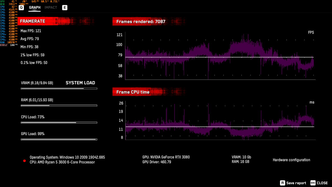

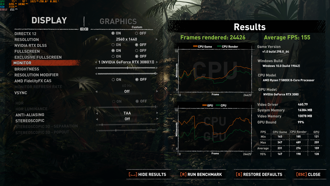

Just for reference this was the difference I found when jumping from a 3600 > 5800X with an RTX 3080 and as you can see even with a strong GPU it goes from small to no difference at all.
tomb raider 3600
tomb raider 5800X
Then in watchdogs legion 3600
5800X
