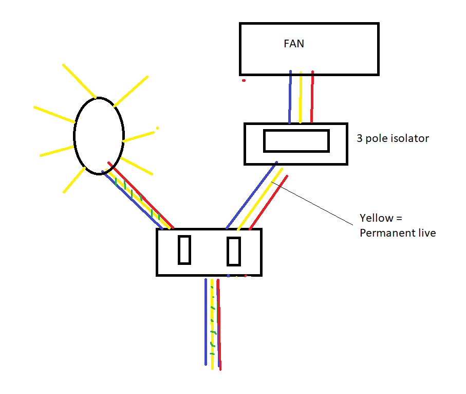

I can either hook this up to lighting circuit - but I use Hue, so the switch is typically "on". Are there other methods I should be aware of before I pull the plug on the timed unit? I don't think the Humidistat ones are too reliable are they?
Chaps,
Need to pull the trigger on this but unclear on best approach.
My light is normally always on because I use Hue. Do I just run a separate switch or is that really daft?

I have hue in both bathrooms and have the extractor fans on their own feed off the lighting circuit and their own switch.
Cheers - just a separate pull cord? I just know I'm going to have to moan at everyone to use it lol. I guess it means you can use the bathroom without the fan out, when that is appropriate.
Na wall extractor or window extractor is like a horse and proper inline extractor is like a car. I don't want to bodge a bit hole into my lovely insulated house that bleeds cold air in.
The roof tiles idea is because I have a hipped roof so no wall.
I've since discovered a nugget of flat eave tho so I'm golden :)
The main bathroom fan is on it's own pull cord, and the en suite has a double switch outside, one switch for the lights and one for the fan. I didn't want the fans to be reliant on the lights being on, and the other way too, the fan being on when it wasn't needed.
The downside to the pull cords in the main bathroom is visitors keep turning the hue lights off!
Edit: tracked down the diagram I followed, near the bottom of this page https://www.diydoctor.org.uk/projects/timed_fan_unit.htm
