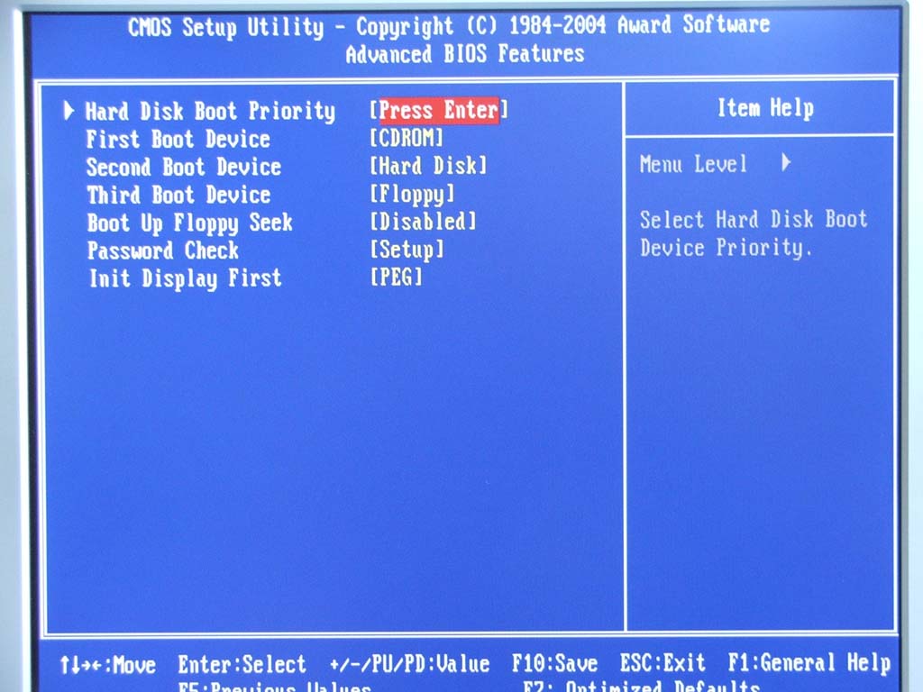

So what is your boot order?
this..
Me thinks if your not seeing the hard drive at all in the BIOS somethings not right.
boot order is:
HD bootpriority [press enter]
first boot deviec [floppy]
2nd b d [HDD]
third b d [cdrom]
boot up floppy seek [disabled]
password check [setup]
init display first [peg]
