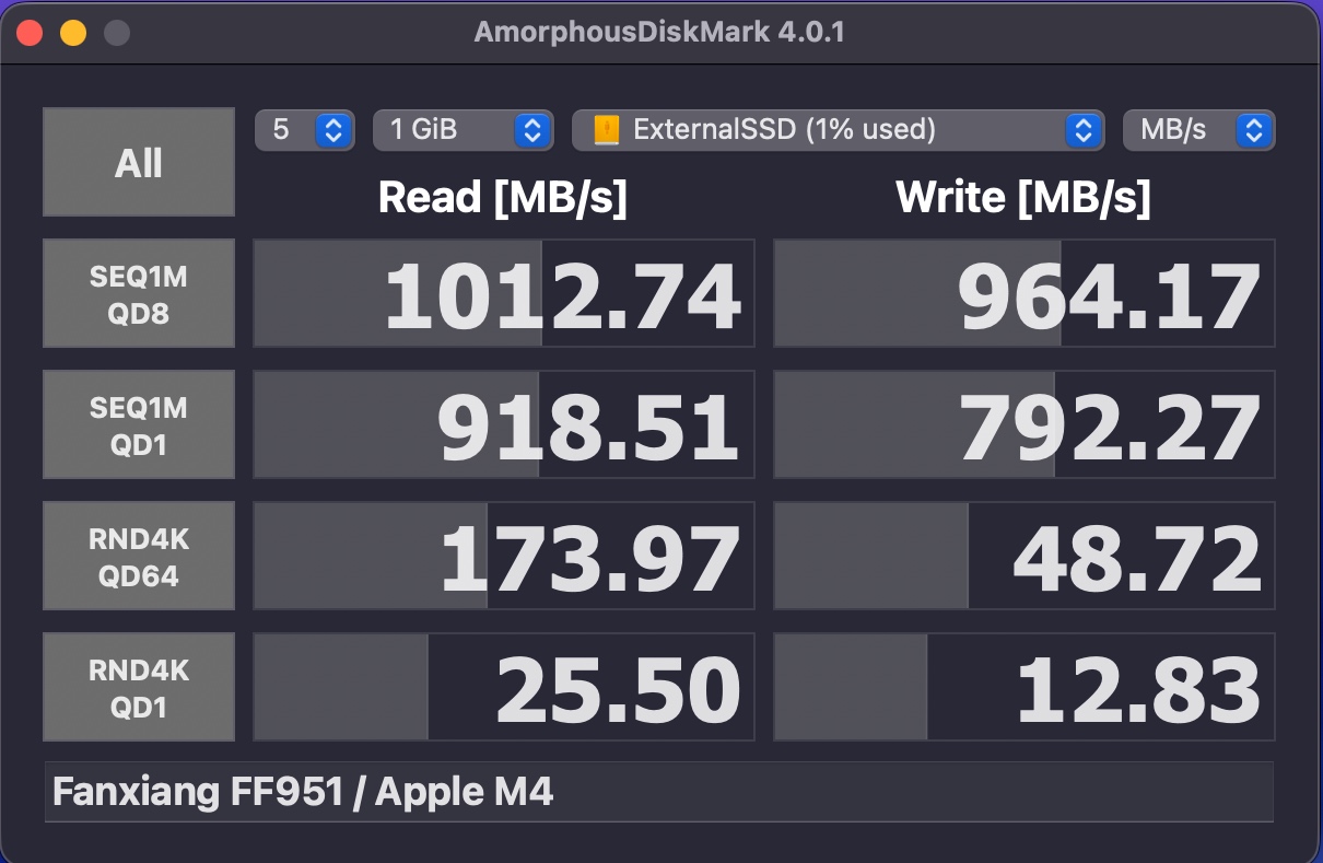

The all important speeds...

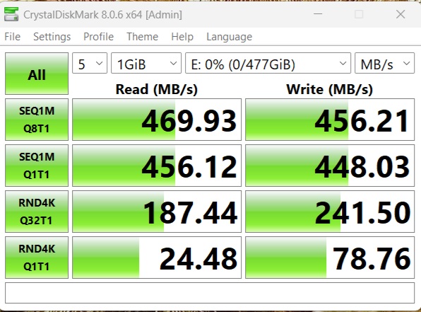

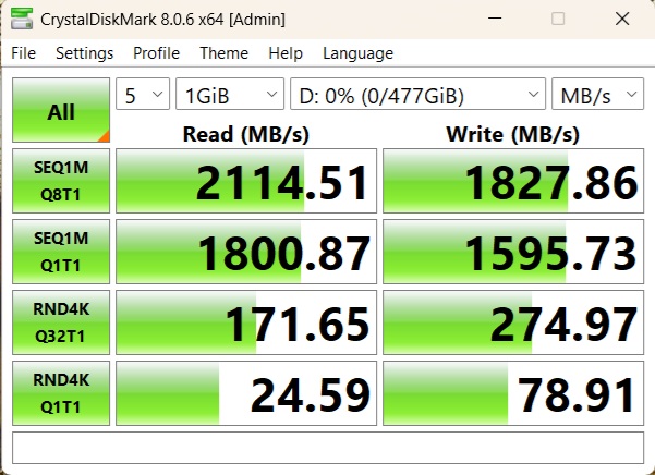

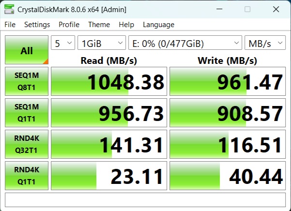

Connected to USB 3.2 Gen 2x2 20Gbps Type-C port...
Connected to USB 4 port...
Connected to Thunderbolt 4 port...
Connected to USB 3.0 port...

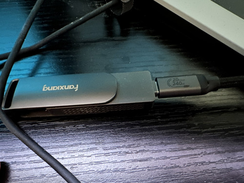

Bought a Silkland 20Gbps USB C Extension Cable 1M USB 3.2 Gen2x2. The USB 3.2 Gen2x2 port is at the back of the PC which is on the floor meaning I had to keep pulling it out each time I wanted to plug something in or out. This extension cable brings the port to desktop level making it easy to plug things in and out.
