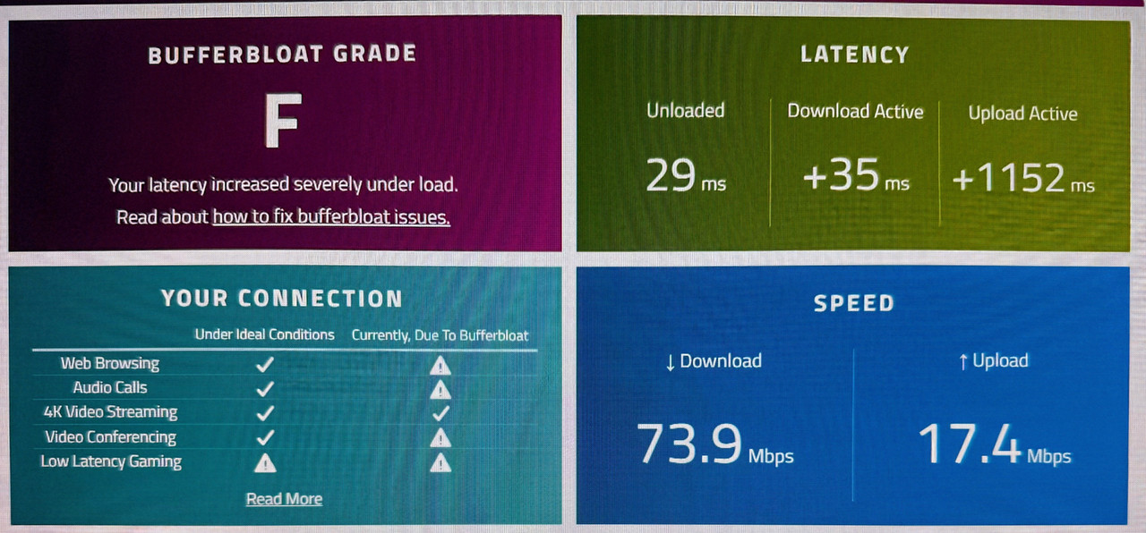

So my brother on a fixed line broadband package is having terrible latency on his upload data. It is repeatable and consistent. His download latency looks fine to me.

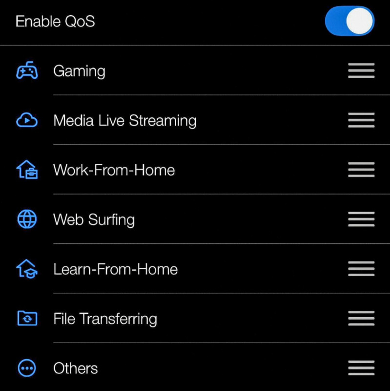

He has QoS enabled as such, which I thought being enabled would help with bufferbloat? Unless this ordered list needs adjusting in someway?
His result is shown below.

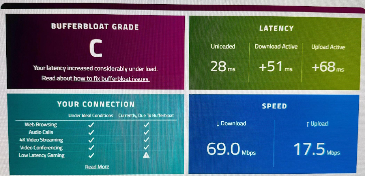

He has changed it from auto to manual (QoS) and fixed the speed as suggested. Here is the new result. Upload latency has much improved!
