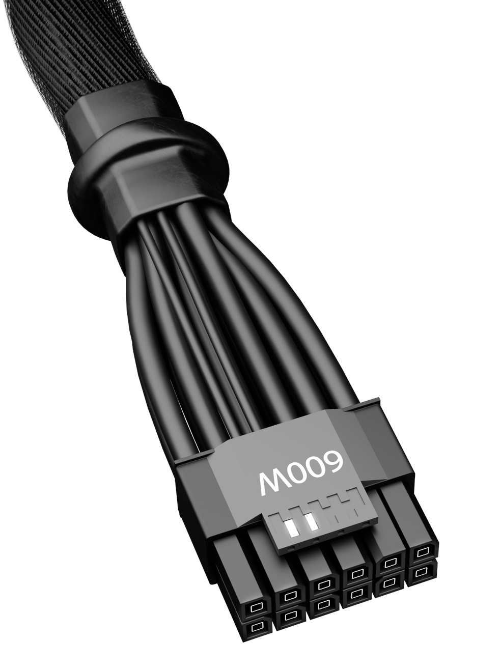

Ah good shout, I read up on ATX3 PSU's this evening then added the Corsair/removed a be quiet! and forgot to remove it from a previous basket.
Cheers for taking a look.

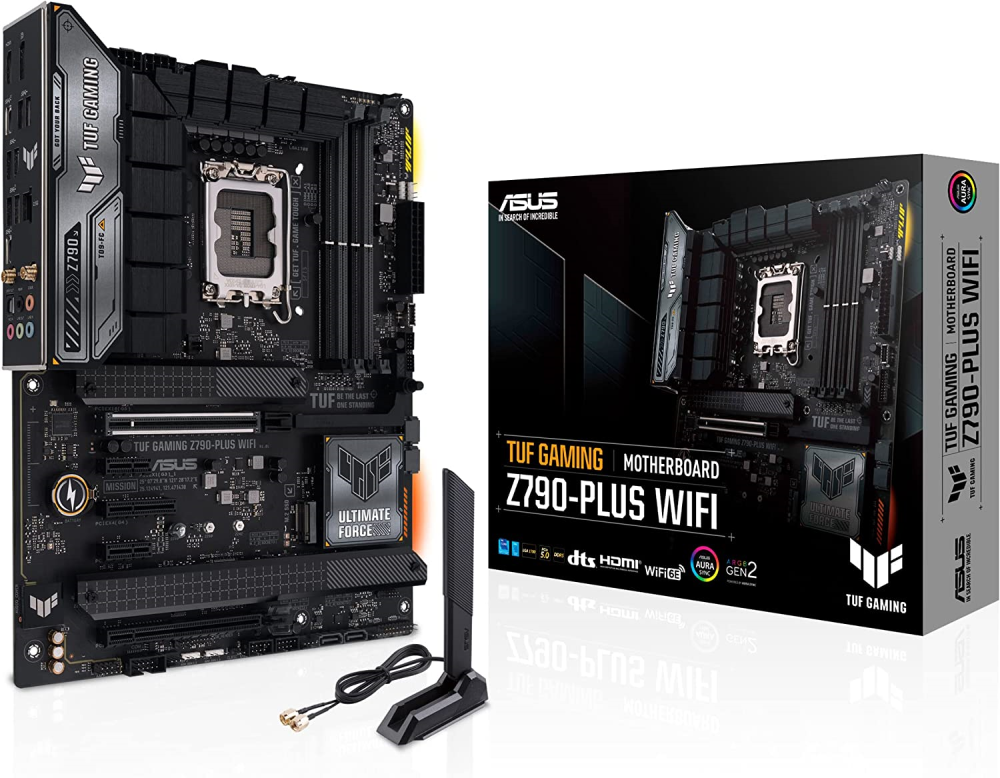

Intel alternative just for fun:
My basket at OcUK:
Total: £2,862.90 (includes delivery: £7.99)​
You can see how they compare here:
Unless you're using stuff like blender, unlikely to offer any advantage. You can see benchmarks on that kind of app here.

Yep, in the Corsair Carbide Air 540 the PSU is mounted on it's side, so the connectors will face upwards. At least, that's my understanding of it :)
Yes that's correct I just checked they face upwards , I didn't want you buying a PSU with the connectors facing down.
Would have made your build interesting though :D
