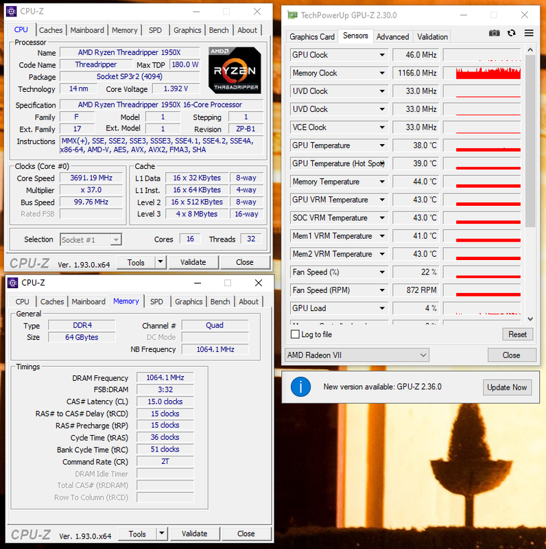

That memory is running at 3500? Without xmp you should be at 2133. I would turn of DOCP/XMP entirely so you run 2133, test for stability and tune from there.
Edit: or is that GPU memory? Yes it is... can you show us a pic of cpuz like this?...
Would just be interested to see what's what.
As others have said you need to start with the memory at 2133 or whatever stock is on that board and go from there.
Leave timings as they are and just lower the speed.
