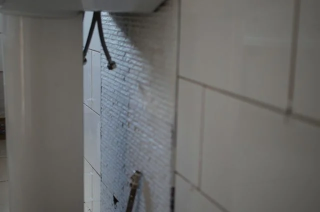

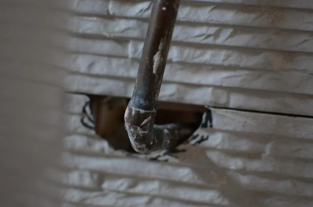

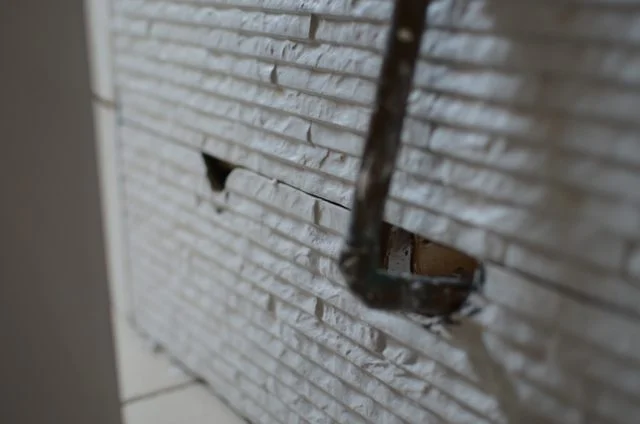

I came home to check on the progress of the bathroom in my loft conversion and the feature wall behind the sink where the water pipe comes out from looked like this:
Not only did he manage to **** up the hole but he made another hole for no reason at all.
I paid to have all tiling done and I supplied the materials and I've not seen such an amateur **** up for a long time. I'm not a happy bunny, as these feature tiles weren't cheap. :mad:

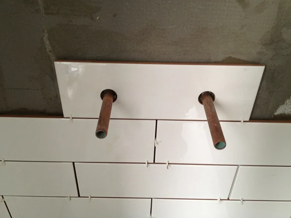

This is how it is meant to be done:
http://ukbathroomguru.com/how-to-drill-holes-in-tiles/
I don't quite get what I'm looking at - but it looks unfinished (ie not tiled).
If it is tiled, then yeah, that looks to be a very poor job. No way I'd be happy with that, even if it is hidden behind the sink.

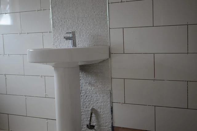

I have a pedestal type standing sink. Maybe in my anger I didn't get my post across correctly but the hole is in the wrong place completely as well as his skills in cutting a hole for the pipework. The builder that did the tiling also did the plumbing, now my confidence has been knocked completely.
As you can see in the picture the pipes should come out near the top that join into the tap's connectors.
That really does look bad. Your conversation tomorrow will be interesting.
Yes that looks poor.
What tiles? At first I thought it was the adhesive :p
Not every photo has to be sharty it's quite difficult to get a perspective.
What am I looking at here?
He appears to have deliberately cut the other tiles around a vertical area behind the sink, and then made the adhesive level with surrounding tiles?
Pedestal sinks normally have the pipework hidden inside the pedestal, not coming out of the wall behind them.
Assuming the pipe is for the hot and cold feed to your basin. However can't see the hot probably where the hole is. Need a picture of the whole area as a close up could actually make it look even worse.
Are they not fancy textured tiles that go up in a vertical line? Can see why people think its adhesive though :D.
Does look scruffy, but it's easy enough to rectify once you tell him you're not happy.
What do you mean by 'hidden inside the pedestal"? The taps need to connect to the pipework and with the way he has done it if he chases the pipe up along the pedestal then there will be copper pipe showing from the bottom base and it will look crap.
The proper way to do it in my book is like this
http://www.homedepot.com/c/seven_steps_to_install_a_pedestal_sink_HT_PG_PL
Look at step 4-5, once the sink is attached the pedestal will cover up the pipework.
Lol it's not adhesive people. :) That's the tile that he has butchered
Pedestals are a C shape, if you are neat you can run the waste and the two pipes up inside that alcove.
Either is good, I just reckon the former is less visible and doesn't require chasing out a wall.
it's not adhesive people, that's the tile that he has butchered
I did wonder, but couldn't figure out why the tiles either side of that section were smooth? :confused:
Ah I see what you mean, mine is a narrower C shape which doesn't reach the wall, if it did then I could see how the pipes could then hide behind the alcove.
Tiler has been sacked, contractor said he will fix it and even told the tiler if he needed his cutting tools to do the job properly before carrying out the work, which he refused.
We have the staircase guys in today doing finishing so the bathroom won't resume until next week. As for my confidence everything needs to pass local council building regs, so he told me not to worry. We've already had the council visit twice and pass both stages of the build but there is one stage left and when the work is complete they will check electrics, fire rating stuff etc.

A better picture showing perspective of the situation
