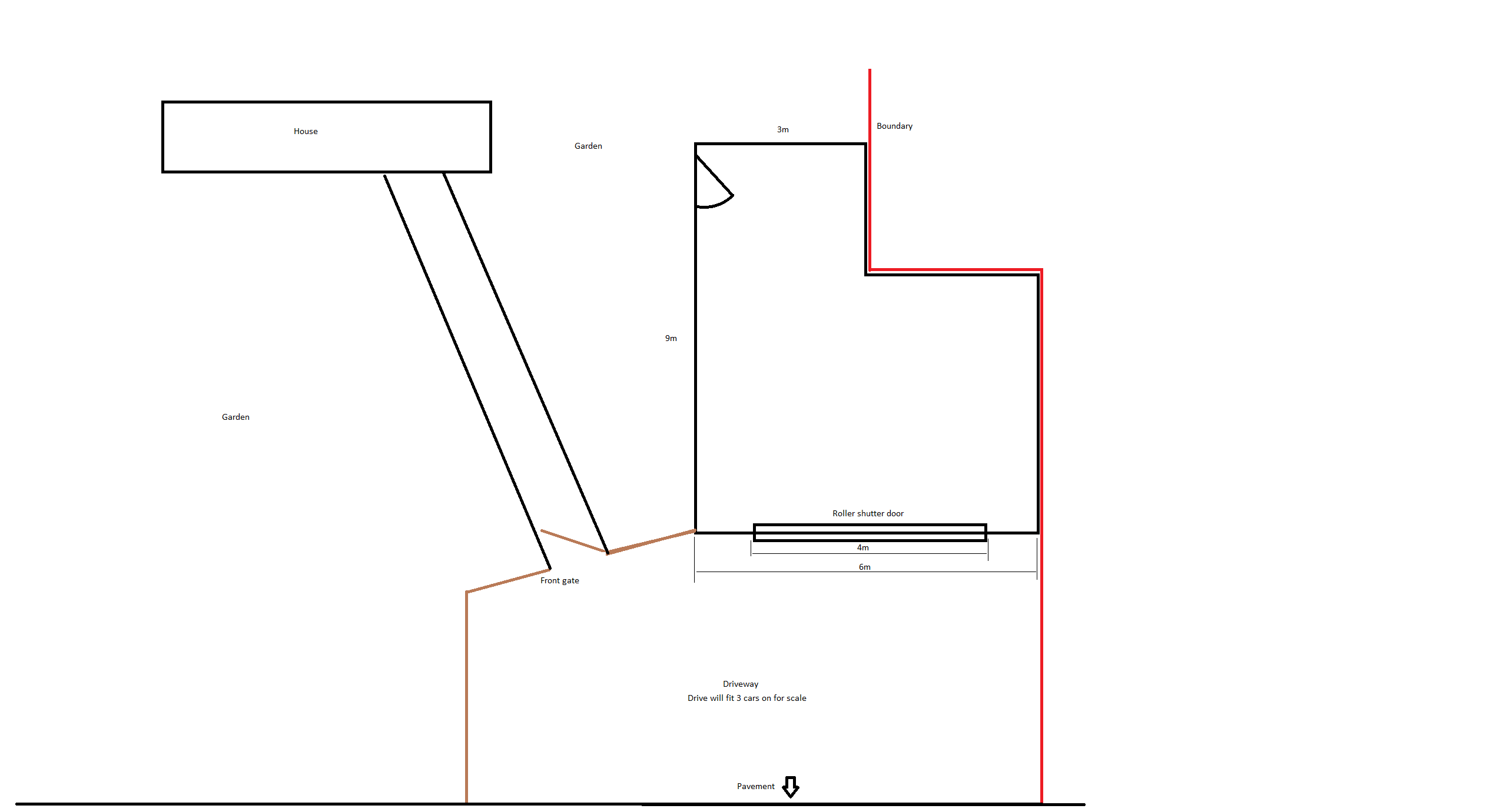

Edit... I'll knock something up in paint
I didn't really want a brick gable end, so a L shaped hipped roof
I guess the other option would be to have a steel spanning the front door with another steel running the length?

Looking at your picture, you would do well to price up a steel frame and roof as it probably wouldn't be much more than traditional double skin block and timber roof. You aren't far off the footprint of a 2 bed bungalow.

The roof for this would be no problem at all in standard trusses, if you wanted to add a vault to it would add cost how much would depend on the raise you where after. If you had a gable end getting a large vault (500mm+) shouldn't be much of a problem a vaulted hip roof is harder/more expensive. To make Attics worth using you would really need a gable end and steeper pitch the amount of useful space with a hipped attic would be very low for it's high cost. I had a little free time before I left the office this afternoon so I sketched the roof out as a standard hip and with attics.
Attics would be approx double the cost before other extra costs such as floor coverings.
I have put a basic model under this link https://skfb.ly/6KvNw
annoyingly this model viewer doesn't take note of overhang cut offs so it shows the flying rafters sticking out the roof, these would be trimmed to the hips when installed.
