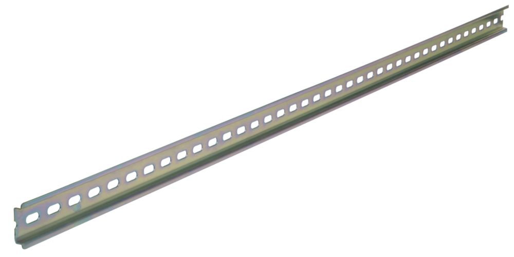

Yeah I'm still struggling on the lid though. I wanted a slotted metal bar with a wingnut, but can't find it.

Screwfix have some threaded cover, cheap, not too thick, 6mm holes I believe. Think people say 5mm threaded rod (or bolt is perfect)
I would use something like that if you don't want to make wooden rods.

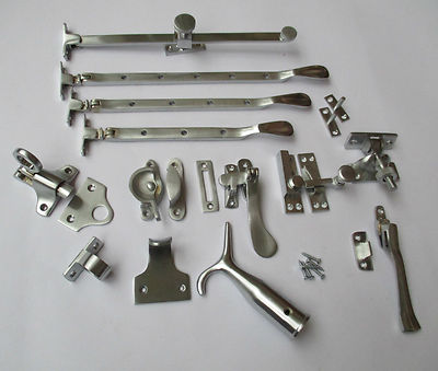

For the top you want either the
Screw down stay or the casement stay arm in this link

Ah yes old fashioned window stay looks ideal. Normally mounted horizontally rather than vertically in my case but should do the trick I think.

I would be careful with window stays unless the area is sheltered from wind.
I have had them fail twice on polycarbonate windows as they are so light.
Thats why I now use a pegged stay.
Was different with old glass greenhouses.
Its why your idea of slotted bar with wingnut type thing is better IMO.
You just use something like this to hold it up
Get one to fit through the holes in the stay and get a wing nut to fit it

I've gone for cheap black casement stays. Not too bad, bit awkward to find a spot to fit them, would have preferred them on the inside I think but not enough room to mount them on the frame.
They'll do the job but I'd only rate them 5 out of 10.
