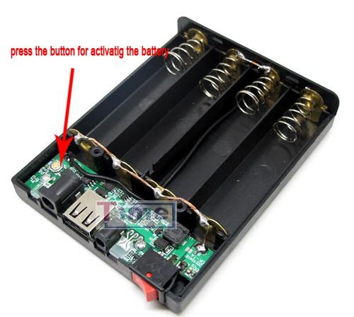

"5V Mobile Power Supply USB Battery Charger 18650 Box"
£9.57
basically your circuit as described, but cheaper than you can build it.
Interesting design there bitslice. Have you got one of these?
18650 cells as with all Lithium-ion cells need to be treated with respect. They are not like an eneloop or standard Ni-Mh rechargable, definitely not as forgiving.
Lithium-ion cells can be dangerous if mistreated. Especially so when wired in series during charging and discharging. I would not recommend anyone buy that unit unless they have extensively read up about lithium-ion cells.
I also wouldn't put much faith in that circuits ability to cut off the charge at 4.2v per cell. As the unit is wired in series you would need to ensure the cells are the same voltage before even placing them inside that unit. From the looks of it the two banks are wired in series giving the circuit 8.4v? It is an interesting design none the less!
But the more I think about it, the more that product worries me. If used by someone that is doesn't fully understand the dangers of lithium-ion cells it could end badly.
