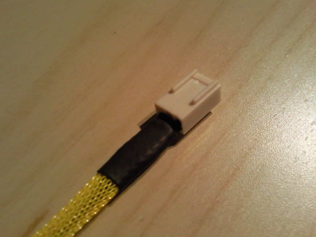

I advise taking all connectors off then braiding as you can get a much better finish, unless of course you want to shrink over the connectors also, but you'll find that if the heat shrink is wide enough to go over the connector it's too wide to get good shrinkage on the cable.
Modded one myself along with a few other cables
The way you have the black 8 pin connector mate is the way i was considering using the cable ties, looks very secure, ill probably take the connector ends off as it would be to much hassle trying to get the shrink tube over them, and like you say the tubing wont shrink properly then. Thanks for the advice guys.:)
