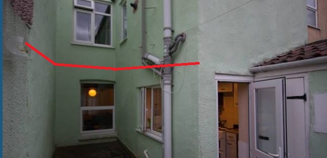

Can some builders/experts review my extension and quote?
Yes skips are on the road, no front garden remember :p.
To picture it a bit better, you can see the side return space below along with the adjoining window and room that that access will be through.

Is he 100% certain he cant get a micro through?
Its been some time since I worked for toolhire company but when I was there I am sure they had machines designed to fit through a standard doorway.
IIRC the smallest models were walk behind, a micro digger and micro dumper
I wouldnt be wanting to take them through a nicely decorated home, but if its work in progress you may be ok.
Looking at your pics some look narrow but that could be camera as opposed to actual width
Here found this for you, he wont own one but surely could rent one
Both digger and loader fit through a normal doorway
Its better than digging by hand
http://www.rent-this-digger.co.uk/
A small machine won't be much use at breaking out that slab. By the time it's all broken out and removed there's probably only a small footing to dig, probably a days work for one man. It took us a weekend to dig a double garage footing by hand 900mm deep and load into skips.
I'm not 100% sure on the definition of a cavity wall. I assume it means there's a hollow cavity in the middle? Either way the rear wall (large window) is stone (that wall is about 16-17" thick), as is the left wall up to that height and then single skin brick. The right hand wall is brick also but from the ground up.
Best check with the builder as too how he is going to support the stone wall as I dont think acrow props and strongboys are up to the job.
