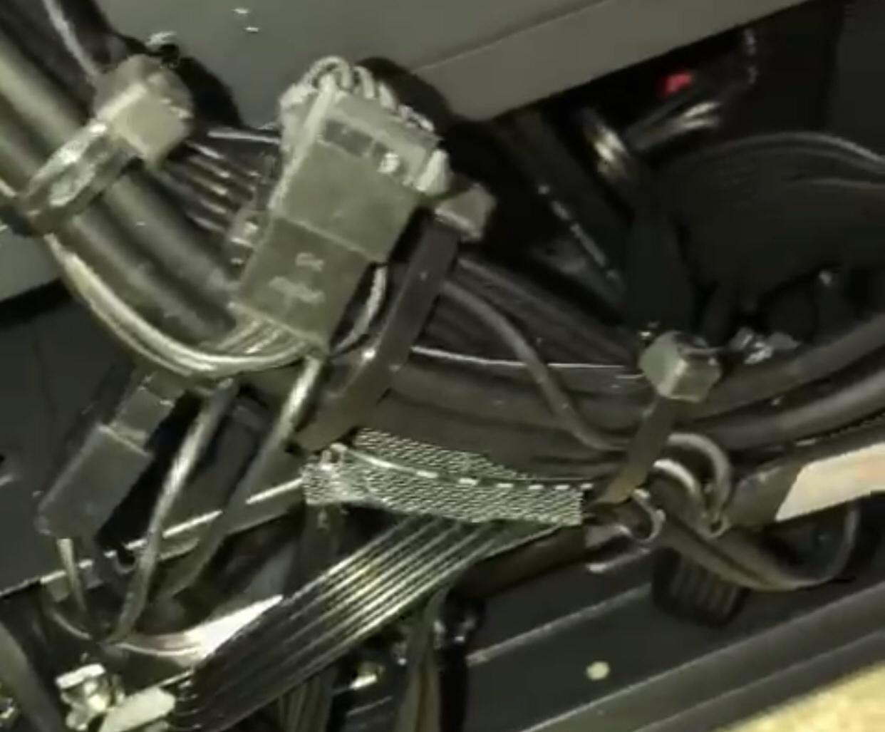

Do you not have anything bundled with the PC? No boxes? If you have a modular PSU, they might be wrapped up somewhere.
What's the case? They could also be cable tied behind the motherboard, between the panel and the tray.

I cut lose all the wires behind the motherboard and everything seems to be used unfortunately.

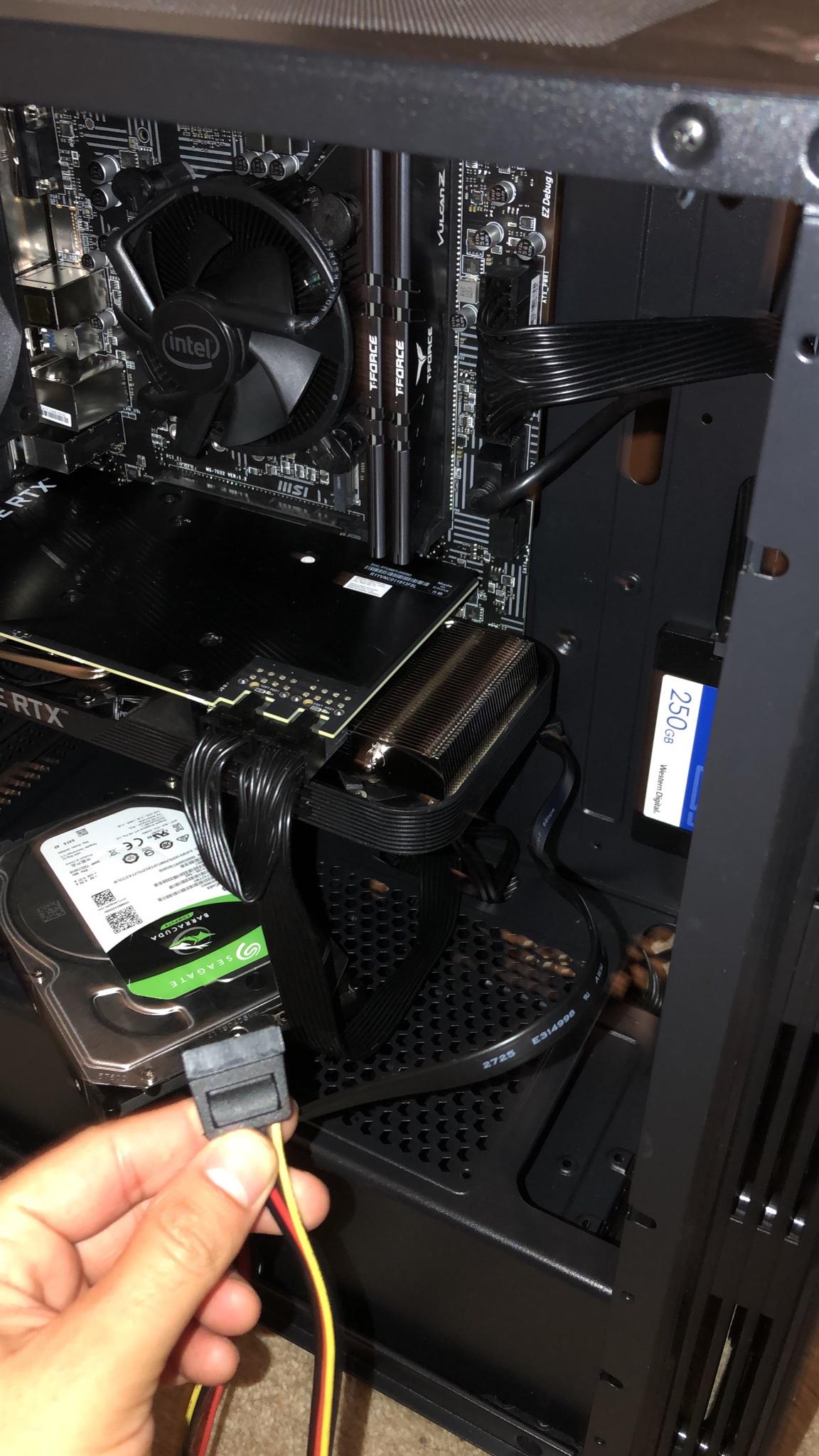

I have one of these but can’t find a place to
Plug it in at all‍♂️

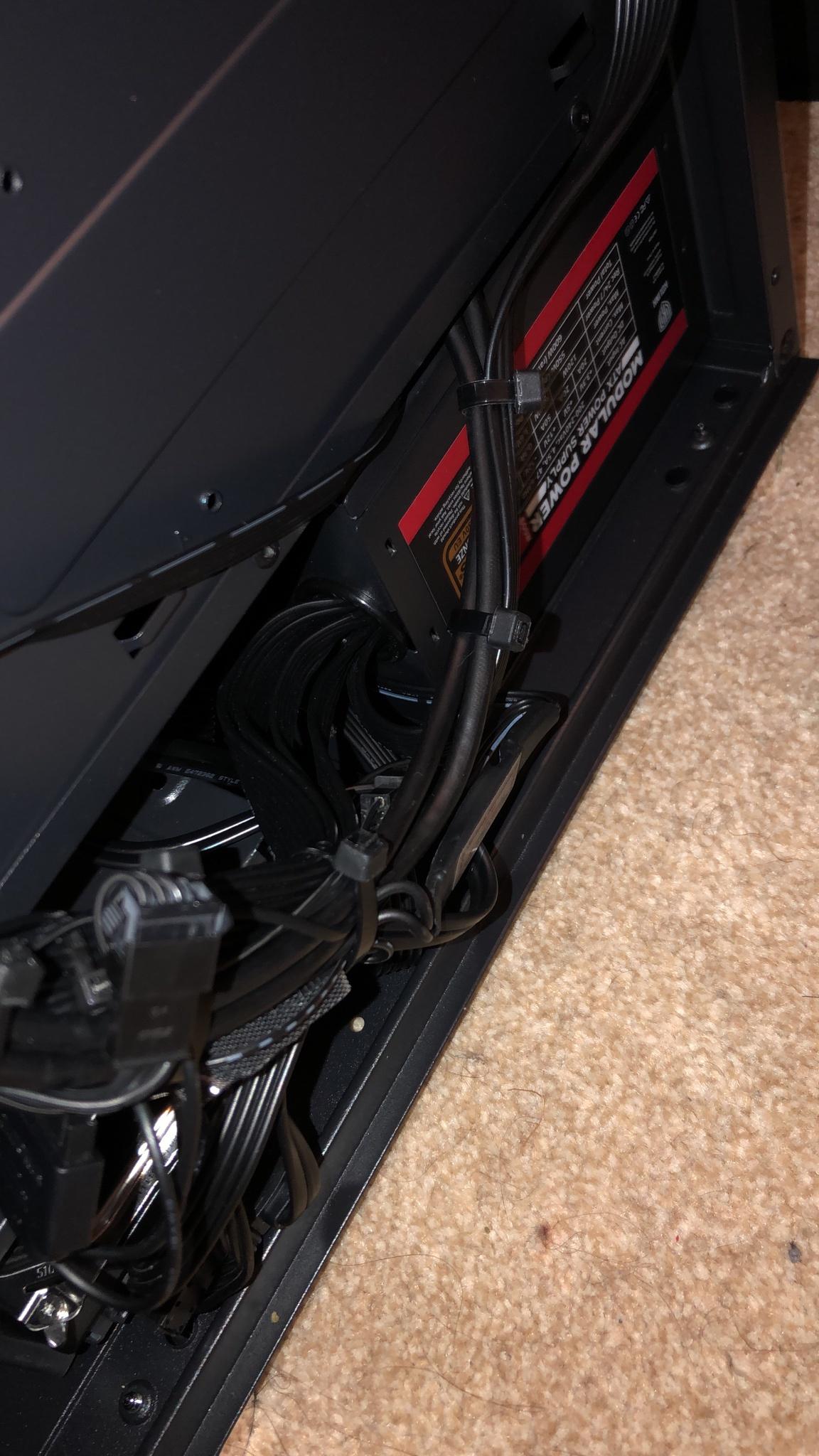

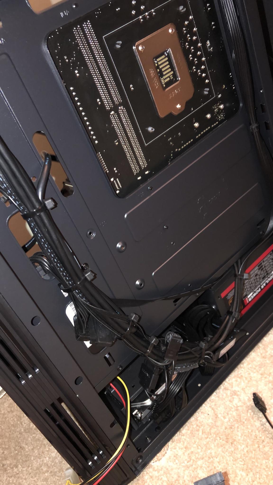

Take a picture of the insides of your PC and upload it on here
In that first picture I see a 4 pin white Molex connector hanging out the front of the case? Where does that go to? It looks like it goes in and up to the fans?
If you literally have no connectors spare then you need to buy a cable which basically plugs into one of your molexes, extends it so that it keeps on going, but also spurs out a new connector as well. Like this 1 to 2 extender:
Or, just buy an external 3.5 inch hard disk drive caddy which you hook your hard disk up to inside and then plugs into your PC via USB.
That was just one I had from my old computer I was just putting it in my pc hoping for a fit.

So it's lack of power connectors that are the issue?
I've actually just paid out for something like this which is actually a cheaper option than an enclosure (and has capability to access 2.5" sata and even old IDE drives, which is why I have bought one)

So is it just a lack of a spare sata power connector? You could just swap out one of the used sata power. From the pictures it looks like one might be powering an rgd or fan controller. You try one of those and just live without lights for a little while
