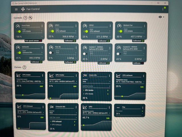

There’s free software called Fan Cantrol and it’s amazing. There will be no better solution, I promise :p
You press a button and it detects all fans in your system, working out the min / max speeds etc. It’ll even detect things like your motherboard VRM fan.
It then allows you to set your case fans to monitor CPU and your GPU together (!) - you set up two seperate curves and it then follows whichever is hotter:
Toasty CPU? Case fans increase.
Toasty GPU? Case fans increase.
You can even do the same sort of thing for your CPU if you want. You can control your GPU fans as well if needed.
I know it’s a sin to take a photo of a screen but this was taken before I potentially nuked my computer… and it’s what I have to post right now (on phone). You can see how I’ve set two curves for the intake fans and exhaust and then set them as ‘intake mix’ etc.
Just in case you are eagle-eyed: my front 3 intake fans are hooked up to a hub and use a single header attached to the motherboard. Neither my motherboard nor Fan Control can detect the live RPM of these fans. But this doesn’t really matter because you can still set the RPM % to suit.
Finally, you can also fine tune how long it takes for fans to ramp up and down (to avoid being sensitive to micro spikes) and also set delays to stop fans ramping down too quickly if there’s still toasty air in the case.
Overall, I think this software is amazing.
I hope this helps! :)
