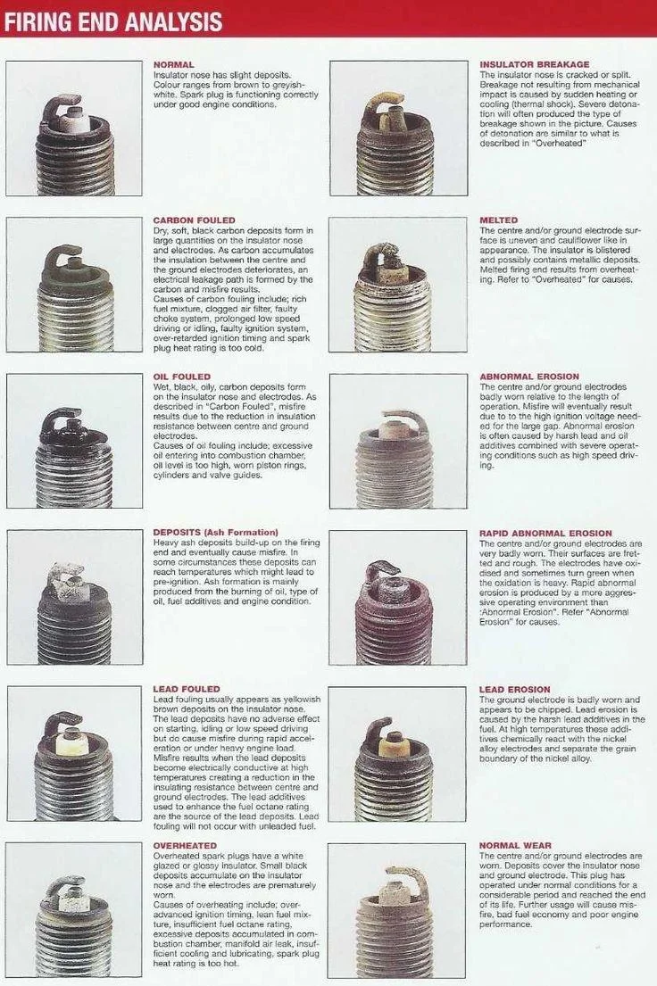

What do the spark plugs look like? If it is starting cold without choke it points to a mixture issue. Do the plugs look like it’s running rich?

like this:
If it’s running rich you should be able to spot it by now.Having said that they've had a few miles now, maybe around 150 since last checked, is that long enough to diagnose anything?
