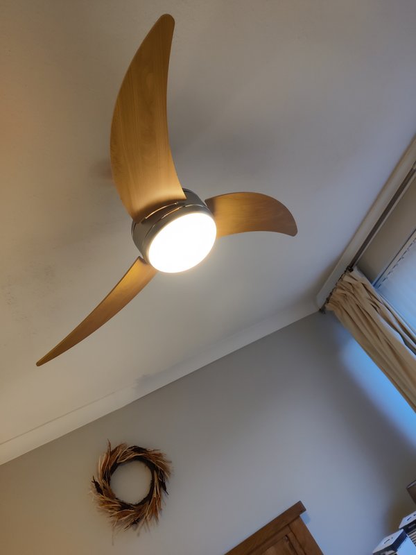

We have one in the living room and it does make a noticable difference sitting underneath/near it. The one we bought is a westinghouse portland ambience in chrome.
I think they’re great for over the beds. The lighting on them is often poor though so may want to consider downlights as well so you can get a fan without.
That looks like a monster that should be on the front of a biplane - 11kg? Do any considerations have to be taken for the ceiling supporting it, with rotational forces too?
If you walk under it and get trapped in the downforce how do you get out? Although I assume that's why it has a remote control :-)
Certainly want to get a fixing into a joist, if they aren't near your wiring then getting up into the loft and adding sone noggins will be best.... although you'll instantly regret that in this heat :cry:

Out of interest, are there any which don't hang as low? I was just looking at this but it's a 40cm drop from the ceiling. Is this just because you need a decent space above for the air to come from or are some a little closer to the ceiling?

Does any fan exist whereby you can keep your existing light fitting, so the fan is installed, then the light fitting can be fitted below it? We'd like to keep our current bedroom ceiling light, but I'm struggling to find anything that allows it so guessing it doesn't exist?
they used to do them, as i have fans in most rooms and the living room one had a plate at the bottom which you unscrewed and fitted a normal rose to with flex to a normal light fitting. its a few years old so worth looking around and asking.

We have three Fantasia Neptune’s they come in white or silver, two fan blade sizes and can be flush fitted. Fitted flush they’re a 30cm drop to the bottom of the light and 17cm from the blades. We’ve used the same company three times now https://www.lightahome.net/eurofans...-remote-control--led-light-115878-58734-p.asp
